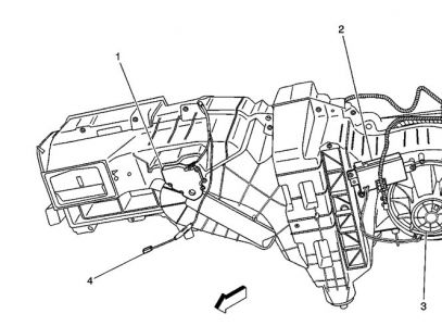

Took blazer to get a/c heat fix. Heat and a/c works but some valve was turned too far and it only blows heat now. If valve is turned the other way it will only blow cold air. Need the valve turned in the middle so both heat and a/c will work, but I do not know where this valve is. He did have a long screwdriver ( about 2 feet in his hand ) when he called me in to check the heat blowing and did say he was not sure how far to turn the valve. Wrote the bill up, " a/c service set programer to heat
Tuesday, July 14th, 2020 AT 11:18 AM (Merged)
HMAC300
  • 48,600 POSTS
There are a couple of actuators on the heater/ac unit. one of them isn't working. they are either electric or vacuumif they are electric you have to check to see if they are getting powr. here is a picture that will be similar to your truck. theya re under the dash.
