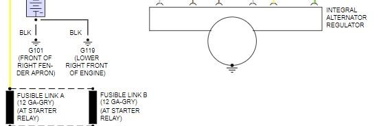

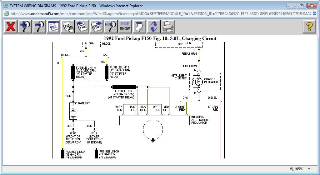

Hi again. If the alternator and battery are good, I would start checking grounds. A weak ground could be an issue. Also, confirm that the fusible link is in good condition and making good connection. I have attached a wiring schematic for your vehicle. Take a look at it and let me know if this helps.
Note: I had to get two pictures for the entire schematic. Sorry about that.

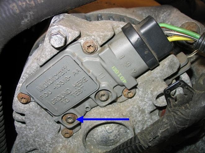

Most commonly you will find the brushes are worn. Those come as part of a new voltage regulator. The regulator can be replaced separately by removing the four bolts in the four corners of the regulator. The new one will come with a toothpick in the hole just to the right of my blue arrow. Leave that in place while you bolt the new regulator to the generator. Once finished, the last step is to slide out that toothpick. You'll hear two faint clicks as the new brushes snap into place.

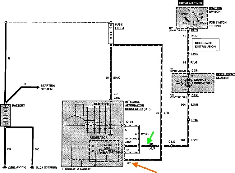

SATURNTECH9
  • CAR REPAIR CONTRIBUTOR
  • 30,869 POSTS

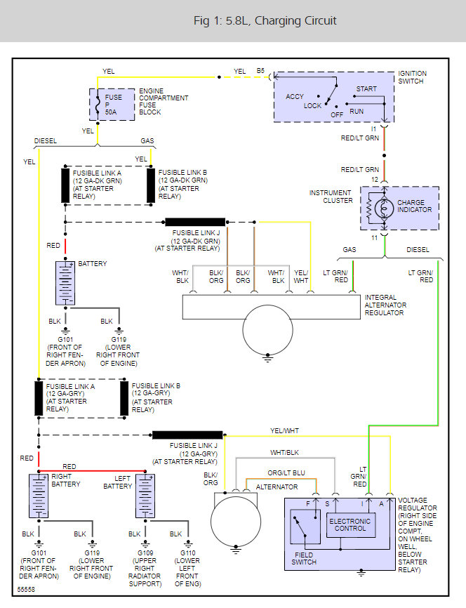

Yes the wiring needs to be tested the green and red wire goes over to the voltage regulator. Here is a couple guides that will help you get the problem fixed. The voltage regulators are separate on this truck on some models.
and
Here is a wiring diagram (below)
Cheers

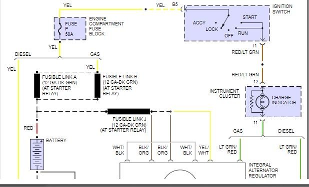

I posted the wire diagram for the alternator there are 3 power inputs coming into the alternator from a fuseable link.See if you have those three power inputs into the alternator.

OK this has been one crazy ride. I figured the problem out and even the ford tec at the plant could not understand what would cause the problem. If you look at the diagram you will see dash indicator light look real close and you will see it is fussed if this fuss blows it cuts out the charging system all together. I understand that most new cars our running this same system , if you have a dash light indicator and it goes out it will not send the signal to the alternator to charge and the simple way to check it is turn on your ignition switch and if the light does not come on and the alternator does not want to charge check it it could the problem. I remember working on a Mercedes Benz truck with the same problem and the repair manuals do not say a word about it after 2 alternators and hours of hair pulling we found the problem the light in the dash indicate r was out. So remember that a lot of new cars our coming out with this set up. Thanks for your help.
