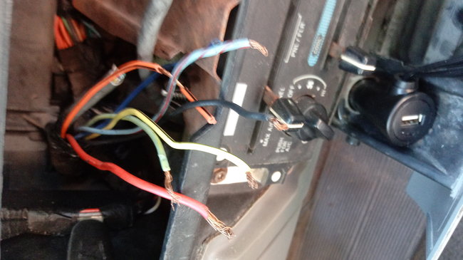

Okay, from my experience constant power is to save memory and data and the ignition wire is supposed to power up the radio when the car is on constant power works fine just popped the fuse but it will turn the ignition but the ignition twelve volt wire coming out of the dash is not getting any power. I checked the fuse and there is no power to the fuse. If I had light I would take a picture but it is really dark, but sum it up the wire only gets power when I turn the key (which it will turn the key wire does not get any power). I do not have the factory harness it was torn off by old owner, I am hard wiring it.

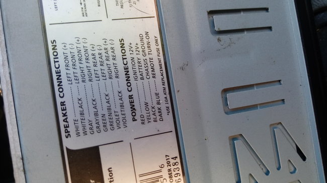

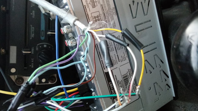

KADEN CLARK
  • 12 POSTS
Hey, I took some pictures of the wires and the radio. None of the wires have power now. Hopefully by seeing the pictures it would help you out helping me figure it out.
Friday, November 27th, 2020 AT 4:57 PM (Merged)
KADEN CLARK
  • 12 POSTS
Here are the pictures.
CARADIODOC
  • 34,468 POSTS
You are overlooking something very basic. You have to have 12 volts all the time on the light green/yellow wire, and there must be 12 volts on the yellow/black when the ignition switch is on. If the interior lights work, the light green/yellow circuit has to be okay. If you are finding 0 volts all over, check what you're using for ground for your meter or test light. On a lot of Ford products you will see a metal bar running along the bottom of the dash assembly, but that bar does not actually bolt to the body, so it cannot be used for any ground circuits.

KADEN CLARK
  • 12 POSTS
Hey, what wires coordinate with the speakers? I got everything resolved, but I got the speakers wires wrong. I tried the diagram but does not show which color.
CARADIODOC
  • 34,468 POSTS
Sorry that the diagrams reproduced too small to read.
Left front speaker is orange/light green and light blue/white.
Left rear is pink/light green and tan/yellow.
Right front is white/light green and dark green/orange.
Right rear is orange/red and black/white.
