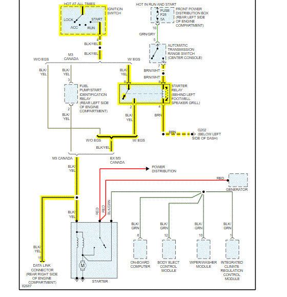

My car broke down on a dirt road up in the mountains, it wouldn't start again even after resting for a while. My gas was 3/4 full, battery is new the car would crank but not start. When I turned the key all the dash lights came on like they should as well did all the gauges. There was no check engine light showing and no code displayed on the computer so I tried starting again. It turned over but would not start and when I let go of the key there was a fast clicking noise under the dash and all the gauges were going crazy so I turned the key off locked my car up and started my 10 mile walk home. The next day I got a ride back to my car it was still doing the same things. I'm a 56 year old gal that's partially disabled there's no way I could push the car by myself so I did the worst thing possible, I used the starter to crank the motor and turned my car around. Stupid yes it was and yes it fried my starter. The car was towed to a friends barn where it sat for a year while I tried to get help for it. I bought a new starter and had it installed and put the car back together. Checked all fluids, put another new battery in, turned the key all lights and gauges worked fine but starter wasn't engaging. I tried again a few days later this time all there was is a weird sound coming from the starter that sounded like electrical possibly? I don't know what to do, i'm scared that I have hurt my car and can't afford the repairs it needs now.

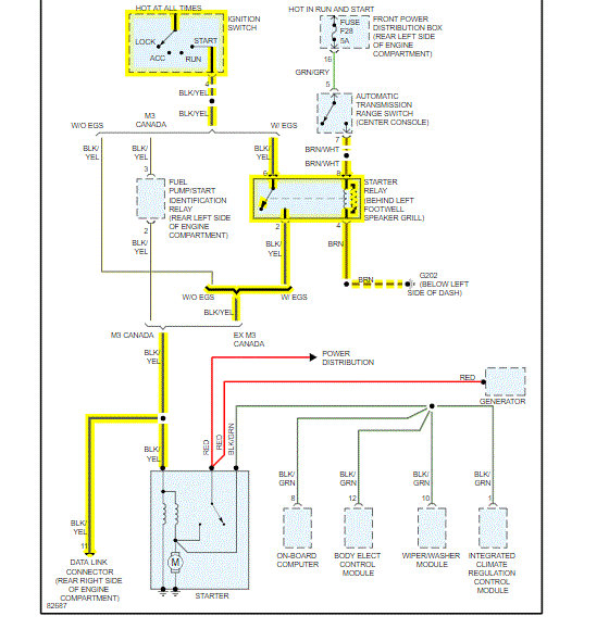

Good morning,

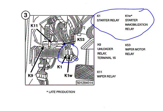

I attached a wiring diagram of the starter system for you.
If you have a test light or voltmeter, we can do some checks to see why it will not start.
Let me know when you are ready to do some testing.

You will need to go to the relay and remove it. Then turn the key to the on position.
You should have one terminal that has power.
Then turn the key to the start position. You should have a second terminal with power.
Saturday, September 12th, 2020 AT 5:13 AM
ITSMEJOJO98
  • 8 POSTS
Hi Roy, my friend removed the relay and tested it like you said. The relay works it's good. What should we do next?
Friday, September 18th, 2020 AT 1:27 PM
Okay, do you have 2 powers at the relay with the key on?
It may click but not send power to the starter.
If you do, then go to the starter itself and test for power from the relay to the solenoid.
If you do not, make sure the fuse F28 has power on both sides.

Roy,
There is power from the relay to the solenoid.
Saturday, September 26th, 2020 AT 6:24 PM
If you have power from the relay to the solenoid, you need a starter motor.

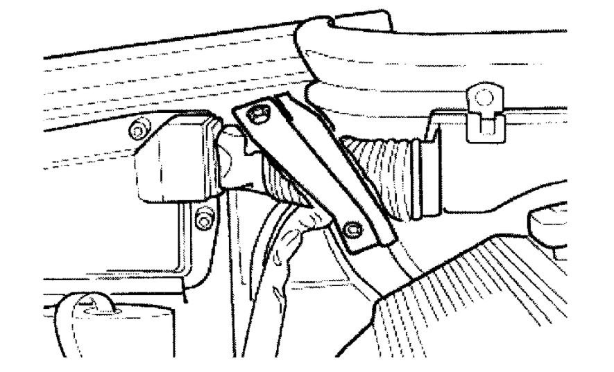

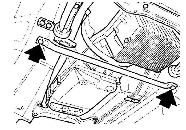

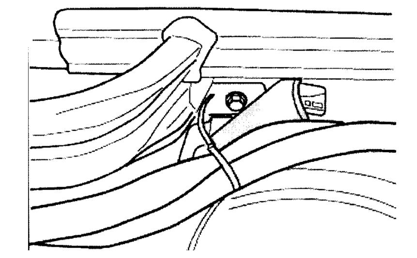

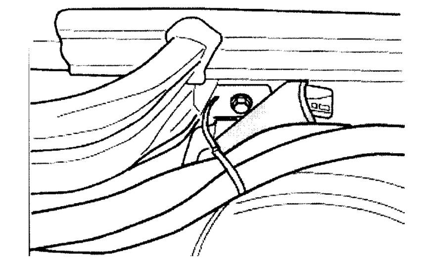

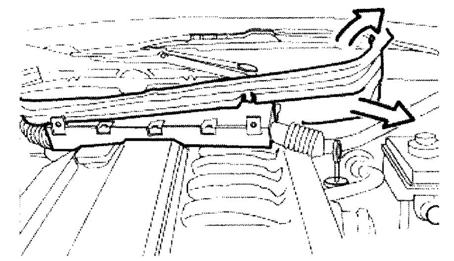

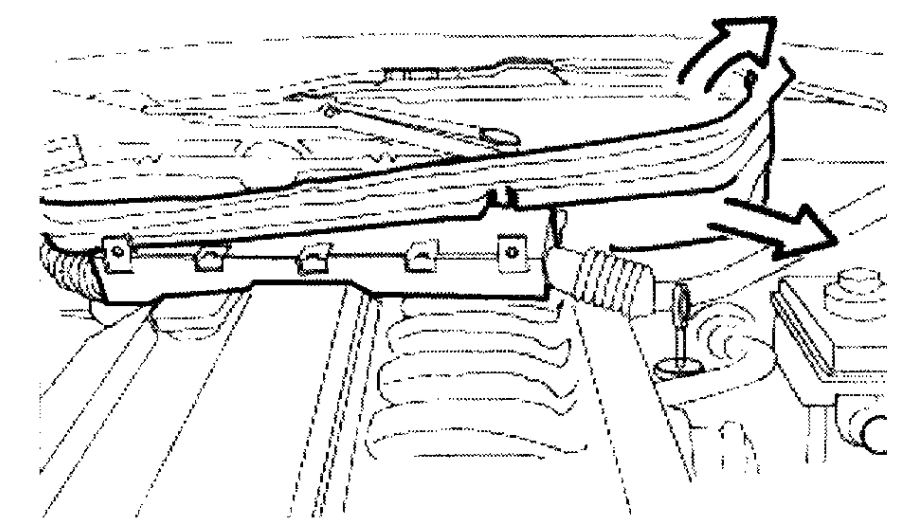

I have a question. We had to take apart almost the entire top end of the engine to get the starter out of my car, isn't there an easier way to do this?
Wednesday, September 30th, 2020 AT 7:30 PM
Okay, no, there is no easy way.
It pays 5 hours in a shop to perform this operation.
I posted the procedure below for you.

Remove grill from air inlet on heater.
ImageOpen In New TabZoom/Print

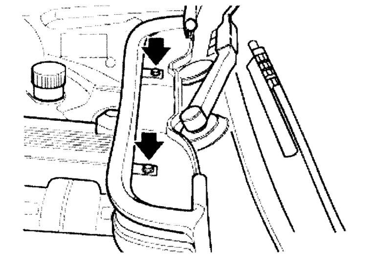

Unfasten screws in air manifold box.
Unfasten screw of air manifold box.
Unscrew screws of air manifold box.

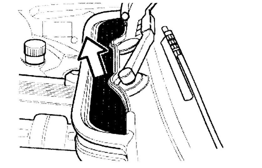

Pull out air manifold box.
Loosen the screws, remove the reinforcing pipe.

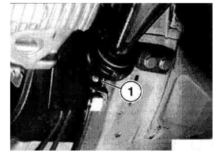

Remove cover (1) from fuel lines.

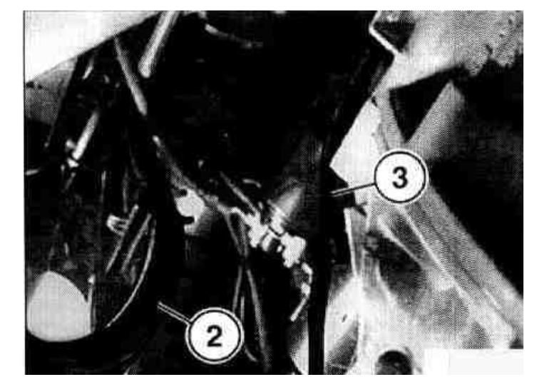

Unclip fuel lines (2) and line for reversing light (3) from bracket.

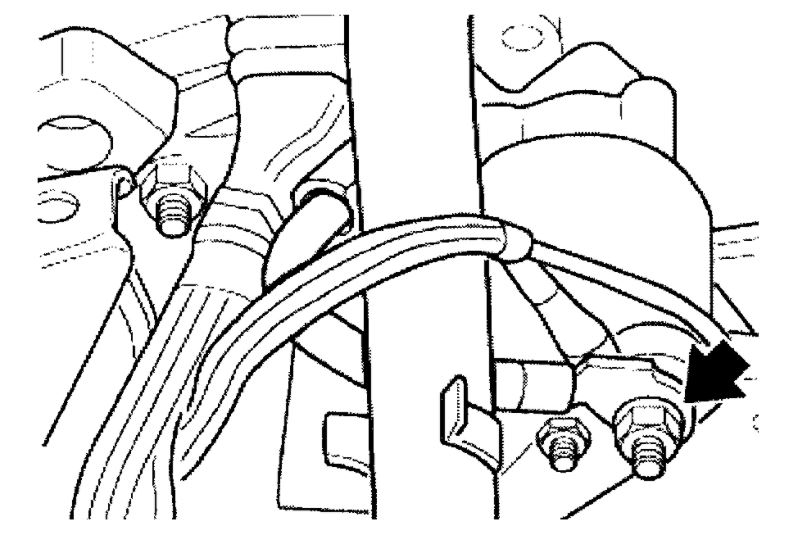

Unfasten nuts and remove cable.
