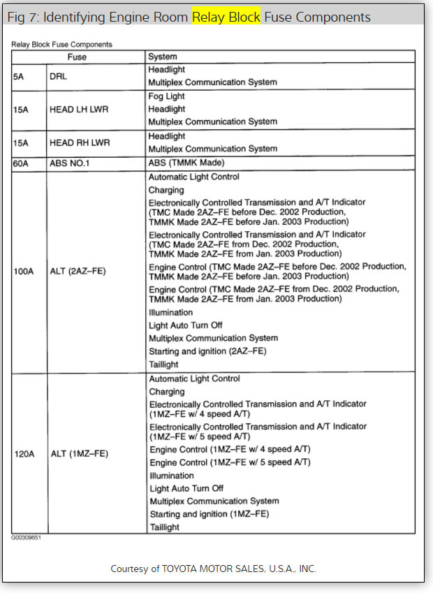

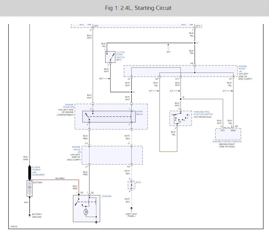

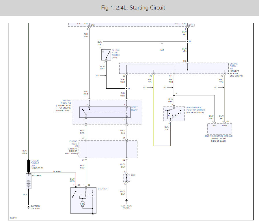

The burning smell has me concerned. I need you to confirm something for me. I need to confirm that the starter is getting the correct power. On the starter, there is a large wire that comes straight from the battery. It always has 12v. There is a smaller wire that only gets 12v when the key is in the start position. I need you to confirm that both of those things are happening.
Monday, May 17th, 2021 AT 6:46 PM
KEN L
  • MASTER CERTIFIED MECHANIC
  • 55,512 POSTS

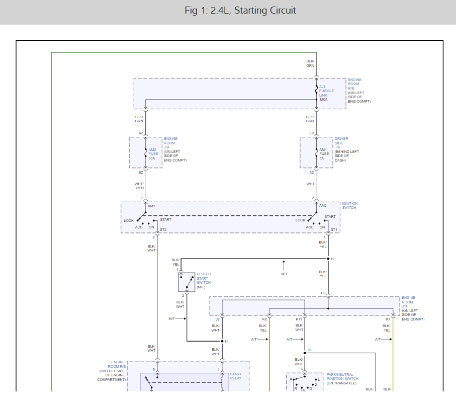

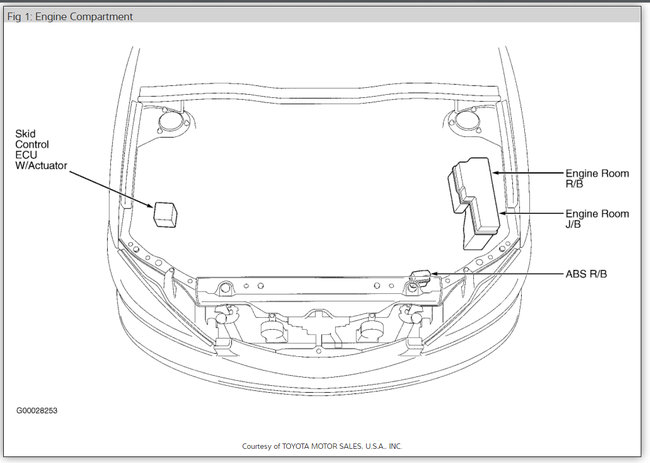

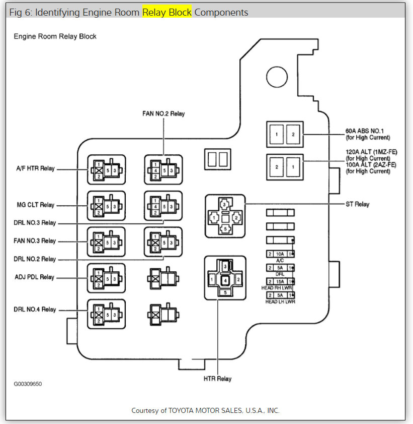

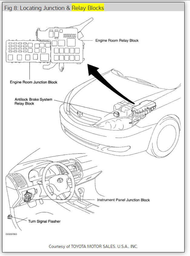

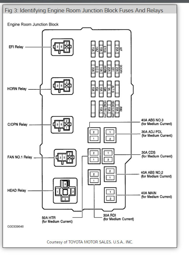

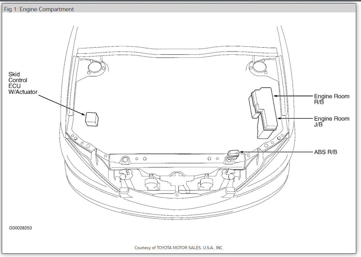

It sounds like the starter relay (ST relay) is not working correctly. here is a guide to help check it with the starter wiring diagrams so you can see how the system works and the relay location as well:
