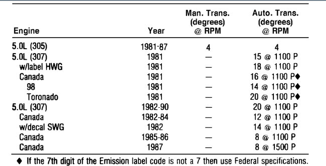

How do you set the timing?
Monday, September 7th, 2020 AT 9:38 AM
As I stated back a few posts, you need a timing light to read the location of the distributor.
Did you get the timing light?
I attached the procedure below for you.
Set timing at low idle and Before Top Dead Center, unless otherwise specified. Disconnect and plug distributor vacuum line, as equipped, at distributor.
1982-86 1.8L (112) FI, 2.5L (151), 4.3L (260), 5.0L (307) engines, ground diagnostic connector.
1982-86 2.0L (122) FI, 2.8L (173) FI, disconnect EST bypass connector (single connector, tan/black wire).
1981-90 all others W/carburetor, disconnect 4-wire connector at distributor.
Timing MUST be set to specifications on emission label, if different from setting listed. If Check Engine" light comes on during procedure, remove ECM fuse to clear.
Monday, September 7th, 2020 AT 9:43 AM

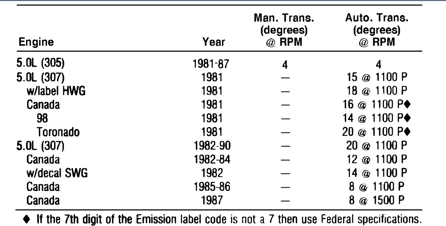

Do you have a timing light to check the timing?
I posted the procedure for setting the timing and specs are attached.
1981-90 all others with carburetor, disconnect 4-wire connector at distributor.
Sunday, November 22nd, 2020 AT 6:07 PM
RJANDIANNA
  • 33 POSTS
Hello there boss, how is it going? So they say they did the timing right. The car start with no problem beside the little cold start. So do you think that my carburetor is bad and that's why it hesitate and putts while I'm trying to take off? It eventually picks up speed but when I come to a stop and try to take off it moves real real slow, putts then gradually picks up speed again. What do you think this is?
Thursday, December 17th, 2020 AT 7:16 AM
Definitely. It sounds like either a rebuild or replacement for the carburetor.
