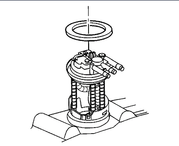

Fuel pump is working an active. No fuel getting to the injectors through the fuel line by testing the release valve for the fuel pressure.

It sounds like there is not fuel to the rail from your description. If that is the case and the pump is running, either you are out of fuel or the pump is no good.
https://www.2carpros.com/articles/how-to-replace-an-electric-fuel-pump
The pump can run but not produce pressure. You need to test the actual pressure. You can rent a tester at a parts store.
