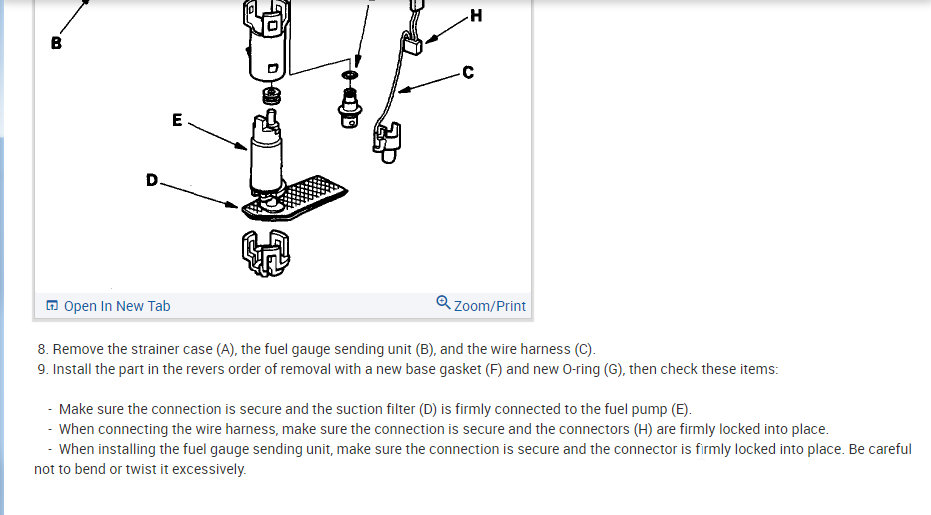

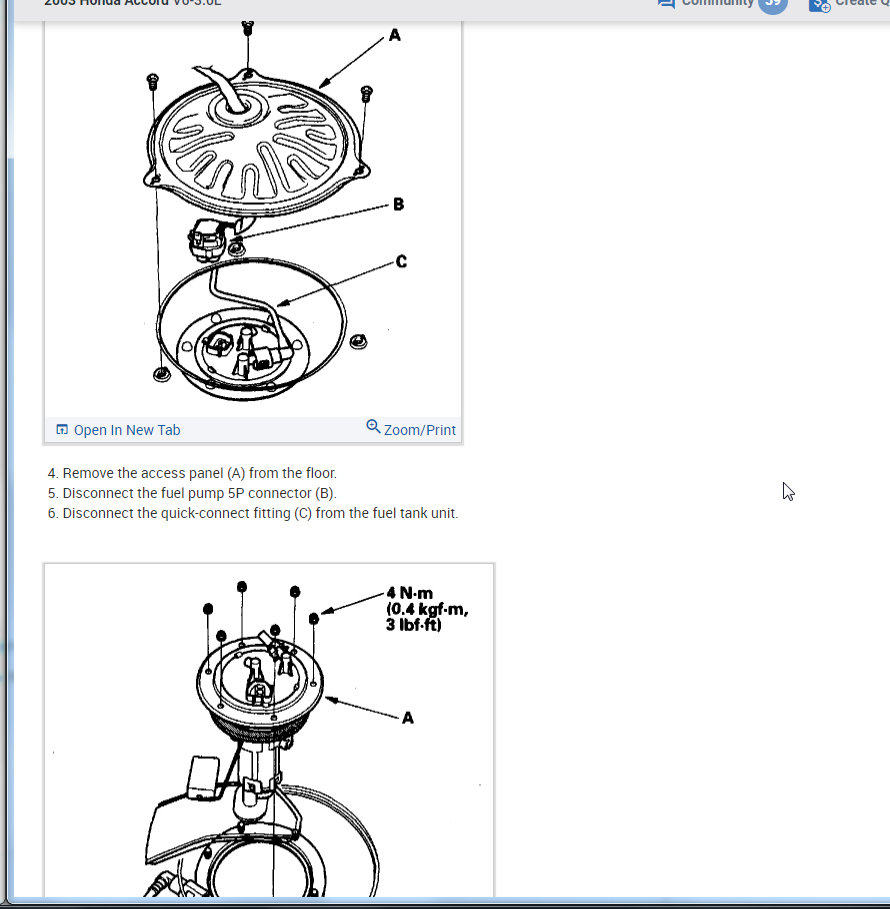

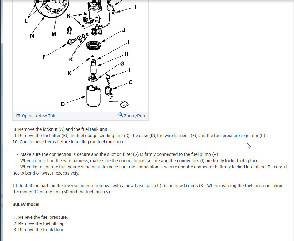

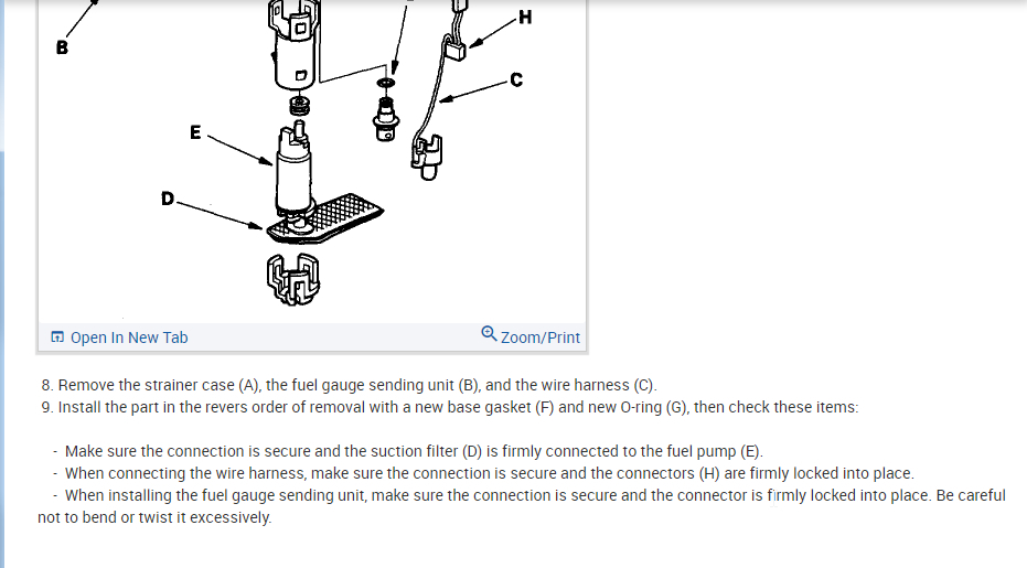

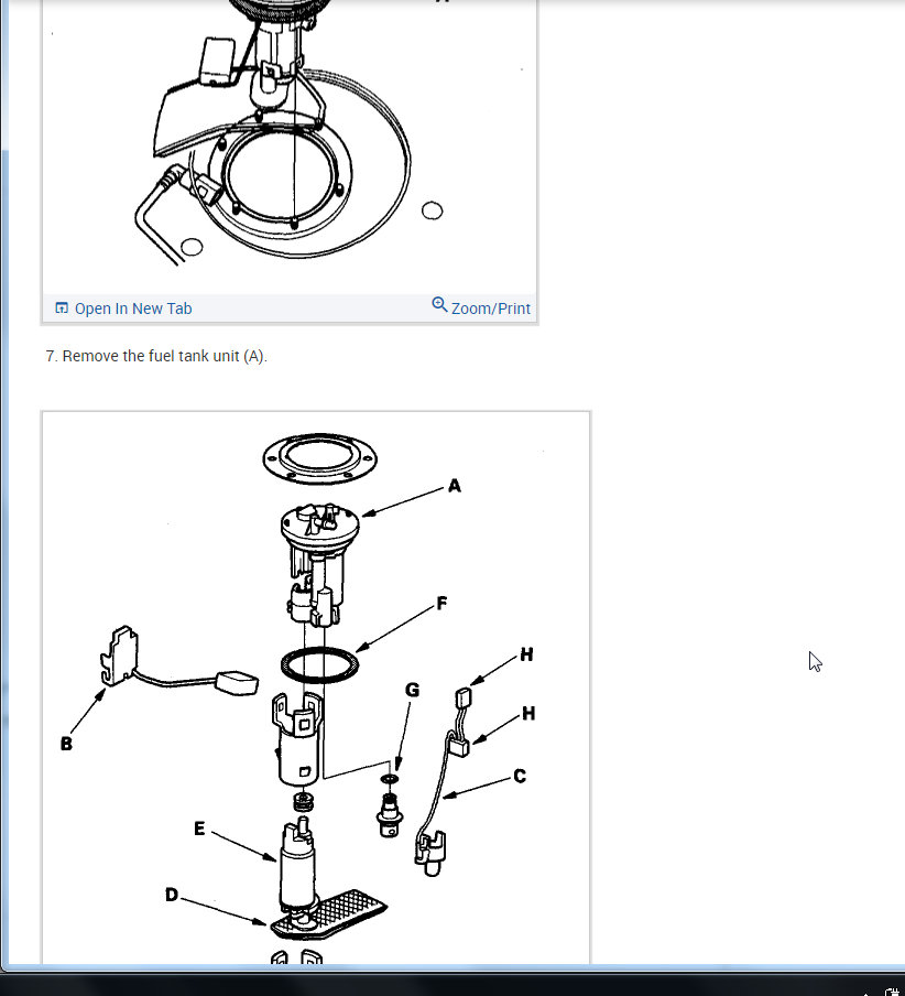

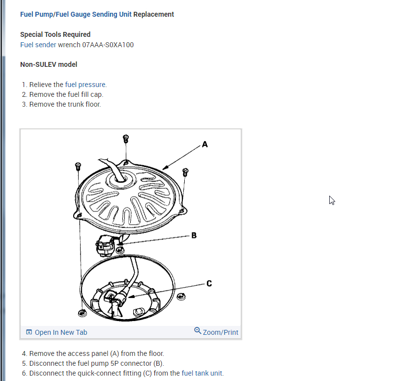

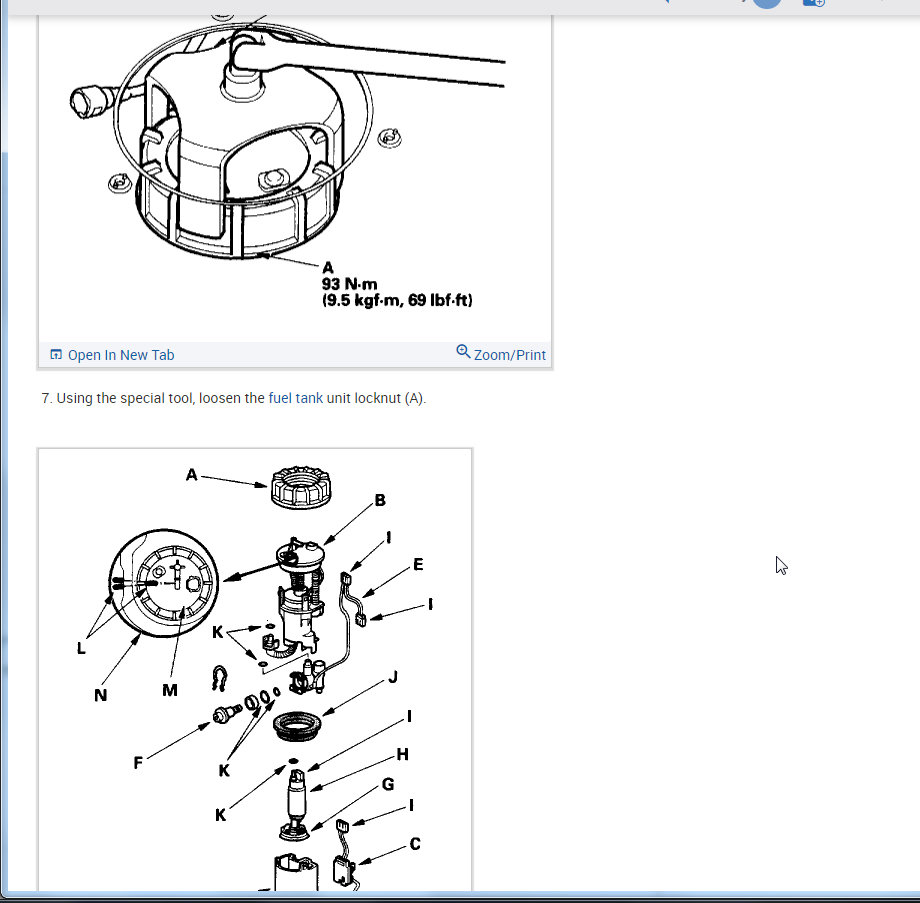

We need to start where this sounds like the issue is and that is with the fuel pump. Two reasons, new parts are not always good parts, and the fact that you have an issue with the fuel gauge that wasn't there before. The level sensor is in the tank on the pump so I suspect we have a faulty new pump. Here are some guides that will help with figuring this out:
If this shows low pressure when this is happening again, then we will most likely need to replace the pump again.
I attached the process from the manual below on how to replace this in the event you or someone else viewing this page needs it.
Let us know what you find. Thanks

Thank you for your response. Very helpful. We suspected the new pump could be faulty. My husband will check this out and I will update after.

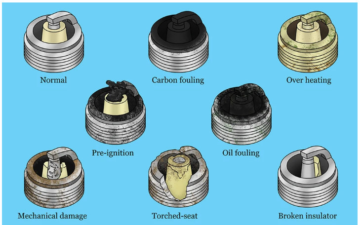

If it still does not start, pull the plugs and make sure they are not fouled. Here is a guide below that shows what plugs look like when they fail.
Let us know all this info and we can go from there. Thanks
