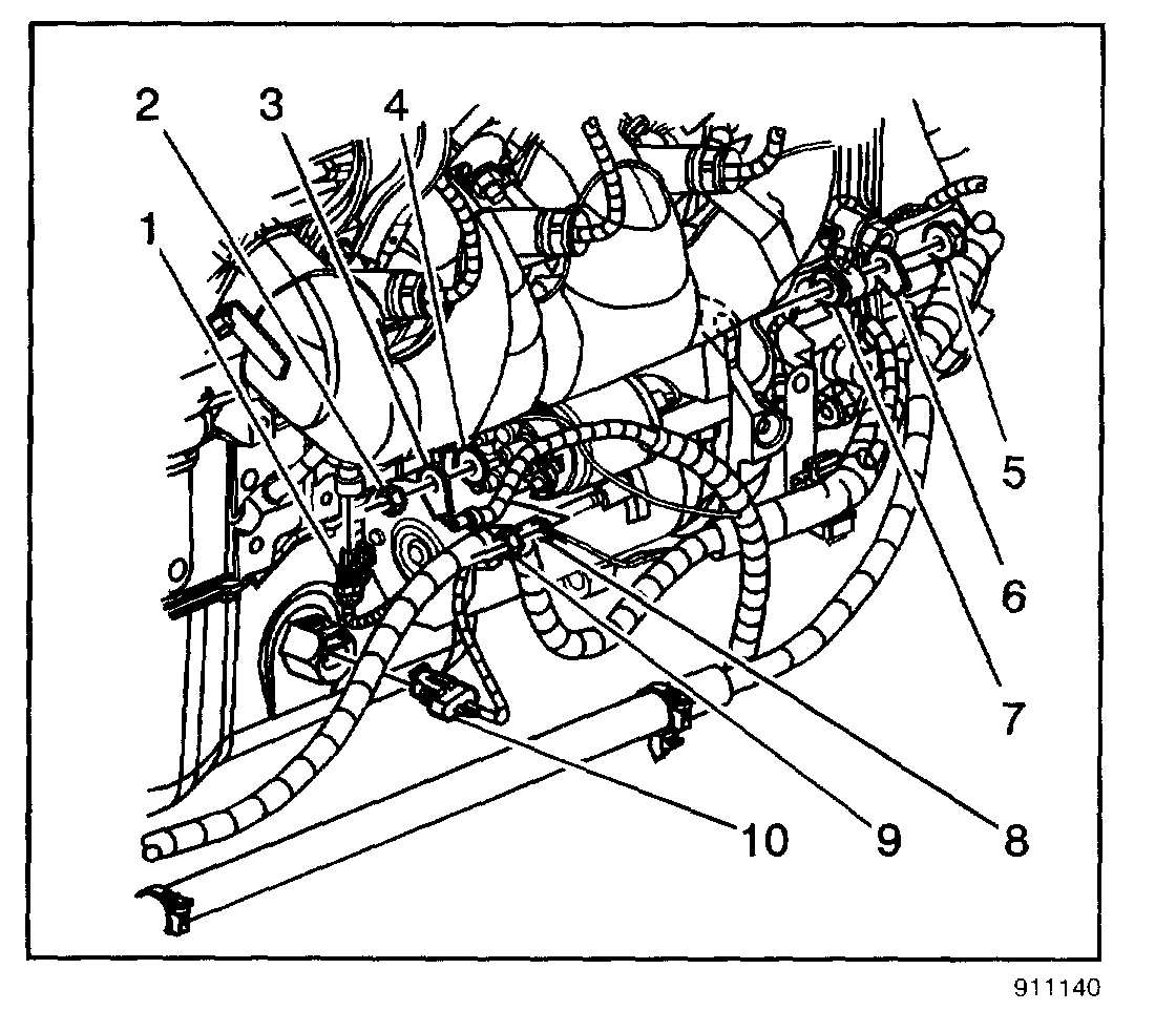

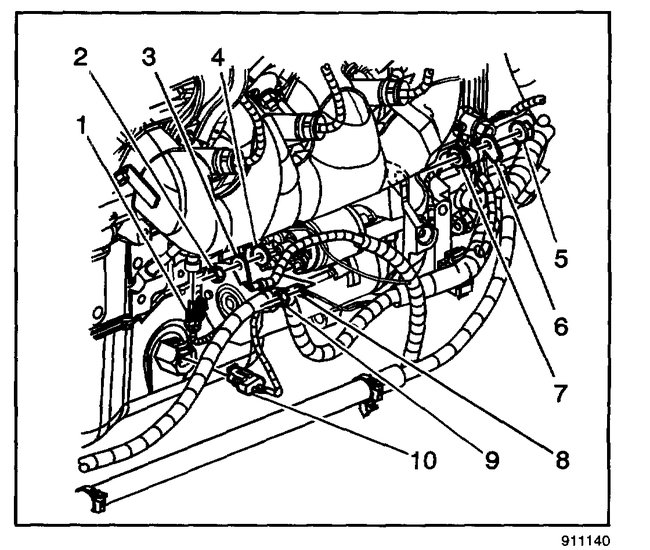

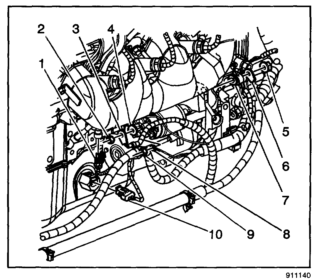

Brought the car off someone they said they haven’t driven it in months. The car won’t even crank over. No lights light up on the dash. When trying to jump start it it makes a whining sound and the lights pop up, but it still doesn’t crank or come on.
Friday, March 1st, 2019 AT 3:58 PM
  • 110,194 POSTS
When you say it is whining, does it sound like an electric motor spinning? If it does, it sounds like the starter Bendix is bad. Also, what lights pop up?
If it does sound like an electric motor, I would recommend disconnecting the battery, removing the starter, and having it bench tested. Most parts stores will do it for free.

STARTER MOTOR REPLACEMENT
REMOVAL PROCEDURE
picture 1
1. Disconnect the negative battery cable.
2. Raise and support the vehicle. Refer to Vehicle Lifting.
3. Remove the front lower air deflector panel.
4. Remove the torque converter covers.
5. Remove the starter solenoid S terminal nut (9) and remove the starter solenoid wire (8) from the starter motor.
6. Remove the starter solenoid BAT terminal nut (2) and remove the positive battery cable (3) from the starter motor.
picture 2

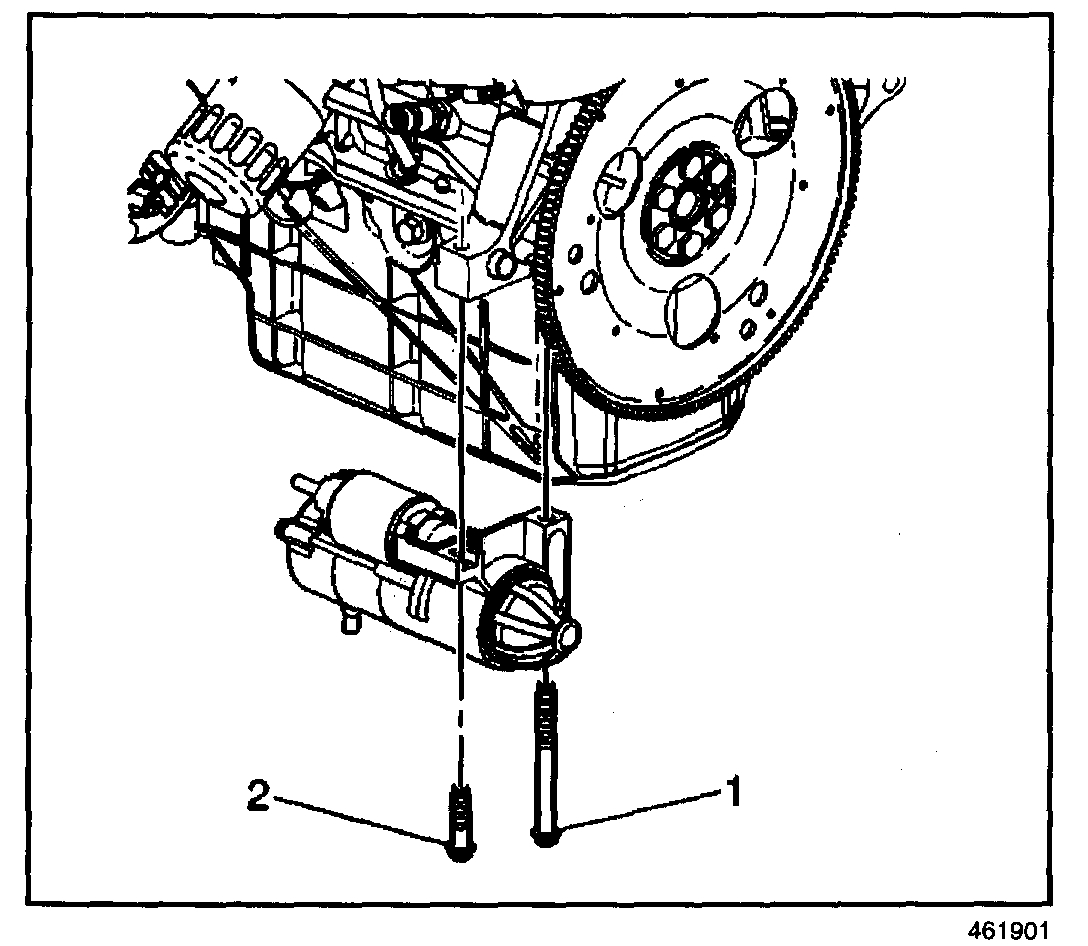

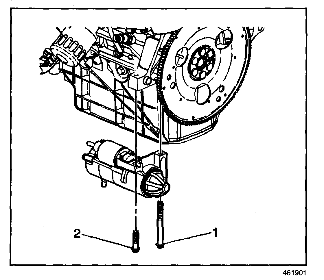

7. Remove the starter bolts (1,2) and the starter motor.
INSTALLATION PROCEDURE
picture 3
1. Align the starter motor to the engine.
NOTE: Refer to Fastener Notice in Service Precautions.
2. Install the starter bolts (1,2) finger tight until seated.
Tighten
Tighten the starter bolts to 43 N.m (32 lb ft).
