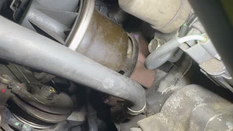

I don't have any codes. Can I test the EGR valve with a smoke machine?
This EGR valve is a harness connection, not a vacuum.

This is an EGR valve. There was smoke coming out when I did a smoke test with a smoke machine.

Probably the code P1399, got cleared because I disconnected the ground terminal when I changed the distributor cap and the spark plug wires.
Friday, December 26th, 2025 AT 8:33 PM
KEN L
  • MASTER CERTIFIED MECHANIC
  • 55,488 POSTS
Yep, that valve is leaking good find. Yes, some codes will reset when the battery is disconnected.

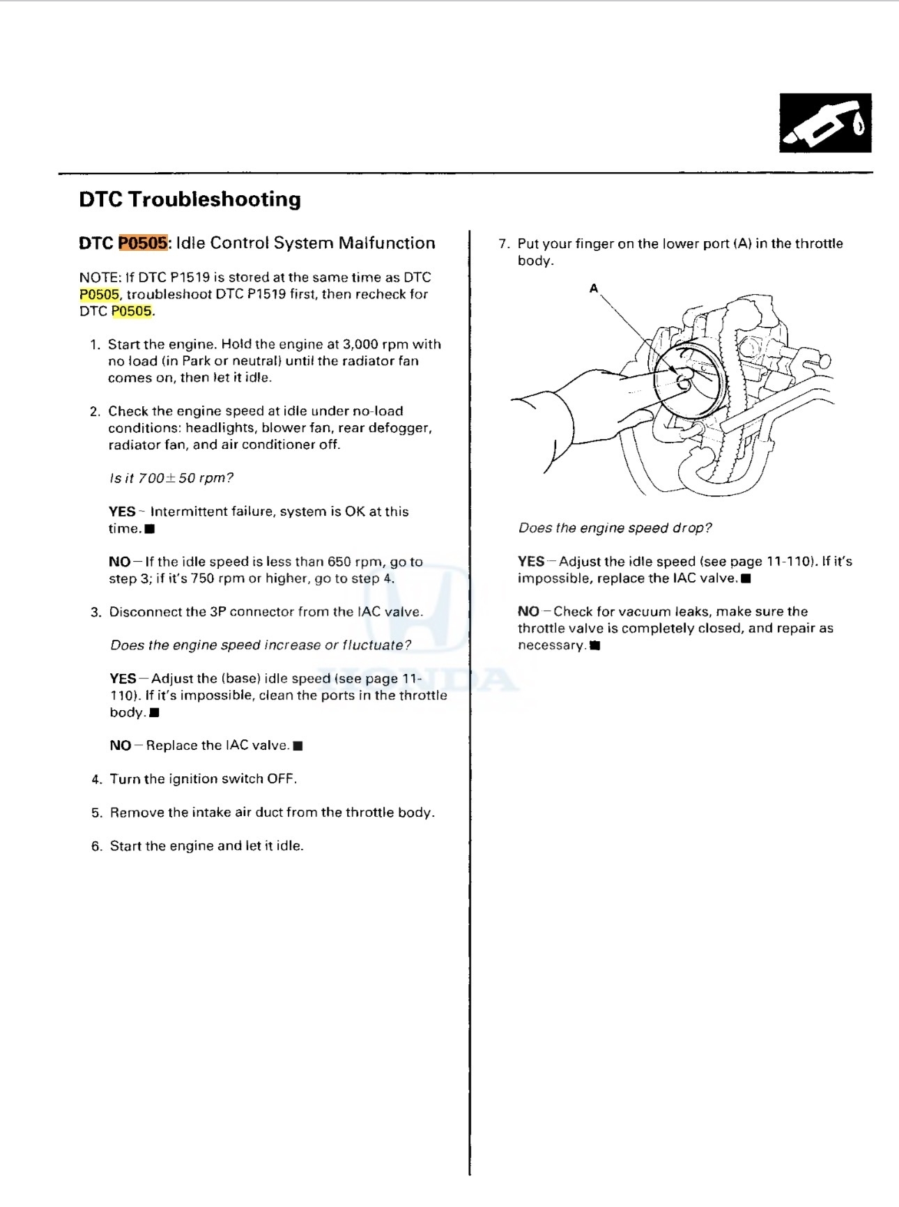

**Ignore the last reply. I was going to delete the last reply, but I couldn't.
So I put the new IAC valve, the car started at about 1k RPM, ( the old one was 2k RPM, then dropping to 750 RPM). The car lost coolant, so I added I was burping the coolant while the car was running. But the car, before reaching the operating temperature, the fan did not kick on, and the engine stalled. The car did not start again.
Do you think the new IAC is bad?
*I checked the brake booster when I disconnected the line, the vacuum escaped from the booster.

That is a good sign the booster is okay. Listing to the video again it seems like the engine still has a vacuum leak. Please go over this video and guide to help us fix the problem.
and
https://www.youtube.com/watch?v=LRKWV4Are5c
Please go over these guides and get back to us.

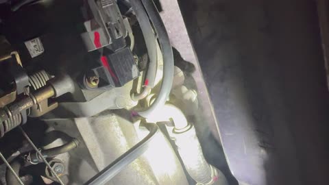

After replacing the IAC valve check the engine light came on (P1519 and P0505). I held the RPM at 3000 according to the service manual for a couple of minutes and the engine stalled, then I tried to start again, but it didn't start, my second attempt I had to press the gas pedal to help the car to start, and the car started for a minute or so then stalled, I tried to start again but it didn't start.
I did a smoke test ( key OFF, engine OFF)looks like there is a leak coming from the IAC valve connector.
Thursday, February 19th, 2026 AT 7:20 PM

IAC valve leaking
*Can I smoke test the intake with the key ON and the engine OFF?
Thursday, February 19th, 2026 AT 7:22 PM
KEN L
  • 55,488 POSTS
Wow, that is the problem you have a massive vacuum leak, It may be leaking below the IAC like a PCV hose, I would use a small mirror and flash light to pin point the leak, this is the source of the issue. Thanks for the video it helps, let me know what you find. Ken
