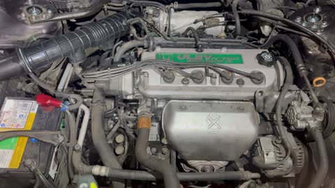

Hi everyone,
I have a Honda accord lx 1999.
the car hard to start and keeps shut off after a minute or so, and when i put load the car shuts off instantly, the engine runs rough and shaking, but when drive it won’t turn off.
no check engine light.
month ago I had a check engine light, and turn signal was working,
codes: P1298, and P0700,
I get the turn signal fixed by reset clock/ECM fuse. Also I changed ELD because I had a stored code p1298. It could be the issue related.

Since you already replaced the ELD I would check the main ground from the battery to the engine block and the ground to the chassis. These must be in good shape or you will get this code.
CODE: P1298 - ELD (Electric Load Detector) Circuit High Voltage
1. Failing Alternator (low output or shorted stator)
2. Bad Engine Ground / Battery Cable
Here is a guide to help check the alternator charging, also if the battery is more than 4 year old a would get a new one, or at least have it tested at the auto parts store.
and
P0700 almost always appears when:
1. The PCM is losing stable voltage
2. The electrical system is dropping under load
3. Alternator output is low or intermittent
4. Engine grounds are weak
Please go over these guides and get back to us.

The hard to start, but when it starts and runs for a few minutes then shuts off.
Dec 1, 2025 at 10:56 AM
  • 54,494 POSTS
Thanks for the video, I can hear a vacuum leak which will make it run like this, try to follow the hissing noise to find the leak, it sounds like a vacuum hose is off. Here is a video to help you find the leak, you can use carb spray as well.

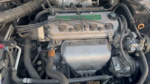

I changed the air intake hose, which had a crack, but still hard to start, right now I have a pending code P1399.
In first video I hear clicking sounds like spark plug.
Any suggestions?

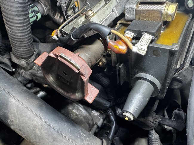

Yep, I hear the ignition system shorting out, also, I have seen the ignition distributor go out and cause this problem as well, I would remove the cap and rotor to look for rust colored dust, if you find it the distributor is bad.
Code P1399 - Random/Multiple Cylinder Misfire.
I would replace the spark plugs, wires, cap and rotor as well. You did see any other vacuum leaks with the smoke machine? Also, I would service the throttle body and IAC motor. These guide can help.

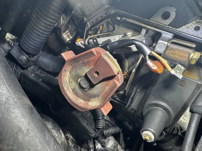

Hi Ken,
So I cleaned the EGR and throttle body. Also, I removed the distributor cap, then I tried to start the car but the car just kept cranking. I plugged in the obd2 scanner no codes even the pending code is gone.
I checked the ignition wire’s resistance,
500ohm,600ohm,700ohm,800ohm
From the shortest wire to the longest.
Dec 14, 2025 at 3:59 PM
  • 54,494 POSTS
Testing the resistance can still miss a bad wire, but I can see the ignition rotor and cap need to be replaced. Also, did the smoke machine show any leaks? Let me know after the rotos and cap replacement. Ken

  • 36 POSTS
I changed the rotor and cap. I started the car, and it started immediately. But the engine was hesitating, then I did a smoke test, and the new hose I installed was leaking and the EGR was leaking as well.

  • 36 POSTS

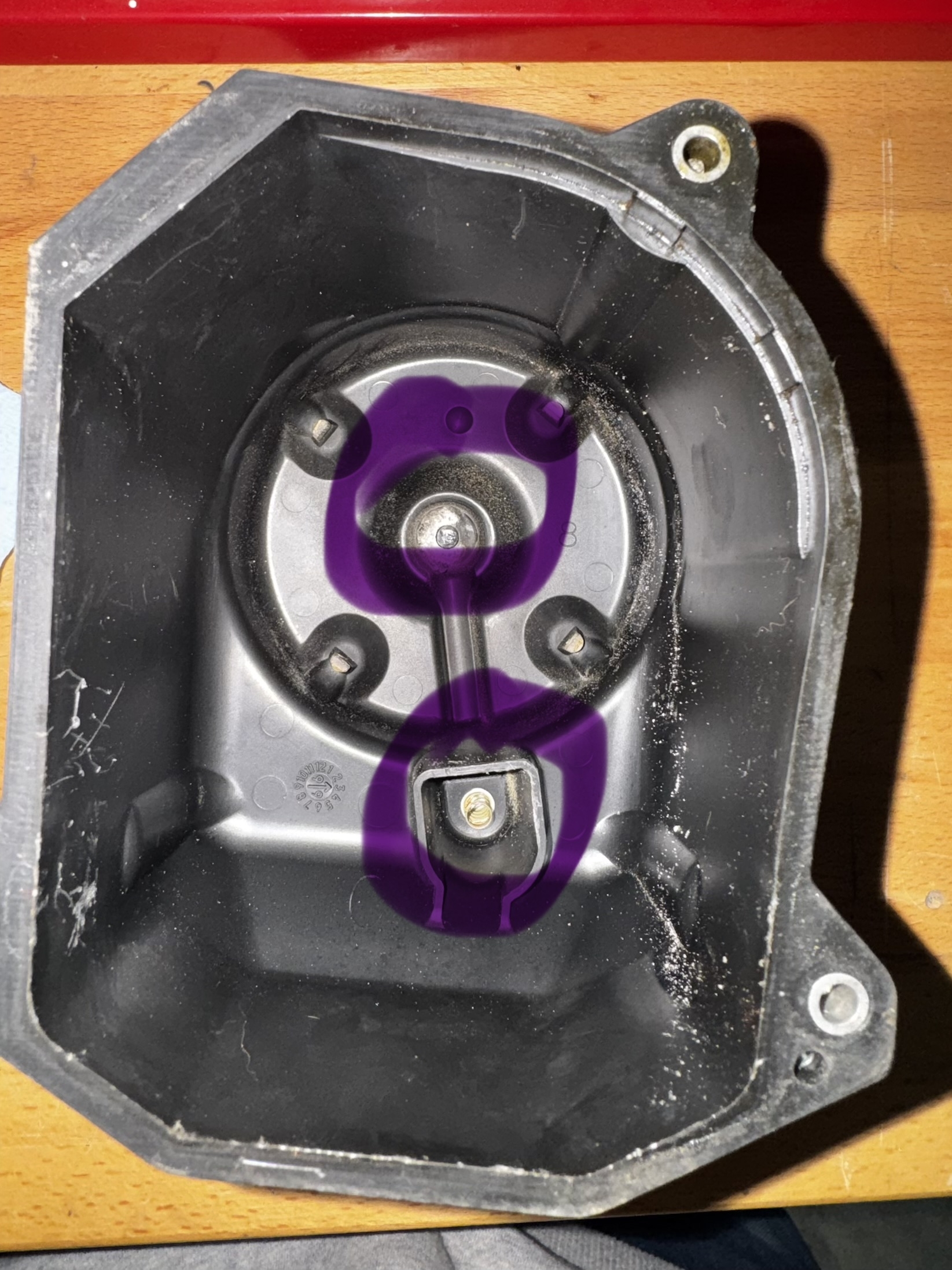

Yes, once I changed the distributor cap and rotor, the car started right away, but the engine sounds like it has a vacuum leak. So I did a smoke test, and the smoke was coming out of the EGR and the new intake hose.
*I am waiting on another intake hose.
**I did not check for DTC.
I believe, the main problem was the distributor cap, does not have continuity between those two points.

  • 54,494 POSTS
Yep, good find, that is a bad cap for sure. I am happy to help you get the car back on the road!

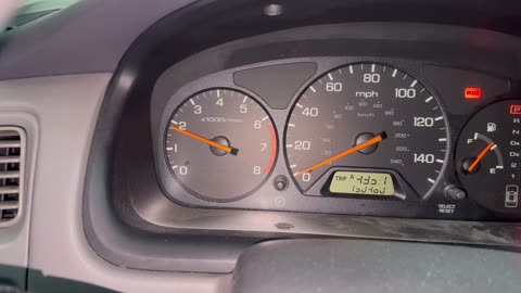

  • 36 POSTS
Hi Ken,
One more question: right now, when the car starts, the RPM is at 2000. Do you think there is still a vacuum leak?
Happy holidays!
Dec 25, 2025 at 3:37 PM
AKORD
  • 36 POSTS
The RPM fluctuates
Dec 25, 2025 at 7:40 PM

  • 54,494 POSTS
I have seen this before, it is strange, I don't think cleaning the IAC motor will fix it but you can try. Did you clear the codes? and if so do you have new codes? IF could be he EGR valve is stuck open, I would remove it and use this video.

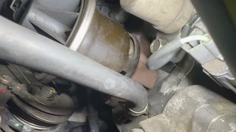

I don't have any codes. Can I test the EGR valve with a smoke machine?
This EGR valve is a harness connection, not a vacuum.
Dec 26, 2025 at 9:40 AM
  • 54,494 POSTS
Yep, try cleaning the IAC valve and yes a smoke machine can help test the EGR.

This is an EGR valve. There was smoke coming out when I did a smoke test with a smoke machine.

Yep, that valve is leaking good find. Yes, some codes will reset when the battery is disconnected.

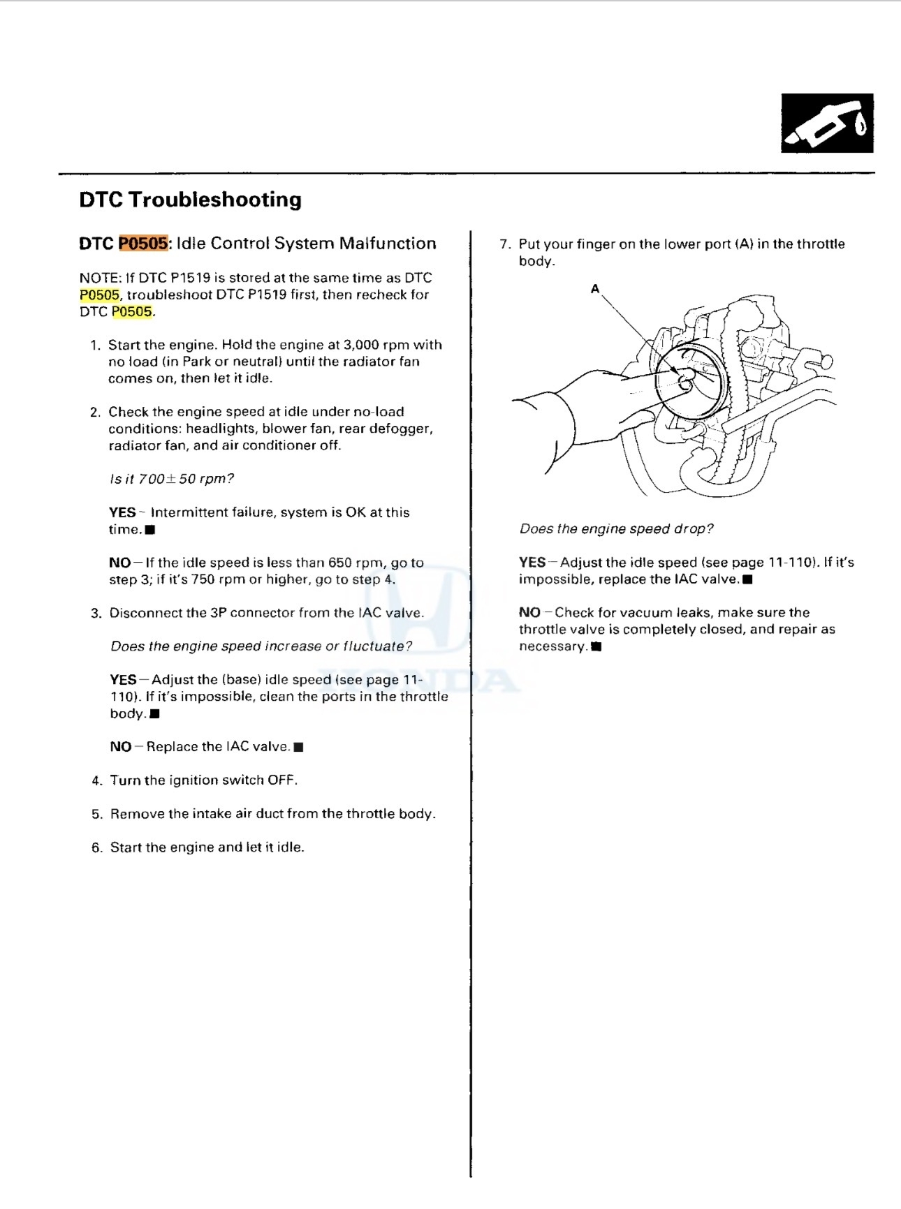

  • 36 POSTS

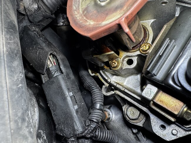

After replacing the IAC valve check the engine light came on (P1519 and P0505). I held the RPM at 3000 according to the service manual for a couple of minutes and the engine stalled, then I tried to start again, but it didn't start, my second attempt I had to press the gas pedal to help the car to start, and the car started for a minute or so then stalled, I tried to start again but it didn't start.
I did a smoke test ( key OFF, engine OFF)looks like there is a leak coming from the IAC valve connector.

AKORD
  • 36 POSTS
IAC valve leaking
*Can I smoke test the intake with the key ON and the engine OFF?
Feb 19, 2026 at 7:22 PM
  • 54,494 POSTS
Wow, that is the problem you have a massive vacuum leak, It may be leaking below the IAC like a PCV hose, I would use a small mirror and flash light to pin point the leak, this is the source of the issue. Thanks for the video it helps, let me know what you find. Ken

I have replaced the IAC valve and the distributor. Ignition coil was not sparking all the time that’s what was causing the not to start.
