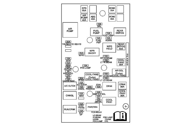

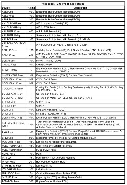

No, the lights come on only if you turn on the headlights using the headlight switch but when applying the foot to the brakes the brake lights do not come on. So the parking lights but not the brake lights.
If the brake lights don't come on, first check fuses. The first one to check is the BCM 2 fuse in the under hood fuse box. I attached a picture of both the fuse box under the hood as well as the legend. (pictures 1 and 2) If you look at picture 1, you will see the BCM 2 fuse on the upper right side of the picture. Locate it in the fuse box on your car and check it.

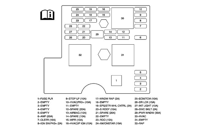

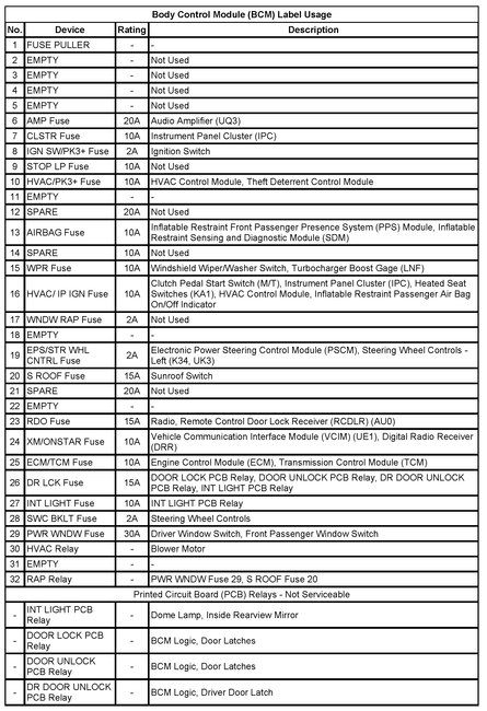

If that fuse is good, check fuses 8 and 9 under the dash. See Picture 3 and 4.

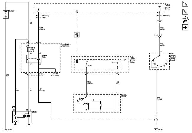

Ran fine yesterday and got in this morning and would not start. all lights and heat and radio still work but does not turn over.

Do you hear anything when you try to start it? Any clicks or sounds? If nothing I would look at the battery connections at both feeds, there is one that feeds the fuse box, if the lights and such are OK that one should be OK. However there is another feed wire to the starter itself from the battery. It could be corroded or even broken. Result = no start.
Also check the Crank fuse and relay in the under hood fuse box. Either one can cause a no crank issue. Verify that the trans is in Park, then move it to neutral and try to start it there as well. That would indicate a bad shift range sensor or connector.

Thank you it was a battery teeminal

Great to hear you found it. Was it the terminal to battery or the cable to clamp area? I have seen those cables fail right at the crimp before.

The terminal.
