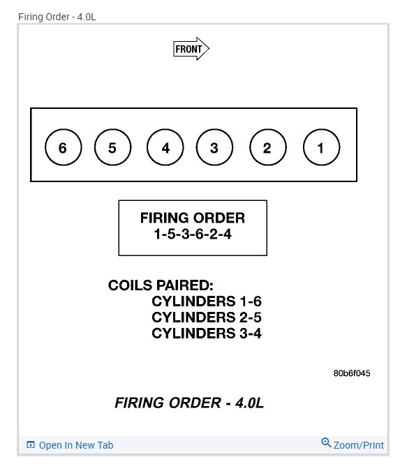

We replaced the cylinders in my car because it said cylinder misfire which would cause the hitching when I drive. The engine light flashes but it still is doing the same thing. The computer is also saying misfire in two of them but the parts are all new. There’s also a coolant leak.
