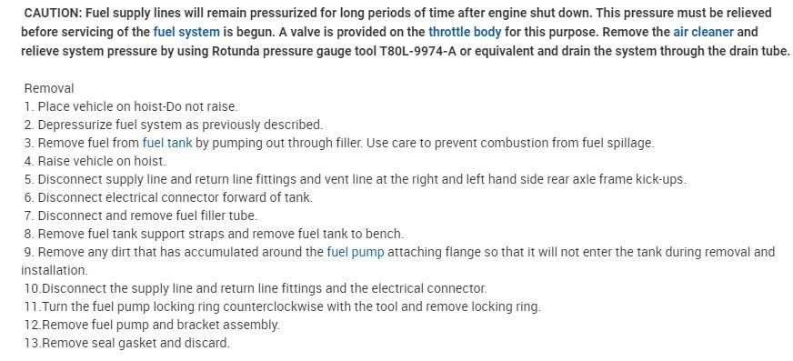

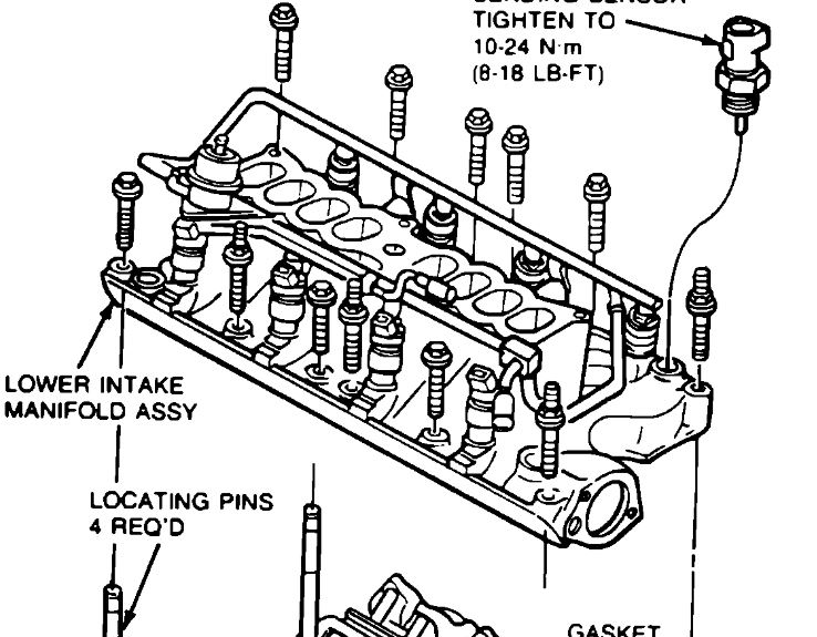

Fuel pump is good. Replaced distributor, coil and spark plugs. Battery good. Starter good. Help me please.

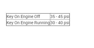

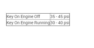

How do you know the fuel pump is good? What is the pressure to the fuel rail?
Did you check for spark at the plugs?
