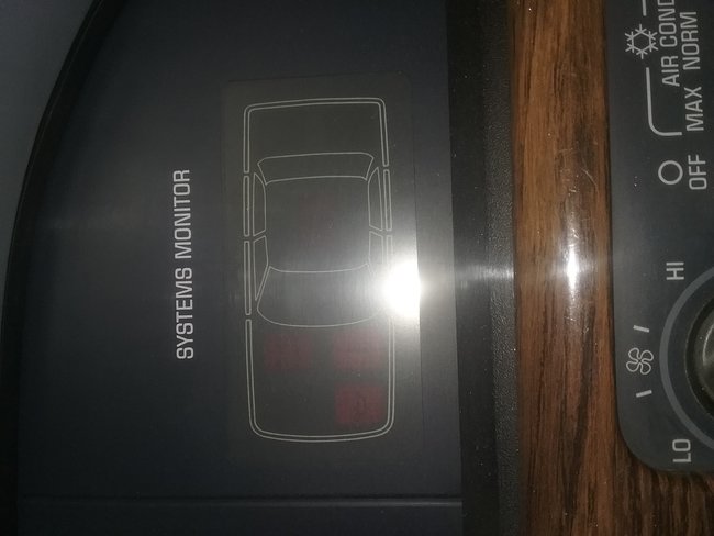

My car doesn't have a check engine light. It does have a system monitor with picture of car in right side of dash for oil, water, battery, etc. If there's a check engine light I've not seen it. I sent a picture of my dash as I don't have check engine light, have systems monitor with oil, battery, water, etc. So can't retrieve trouble codes this way.

Did you check for the OBD port? The vehicle should have one. It was a requirement when the vehicle was made.

Honestly, this is a first. I've never seen one that didn't. Can you upload a picture so I can see what you are dealing with? It would help.

I didn't receive any pictures. However, if you turn the key to the run position, you should see a engine light. It may even say service soon.

There is a service engine soon square on dash unfortunately it doesn't light up or flash. I checked the fuses all looked okay. I have the "car from hell" as I think it's possessed. Maybe I should try exorcism. Lol! The guy at parts store even gave me a code key so I didn't have to use the paper clip. Sorry for wasting your time. I'd push it off a cliff but only have liability insurance.
