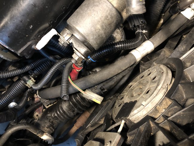

I need to know where the green/red wire with the female end goes, From what I can tell from the length, it either goes to the starter or the fan, but I can’t see the connection. Also, how should I approach the first start of the engine after doing this work. What should I listen for? Should I just let it idle for.. And then drive it, or what? I’ve got my fingers crossed!

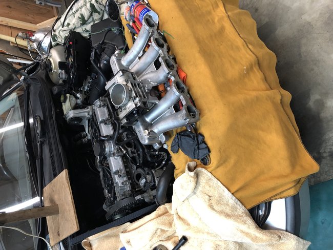

Not looking forward to the dreaded banjo bolt on the intake manifold.

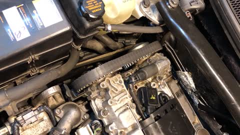

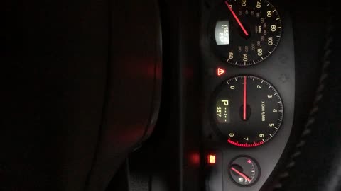

Lack of power and this is a video of the engine idling. Any idea of what could be causing this? Thanks for for excellent advice.
Tuesday, September 17th, 2019 AT 7:30 PM
JIS001
  • 3,412 POSTS
I see the Check Engine light came on. Scan it for codes to give us an idea as to what triggered the light.

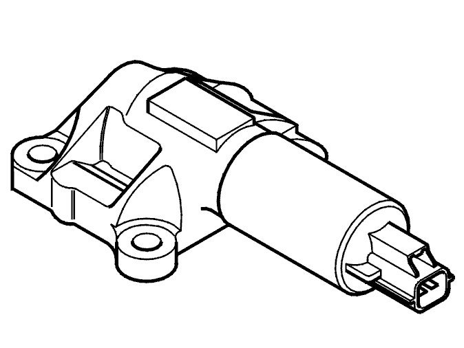

Now to the timing codes. I believe I may have heard some rattling sounds? If there was a rattling/ticking sound then remove the oil control valve. Place some rags around the hole and disable the fuel pump. Have some one turn the key to crank over the engine to see if oil pumps out. Normally when the valve rattles around it is because your really low on oil! If there is oil pumping out then either the solenoid is bad or you did not time your vehicle correctly?

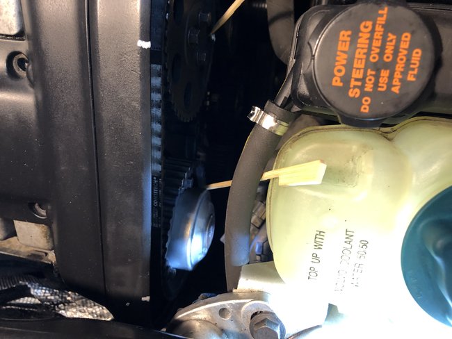

Here’s a video. On cold start - before I took the video - it idled at about 900-1000 RPM for a minute, then started idling rough, like the last video. The picture: my crank marks are lined up but you’ll notice the cam marks are way out. The sticks point at the timing marks on the cams. The timing marks on the cam cover are highlighted in white. Looks like about 180 degrees. I hope I’m wrong.
