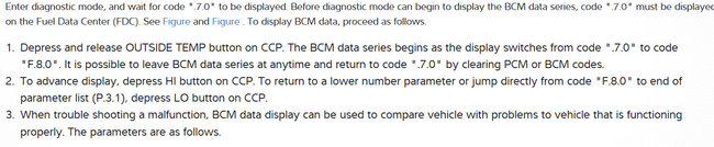

Because you have automatic temperature control do what is listed in picture and get back to us with codes. It will be an F code.

Hmac, I have a lot of codes they are all e26-30-53-70-91-98.
Tuesday, July 21st, 2020 AT 11:07 AM (Merged)
HMAC300
  • 48,601 POSTS
Those are all PCM codes for engine if no codes are coming up with F then you will have to find someone who can read them for you. If engine runs okay and no check engine light is on then these are stored codes so you can disregard them if not get back to me.
