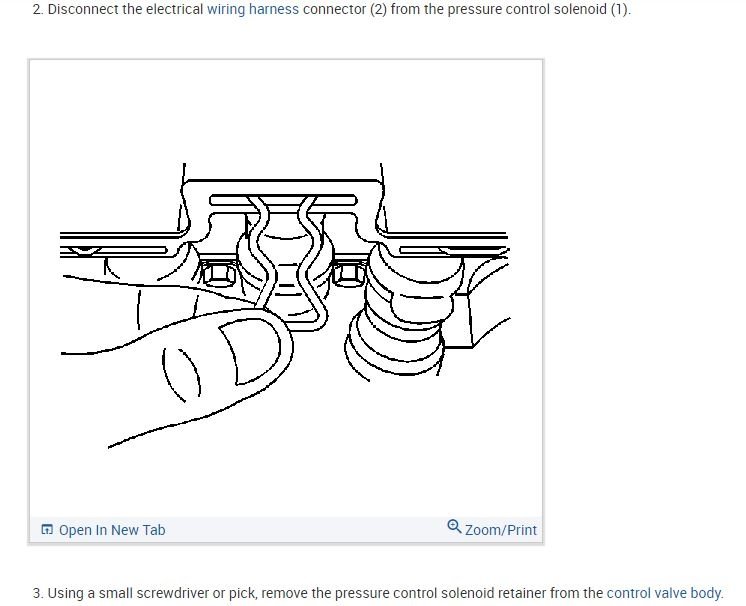

I am not sure which solenoid in my transmission that needs to be replaced. when starting to drive and shift into drive it takes about 45 seconds before it engages into drive gear. I also have no fifth gear, cannot take it over 55 mph. Any ideas?
Mar 31, 2021 at 9:42 AM (Merged)

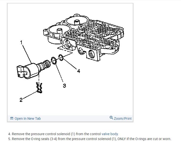

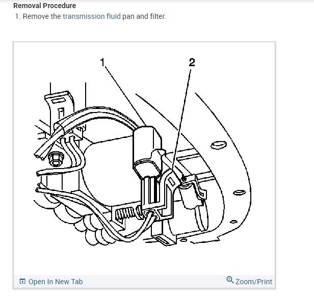

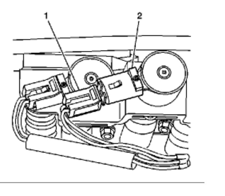

Is the check engine light on? If it is a solenoid, it will code.
When was the last time you change the fluid and filter?
I attached the procedure for the pressure regulating solenoid. This could be your issue. The procedure with pictures are below.

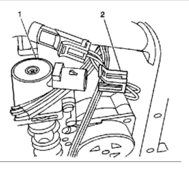

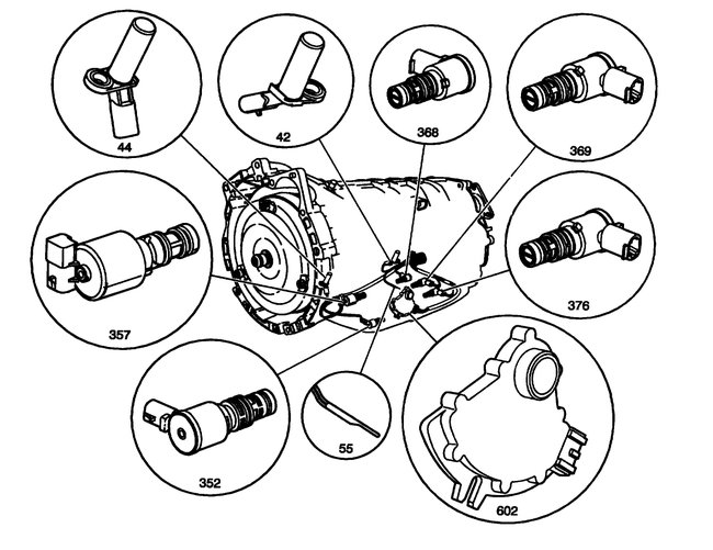

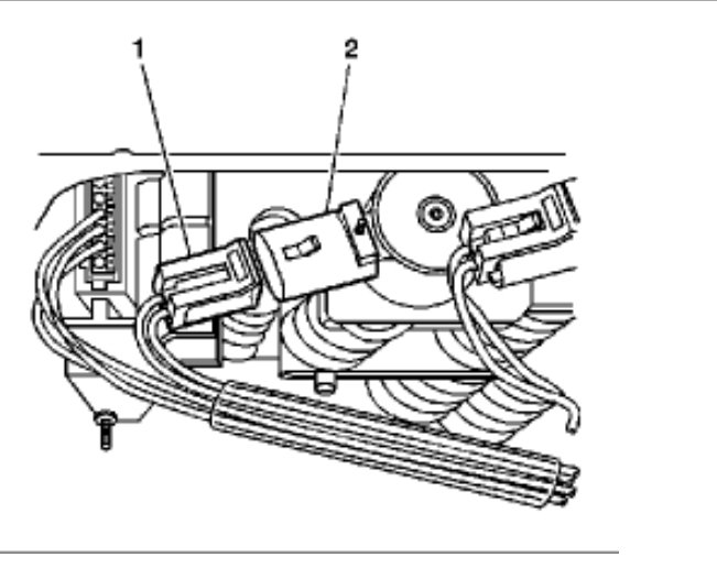

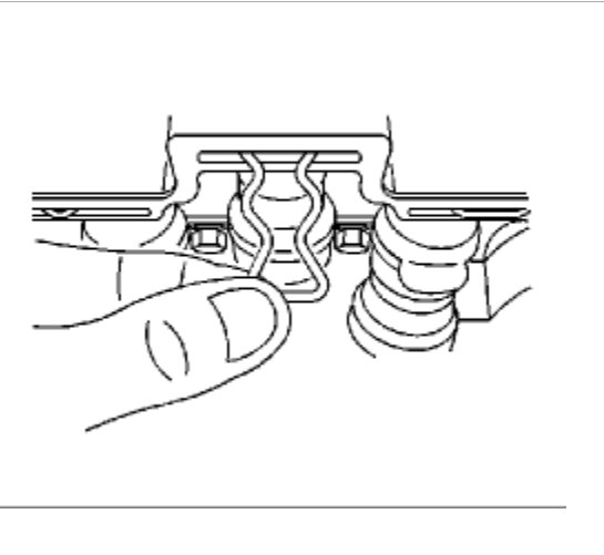

KANGIE07
Can you please tell me how to replace a solenoid?

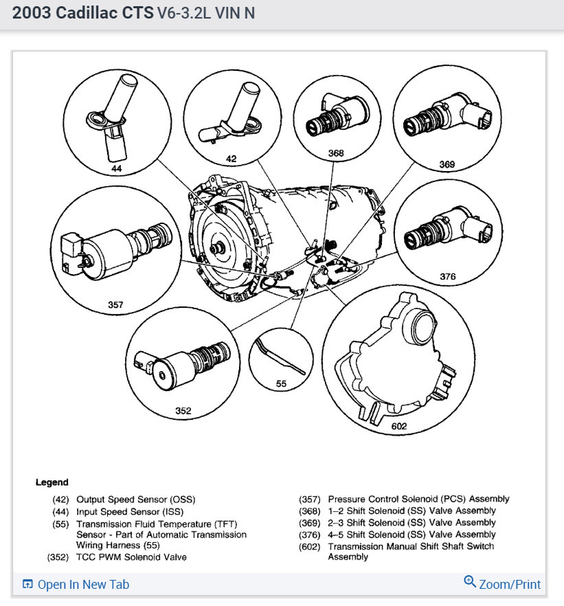

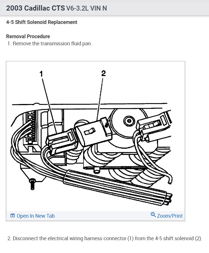

  • 54,520 POSTS
You will need to drop the pan and the solenoids are in the valve body. You will need to raise the car safely here is a guide for that.
This help help pull the pan and service the transmission
Here are some diagrams below showing you how to do the job.

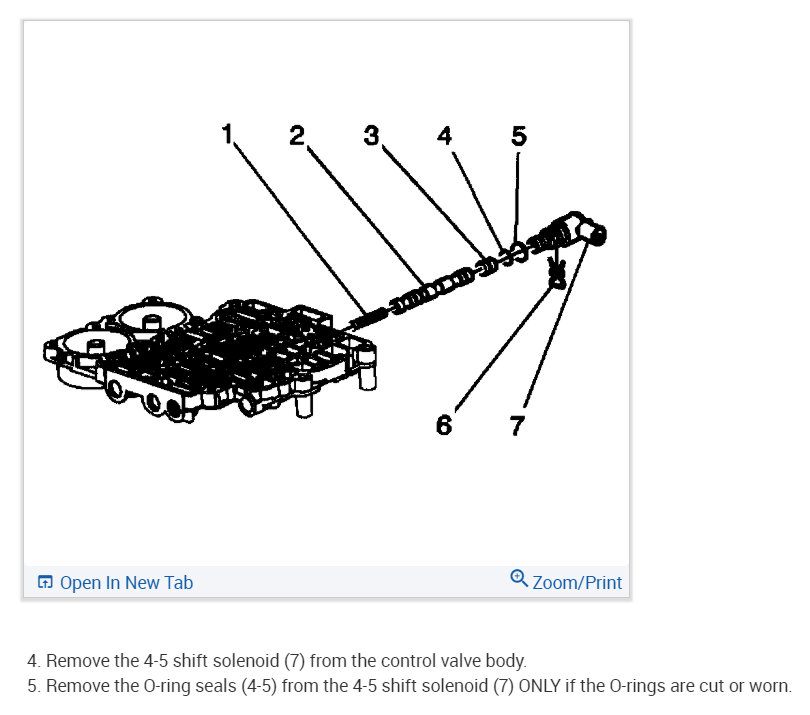

I have these codes on my car:
DTC P0762 4-5 Shift Solenoid (SS) Valve Performance - No Fifth Gear
DTC P0700 Transmission Control Module (TCM) Requested MIL Illumination
DTC C1244 Powertrain Indicated Engine Drag Control Malfunction
DTC P0171 or P0174 Fuel Trim System Lean
I need to know if I can do the solenoid myself. Someone else is telling me I have to drop the transmission and send it out to California to get worked on and then have it shipped back out here.
I also have no idea what Powertrain Indicated Engine Drag Control Malfunction means. I have looked online and am not sure what is causing this or what it means.
Any help would be very much appreciated. Thank you.
Mar 31, 2021 at 9:43 AM (Merged)

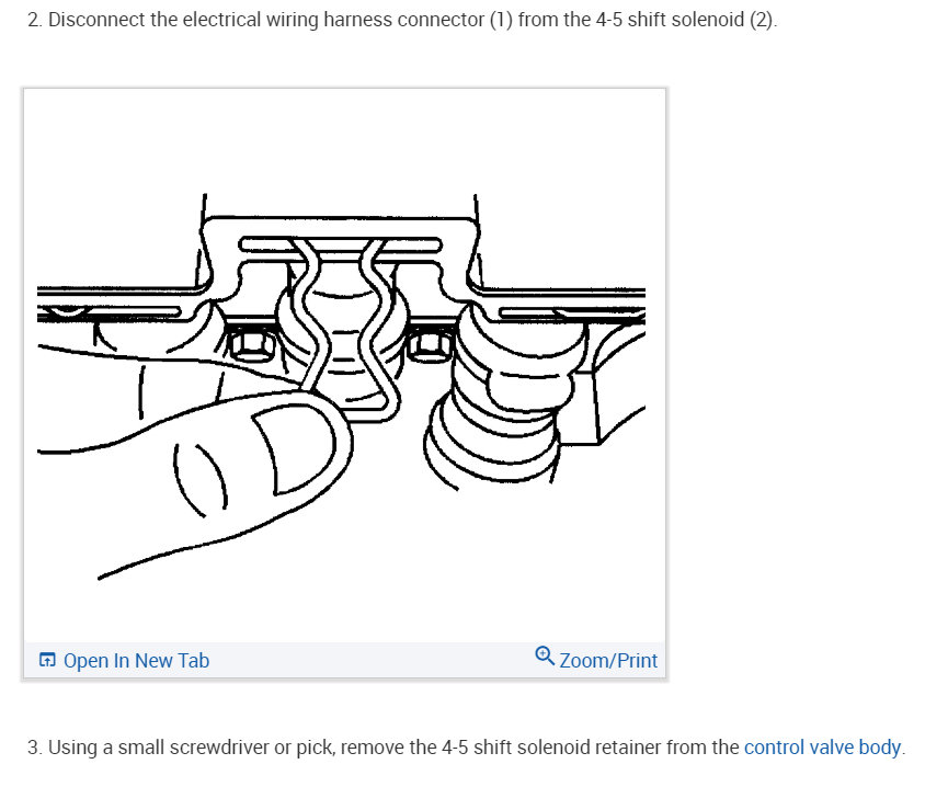

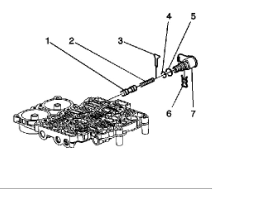

  • 54,520 POSTS
Trouble codes are given in the order of importance so if you fix the solenoid the rest will probably go away. You can do the work yourself by removing the transmission pan this guide should help.
Here are diagrams to show you how to replace the 4-5 shift solenoid - below
