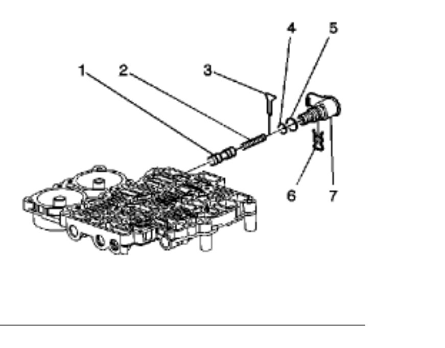

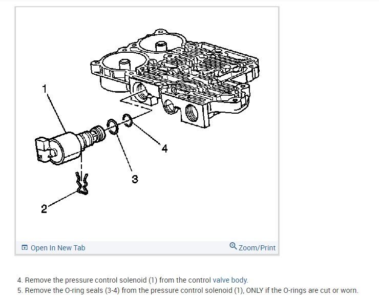

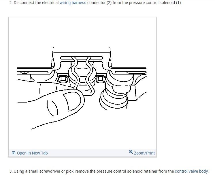

I attached the procedure for the pressure regulating solenoid. This could be your issue. The procedure with pictures are below.

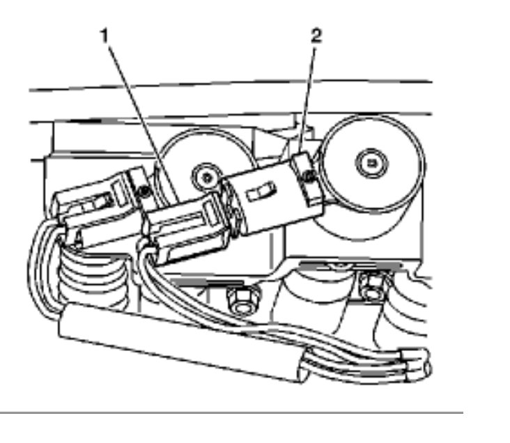

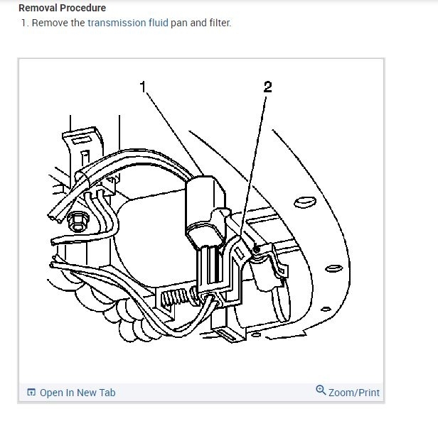

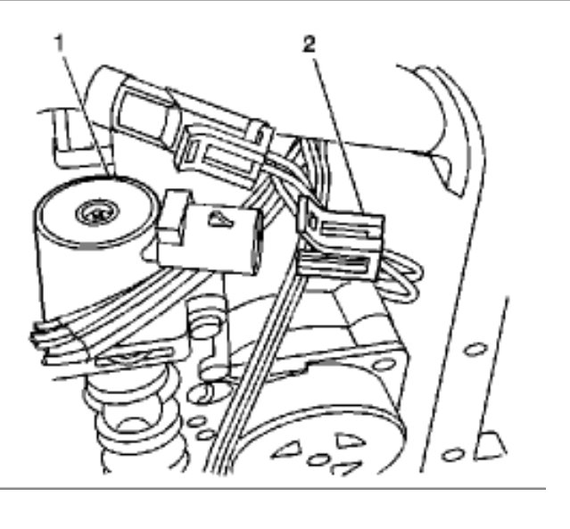

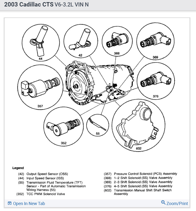

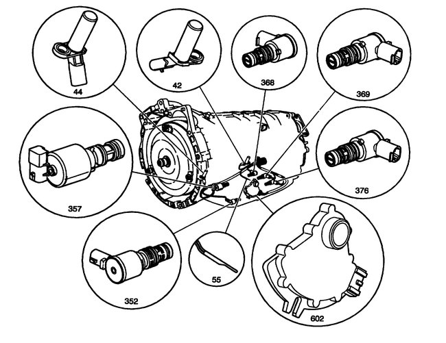

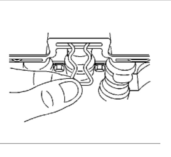

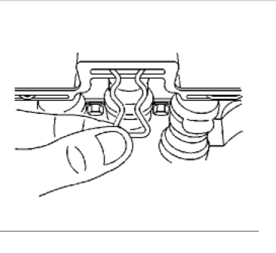

You will need to drop the pan and the solenoids are in the valve body. You will need to raise the car safely here is a guide for that.
This help help pull the pan and service the transmission
Here are some diagrams below showing you how to do the job.

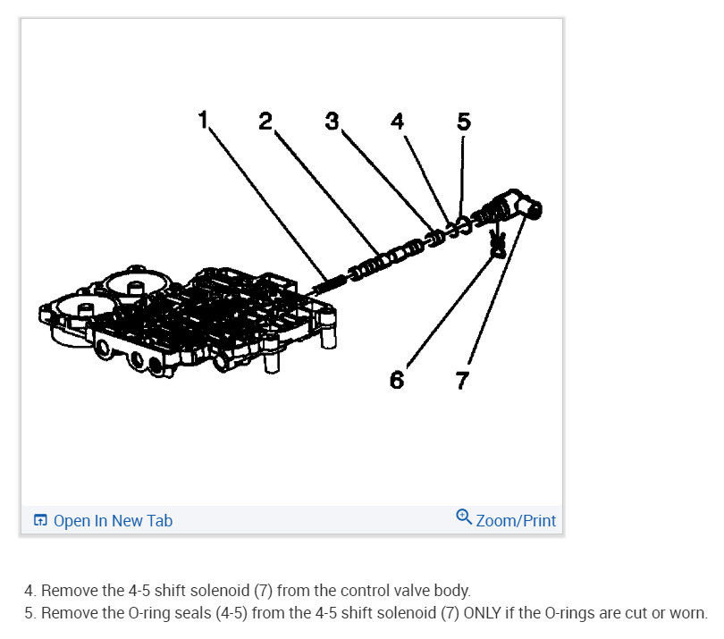

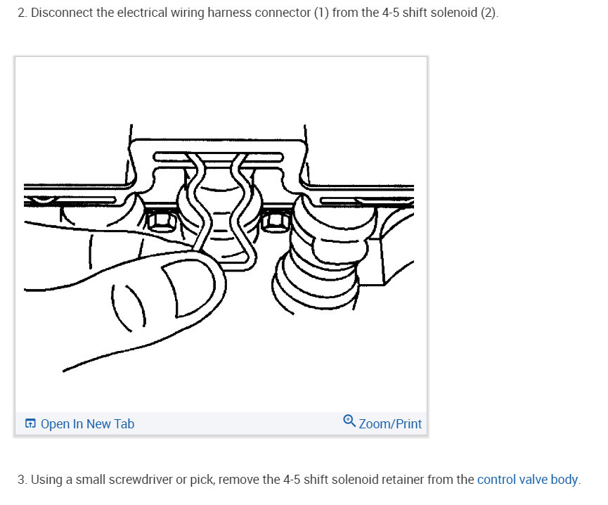

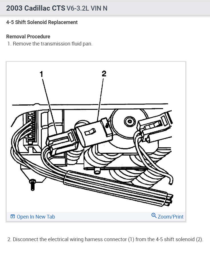

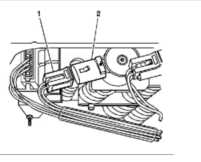

Trouble codes are given in the order of importance so if you fix the solenoid the rest will probably go away. You can do the work yourself by removing the transmission pan this guide should help.
Here are diagrams to show you how to replace the 4-5 shift solenoid - below
