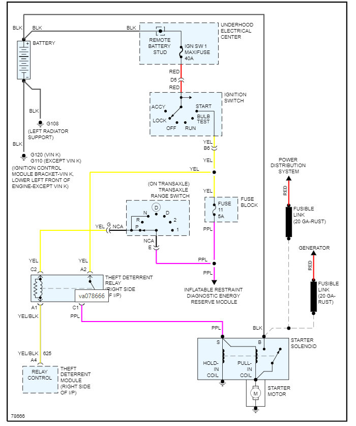

My car has been starting every day fine. It has been fair weather here but this morning it was really cold out with a low wind chill factor. Turned the switch on to start car and the dash lights just flashed on and off about every second with a clicking sound at the same time. It is suppose to warm back up to 40 degrees tomorrow ( it is now 17 degrees plus I don't know the wind chill factor but have a lot of wind and is cold. ) The car may start tomorrow when it warms up/ I don't know.
what do you think the problem is and how to repair this problem?

This sounds like a drained battery. So, we need to start with this guide and find out if that is the case.
Here are a couple guides that will help with this:
We should check the alternator at the same time so this will help with that:
Lastly, we need to check this guide and find out if we have any issues here:
I am attaching the wiring diagram for the starter as this will help with the last step if none of this works out which is checking the voltage at the starter.
However, a no start during cold weather and a clicking noise is normally always a battery issue.
Please let us know what you find, and we can go from there.
