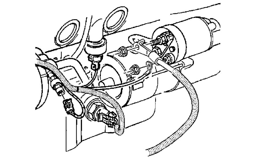

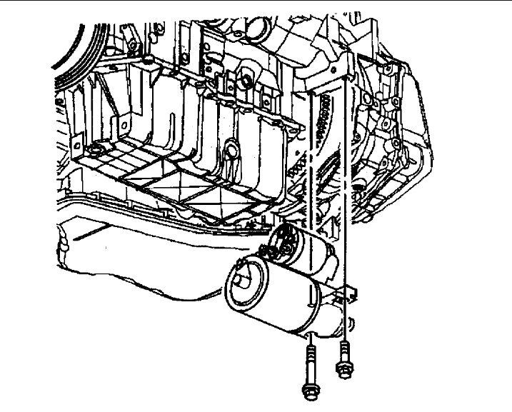

http://www.2carpros.com/forum/automotive_pictures/170934_buick_lesabre_1_1.jpg
http://www.2carpros.com/forum/automotive_pictures/170934_buick_lesabre11_1.jpg
As far as a relearn procedure, the above is all I have.
