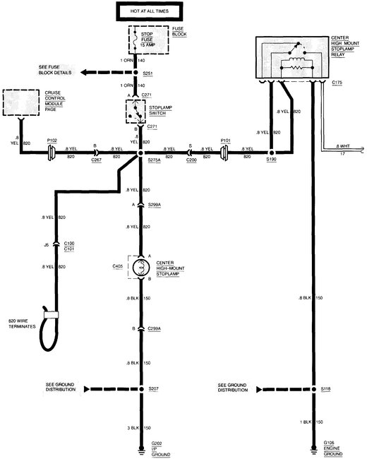

Replaced brake switch. Still no power to light. Power to switch.

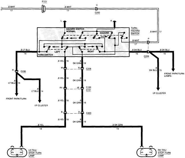

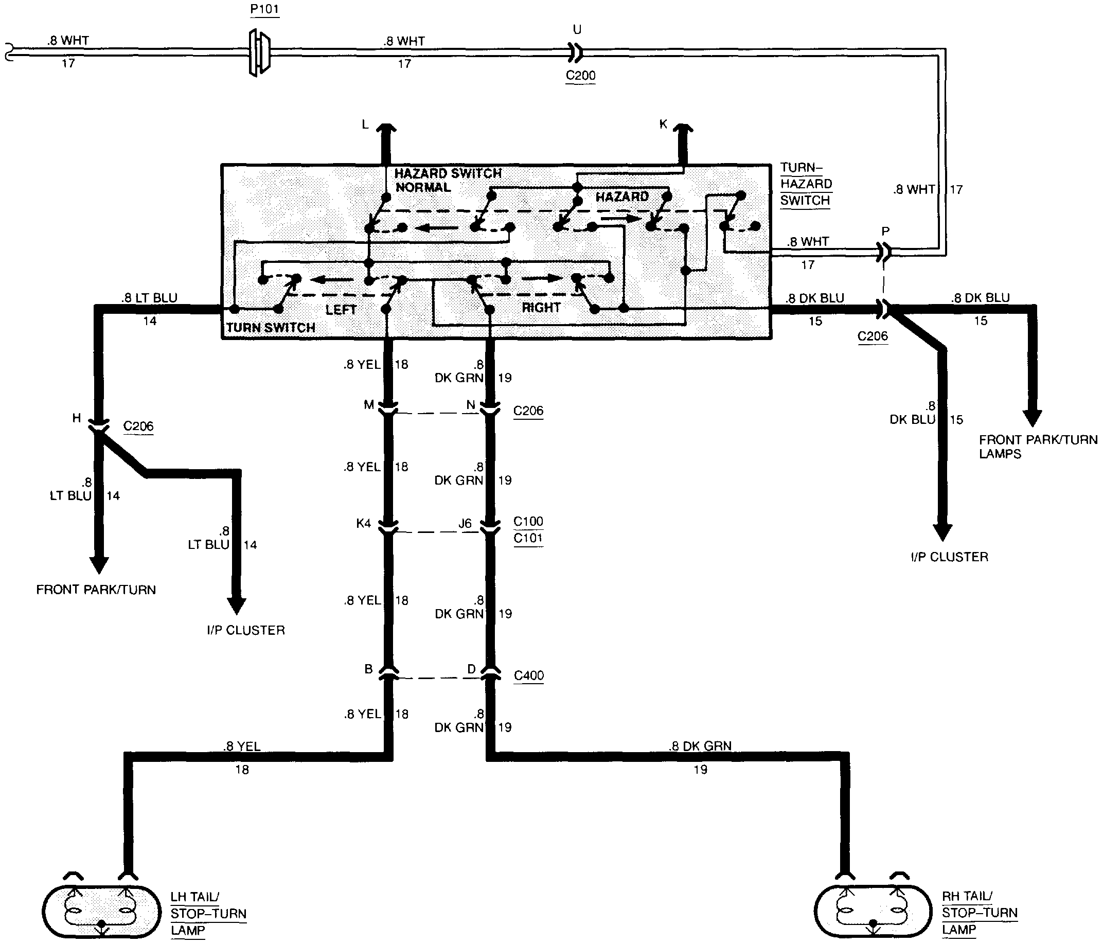

Also, I have attached the wiring schematics for the brake light system. Check grounds, make sure the switch is properly adjusted and putting out power when energized, and make sure there are no broken or damaged wires.
