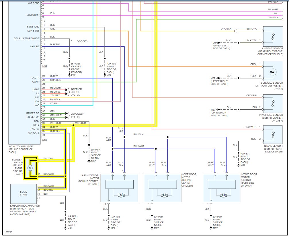

I am having the same issue! I have a 2002 Infiniti I35. I have changed the blower motor, blower motor resistor, blower motor relay and the blower motor fuses. Every time I turn mine on high A/C or heat I blow fuses. What would cause that?
Saturday, July 17th, 2021 AT 4:21 PM
  • 52,797 POSTS
Good morning,

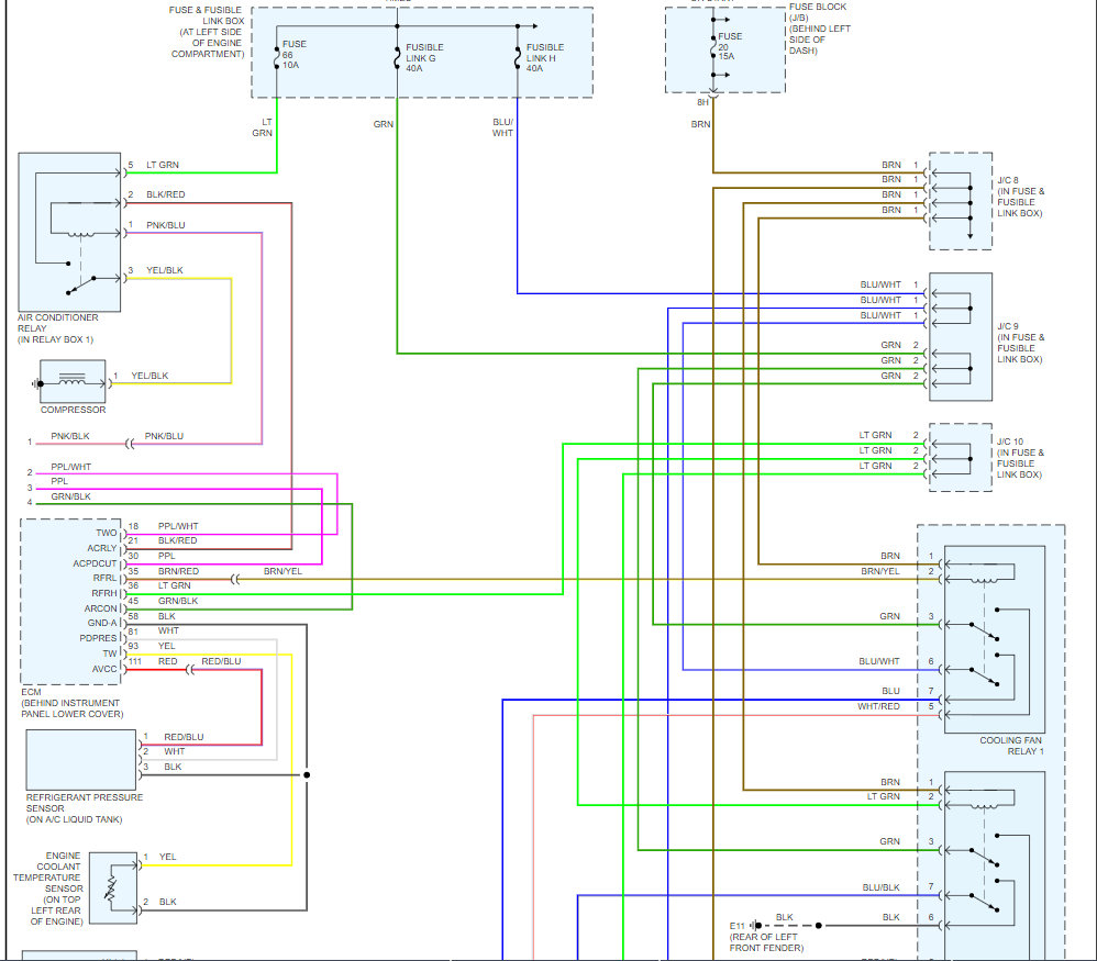

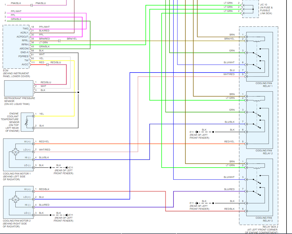

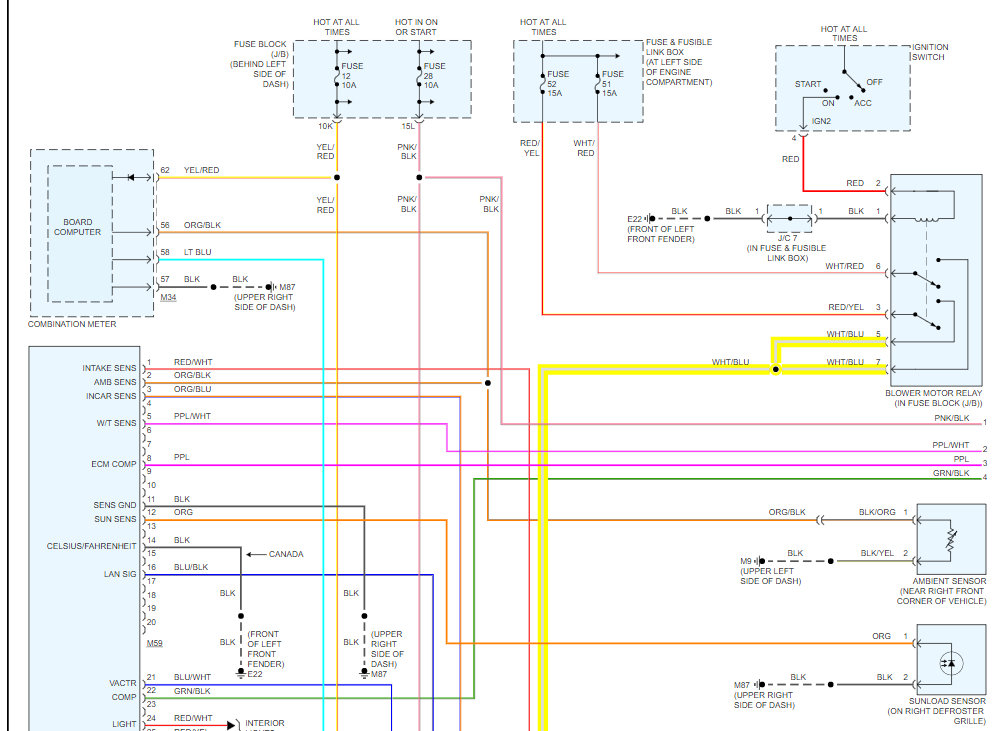

Since you replace all those parts, you will need to do an amp draw test on the blower motor. It sounds like it is drawing too much current.
I attached the wiring diagrams of the system for you to view. You need a voltmeter with an amp clamp to test the draw. Your new blower motor may be the issue.

SKYSTONER13
Even the old blower motor is blowing the same fuses. I thought the same thing so I took the new output the old back in and tried again. I don’t have the tool to check wires so should I just assume that’s my issue and spend the $30.00 to replace the wire harness?
Sunday, July 18th, 2021 AT 10:07 AM
  • 52,797 POSTS
There is an amplifier in the circuit. That could be it but I doubt it.
The harness is a guess. I would borrow one from someone to confirm.
