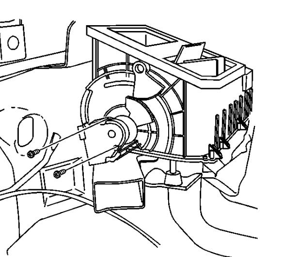

Need to know how to put the actuator and the piece behind it back on the vehicle. This is the actuator that opens and closes all the doors to route the air to floor, defrost, in your face, etc. Replaced actuator but didn't get the other piece in correctly. Only have air to defrost and in your face.

It may have to be retimed I thikit's the mode one you are talking about it has to be put back in as an assembly. The dash should have pbeen pulled as well. You have to line up the levers with the cam slot and mode actuator cam
