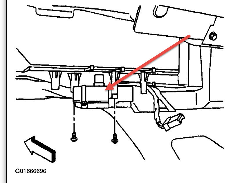

Where is the door actuator located?

If you have amanual control check for a broken cable as well. Actuator on pass side you need to remove insulator panel if you have one. See pic
Image (Click to make bigger)
