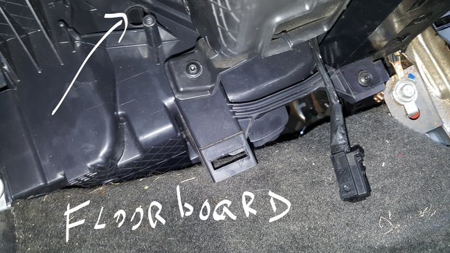

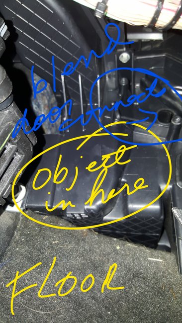

So, I reviewed the images for the knee booster, and I do not know if I am seeing what you are seeing, but if I remove this knee booster will it allow me to get into the housing where the door actuator connects? I read somewhere on the net that the door actuator connects to another part that is inside this housing. That is what I can't seem to get to, and I need to connect the door actuator to it. Here is also a video that I came across with the issue that I am having: https://youtu.be/sG2JrEmvJ9A
My dilemma is not wanting to tear the housing apart the way this guy did in his video to get to the blend door actuator connected to that part that is inside that housing.
I really appreciate your experience and knowledge in helping me with this.

Okay, went back through your information. From your description it sounds like the actual blend door has failed. They are nothing but a plastic flap with a pivot pin molded on two corners. One of the pivots goes into a hole in the case and the actuator connects to it, the other sets into a blind hole on the opposite side of the air passage. I suspect you have the same issue as the video, the door pivot broke off. If it dropped into the case there is no real easy way to get to it to fish it out and get it back into place. If it broke as I suspect getting it back into place will not really help as it would not stay in place and work.
The options are to cut the housing open, replace the door and glue the housing back together or remove the entire dash to remove the case and replace the door. Not really any other way. If you cut it open you do not need to worry so much about strength, you can always glue a section of plastic over the cut area as a reinforcement.

One thing you could do to make sure of what you have would be to buy one of the cheap bore cameras that hook to a smart phone and use the hole in the case to see what is wrong inside. You could see what is in the case and if you opt for cutting it would let you plan the lines better.
