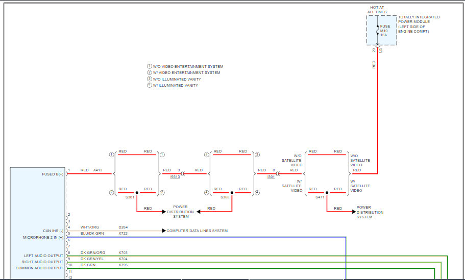

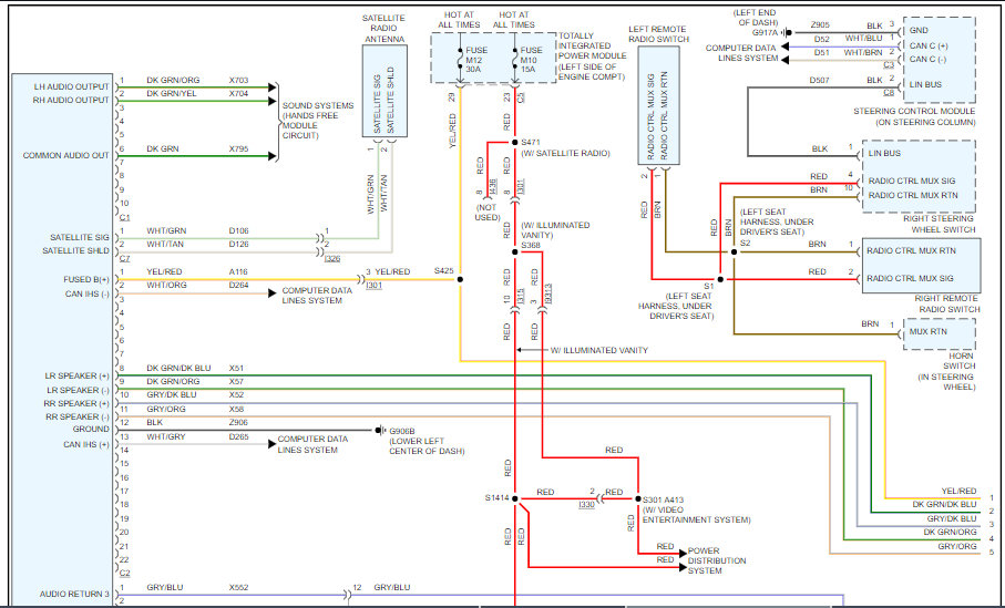

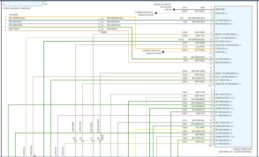

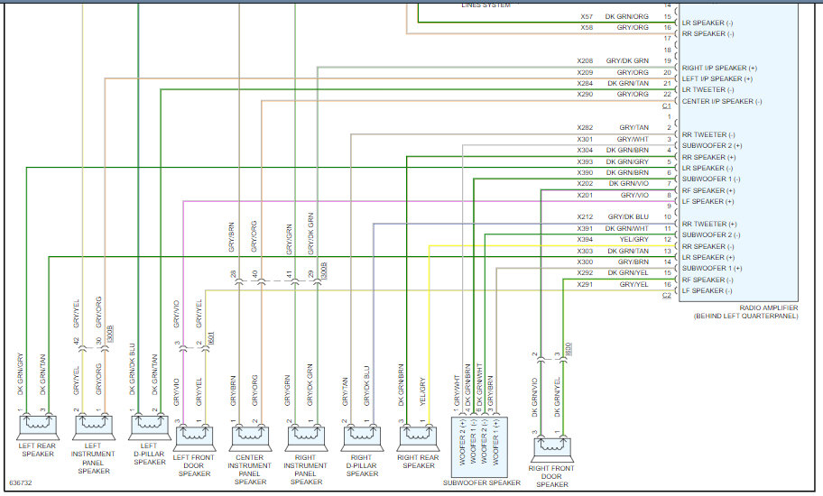

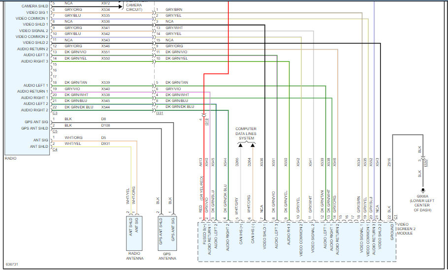

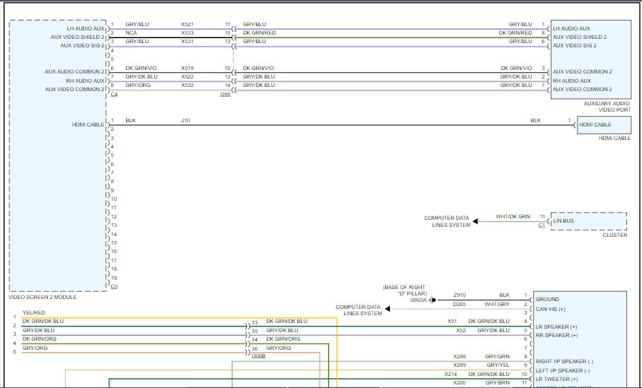

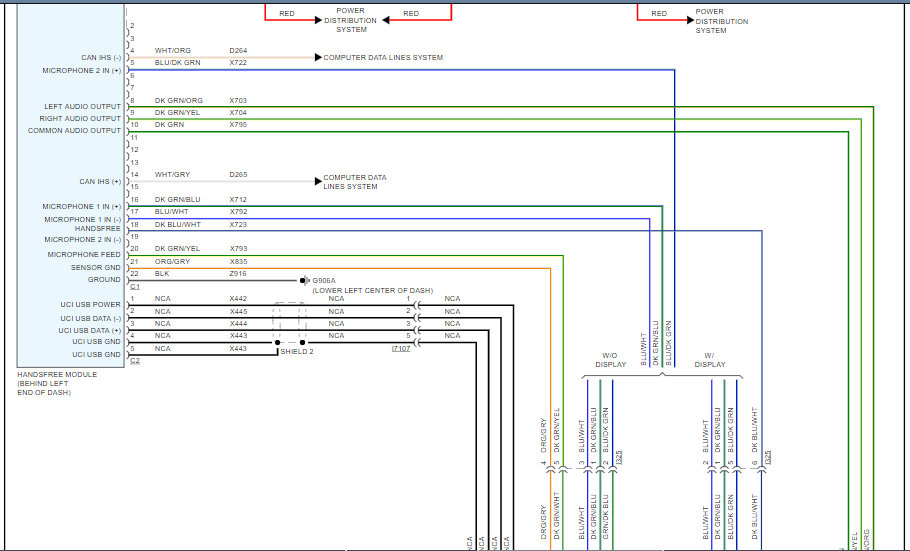

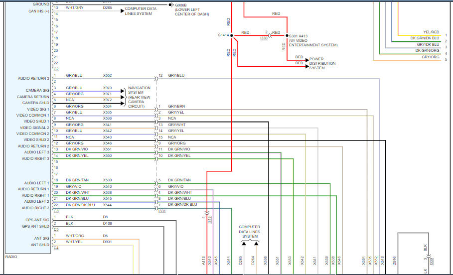

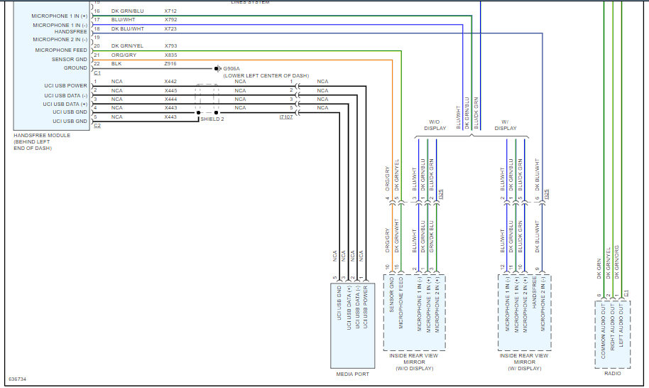

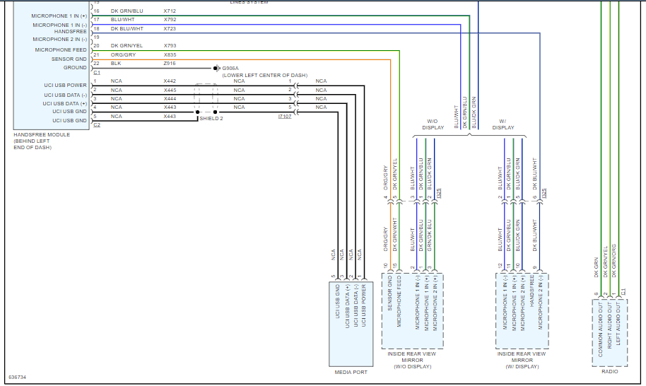

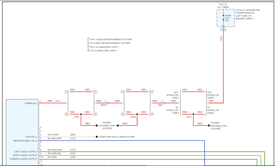

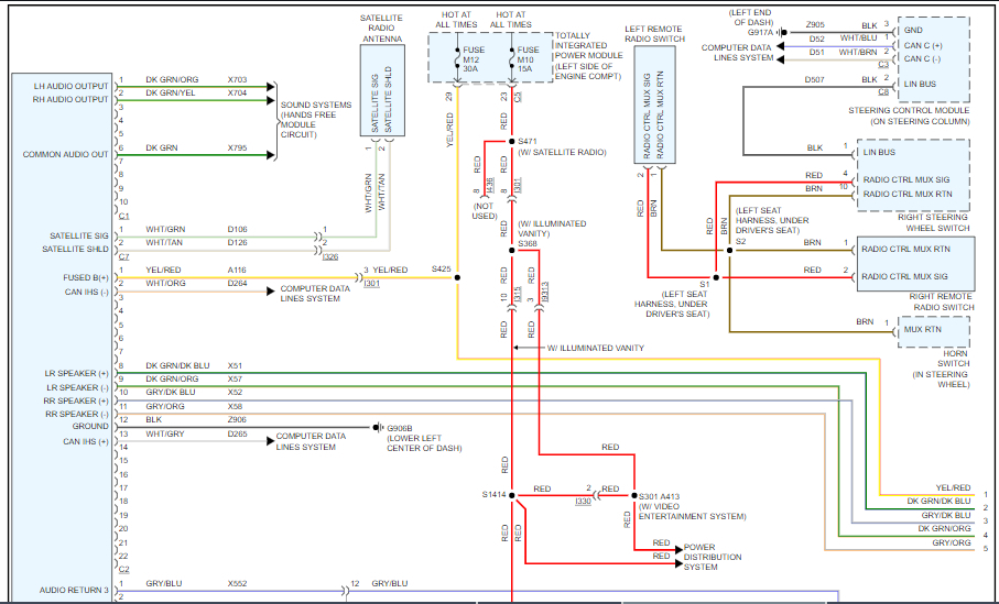

Looking for a audio wiring diagram for the GT premium 10 speaker system with pinout and color codes for the 430n radio.

Hello, I'm Danny.
Here is the information you requested. Here is a tutorial showing how to test electrical wiring:
I've attached the wiring diagrams below for the 10 speaker system and hands free module. I've cut the pictures into 3 pieces each so you can view larger. Hope this helps and thanks for using 2CarPros.
