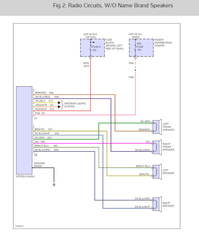

I have a Kenwood stereo/CD player that has the proper wiring, but the color of the wires from the van to the stereo are different. I need to know what colors are for what. A diagram might help, my problem is determining which ones are the power, memory, and ground from the ones that are for the speakers. If you guys could help me with this it would greatly be appreciated. Thanks.

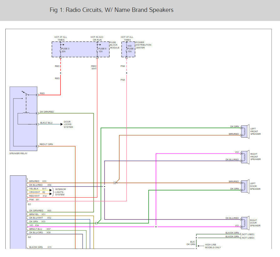

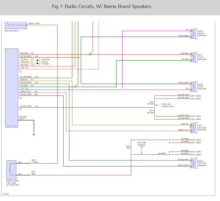

Here are the wiring diagrams for the radio in your car and a guide to help you test the connections just in case you need it:
