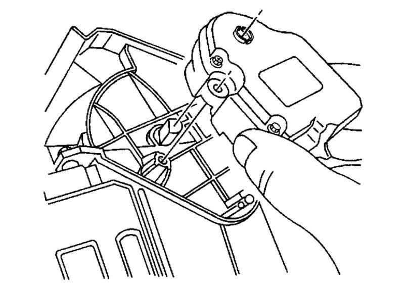

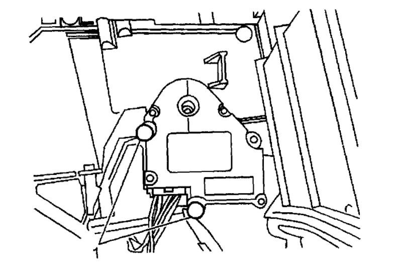

The blend door actuator could also be bad not allowing the door to move.
1. Remove the right sound insulator.
2. Remove the IP compartment.
3. Remove the body control module and the HVAC programmer from the brackets and lay aside. See: Control Module HVAC > Procedures
4. Remove the electrical connector from the passenger air mix actuator.
5. Remove the passenger air mix actuator retaining screws (1).
6. Remove the passenger air mix actuator.
INSTALLATION PROCEDURE
1. Install the passenger air mix actuator.
NOTE: Refer to Fastener Notice in Cautions and Notices.
2. Install the passenger air mix retaining screws (1).
Tighten
Tighten the screws to 1.4 N.m (12 lb in).
3. Install the electrical connector to the passenger air mix actuator.
4. Install the body control module and the HVAC programmer into the appropriate brackets. See: Control Module HVAC > Procedures
5. Install the IP compartment.
6. Install the right sound insulator.
