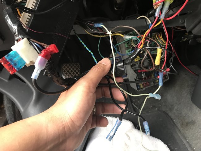

Did try it, but no luck. I bought the car with an after market alarm on it, and some of its wires are not connected anymore. If I disable the alarm by removing all its connections do you think it will work or do I need to put back all the wires that are disconnected?

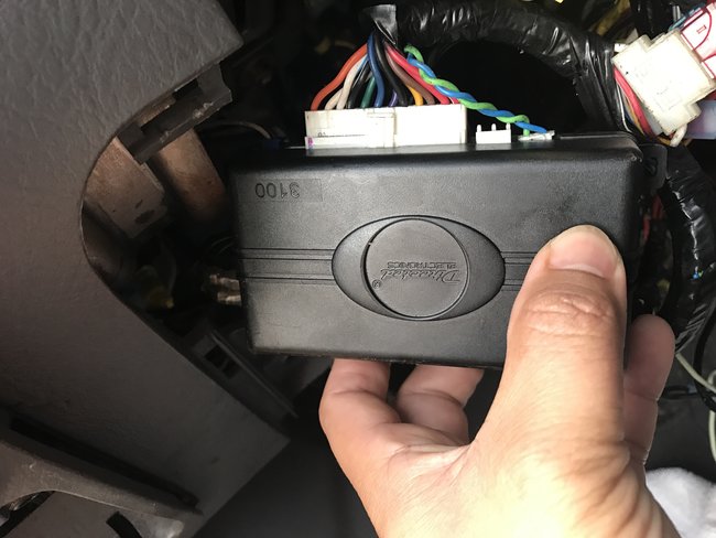

Is that alarm after market? It looks like it is.
Monday, January 4th, 2021 AT 12:24 PM (Merged)
BRYAN08
  • 12 POSTS
Yes it is. Do you know where can I put a fuel port so that I can check the fuel pressure. Coz the mechanic just used his thum to check the pressur. Im just wondering coz it start with a starting fluid. Thanks a lot for you guys time

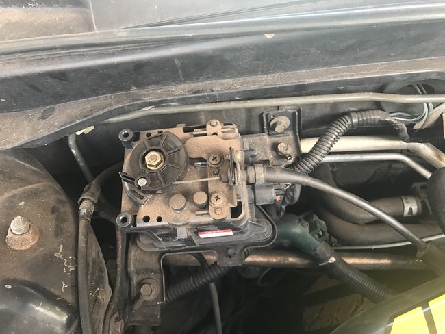

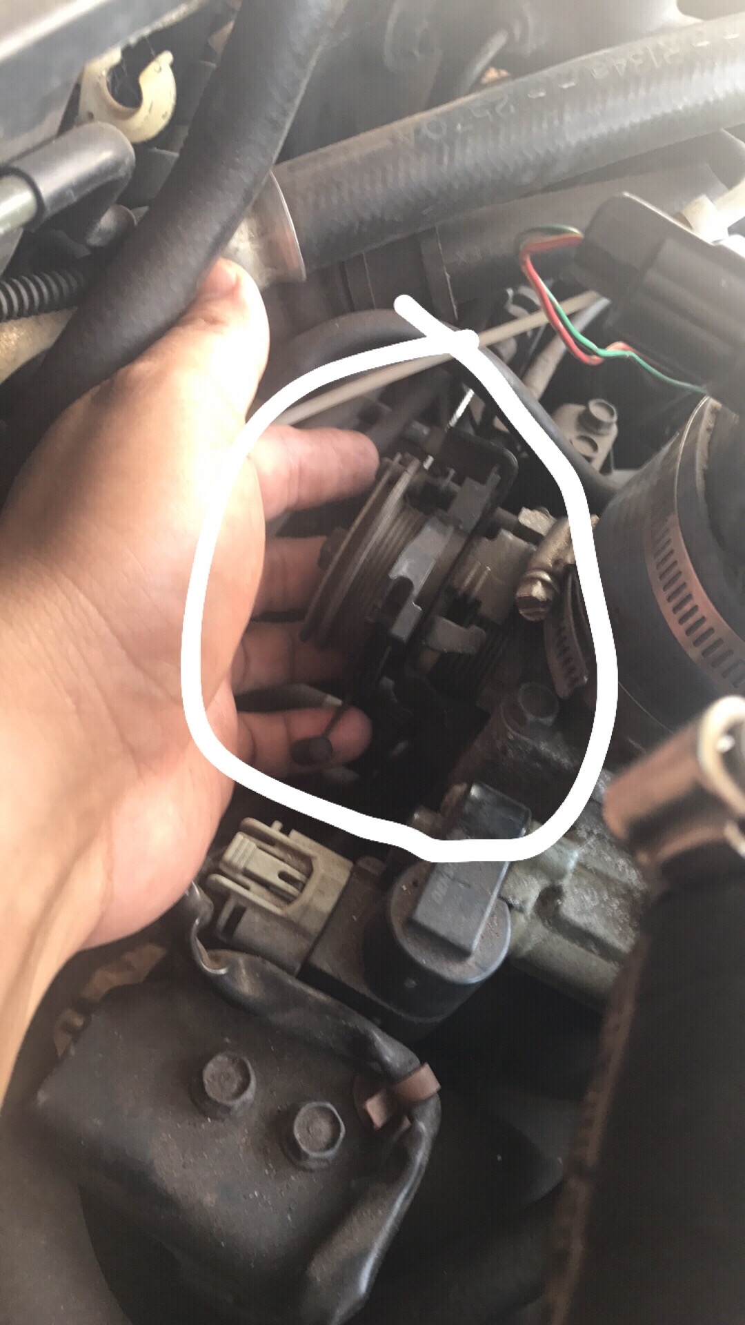

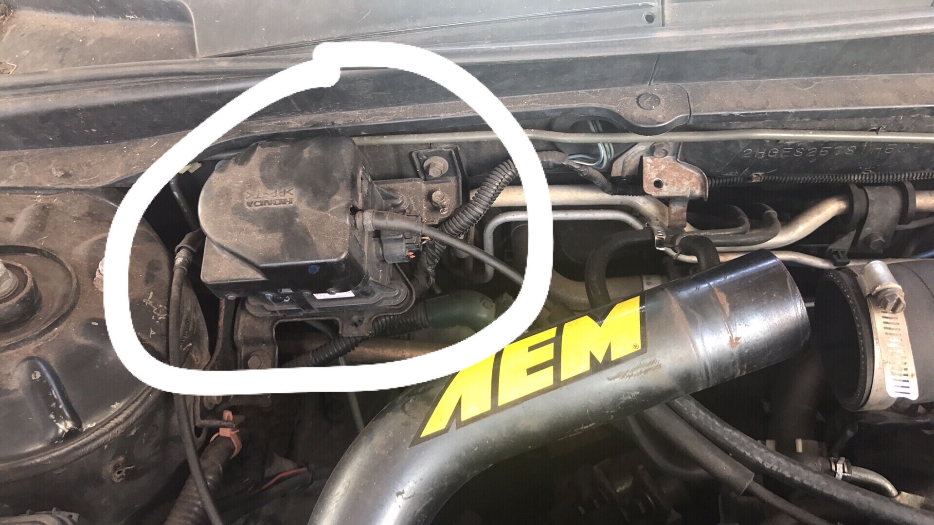

Ei ken.I found a disconnected cable. Attached photo.I dont know if its connected for the car not to run
BRYAN08
  • 12 POSTS
I removed the cover to expose the inside. Th
KEN L
  • MASTER CERTIFIED MECHANIC
  • 55,488 POSTS
This is the cruise control, does nothing to keep the car from running.
