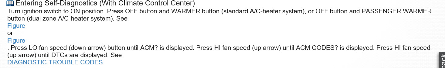

Air conditioning does not blow out of the front vents, it is coming out of the defrost and floor vents.

Follow the instructions in the picture below and get codes then get back to us. This has to be done with an automatic temperature control.

ACM B1340 and B1341

Hey JANETCLAIRE50,
It sounds like you have one of two problems, either you have a blend door actuator that has gone bad or something is stuck in the blend door itself which will require the heater box to be removed.
Here is a link to watch how to replace the blend door actuator.
Let me know what you find
