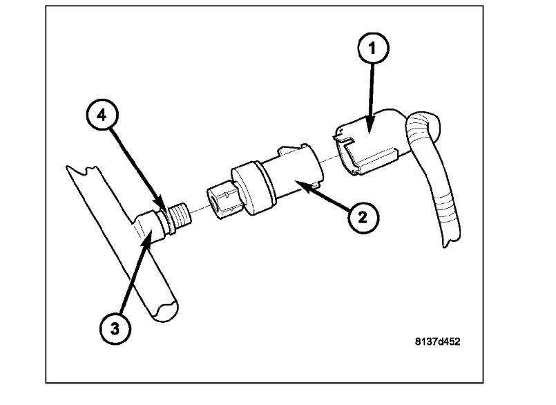

The exhilarate fan stays on without the air conditioning on.

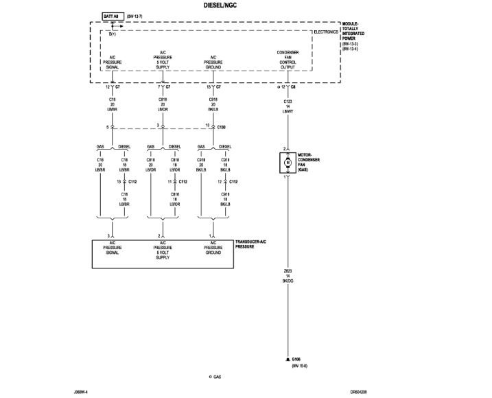

MECHANIC
52,796 POSTS
Okay, the TIPM or the fuse box under the hood is what controls the condenser fan.
I would remove the connector for the low pressure switch on the AC line and see if it shuts it off. If it does not then the TIPM is the issue.

Is a little pressure switch located on top of the intake manifold.
Thursday, May 24th, 2018 AT 1:28 PM
MECHANIC
52,796 POSTS
No, as I stated, it is on the AC lines, not the intake manifold. I attached a picture for you.
Image (Click to make bigger)
+1
Thursday, May 24th, 2018 AT 1:31 PM
