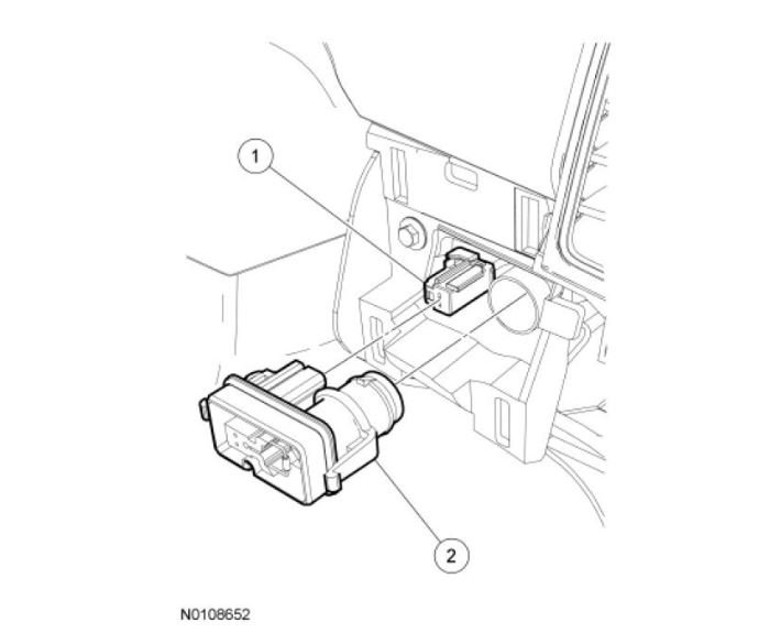

Air conditioning is not cooling down and I think it may be the cabin temperature sensor. I don’t know where it is located.
Monday, June 22nd, 2020 AT 2:35 PM
19 Replies
Good afternoon,
Do you have gauges to check the high and low side pressures? I need those reading to see what is going on with the Freon.
As far as the cabin sensor, I attached the location and procedure for you.
why do you think it is the sensor?
Removal and Installation
1. Remove the in-vehicle temperature sensor cover. For additional information, refer to Instrument Panel - Exploded View in Instrument Cluster / Carrier &/or Interior Moulding / Trim. See: Instrument Cluster / Carrier > Removal and Replacement > Instrument Cluster Finish Panel
2. Disconnect the in-vehicle temperature sensor electrical connector.
3. Rotate the in-vehicle temperature sensor clockwise to detach it from the in-vehicle temperature sensor aspirator hose and remove the sensor.
4. To install, reverse the removal procedure.
