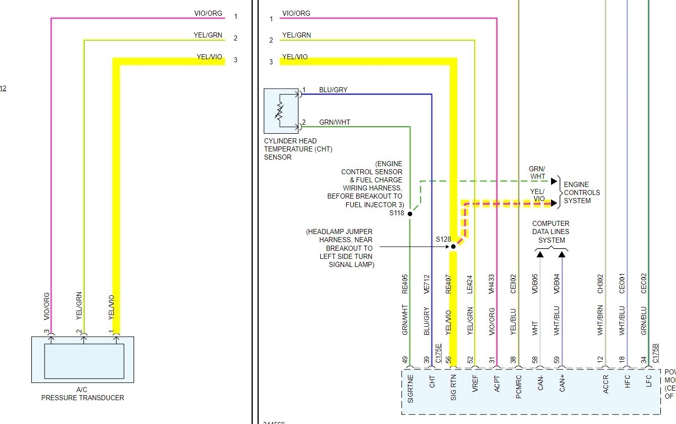

So I haven't had a chance to remove the cover off the bottom of the engine to access the connector for the compressor but I wanted to confirm with you what the ground reading on the switch connector shooed be? I'm not getting a full 12v it's fluttering around mid 7 to mid 8's and the other ones were pulling neg readings. Could this be the issue right here?

The clutch power is just to determine if it is something mechanical in the system or if it's electrical. If jumping the clutch works and you can charge the system it has to be an electrical issue. Which is very common. Usually a bad connector or ground issue.
The pressure switch yellow w violet wire is signal return aka ground. It should be at zero volts, anything over that and you have a ground issue at either the PCM or one of the other components that share that ground is damaged. That would be the fuel tank pressure sensor or the intake air temperature sensor section of the MAF. The yellow w green wire is the voltage reference for the switch. That wire should have 4.8-5.1 volts on it when you use the yellow violet as the ground. Higher and you have an internal PCM issue or there is a wire connecting to battery voltage through corrosion or?

Can you confirm the Santech A/C Switch MT0896 is compatible. So as it stands right now this is how I have this switch connector wired.
Black - with green and yellow wire harness.
Yellow - with yellow and purple
Blue - with purple and orange
Monday, December 30th, 2019 AT 1:04 PM
STEVE W.
  • 15,697 POSTS
This is the pinout for the switch. That pigtail is okay for a Ford, as long as the wires are connected to the correct pins.
Yellow with violet is ground.
Yellow with green is 5 volt reference.
Violet with orange is the sensors signal.
Monday, December 30th, 2019 AT 5:59 PM

Upon further checking I didn’t have the ground properly hooked up also noticed one of the pin terminal in the MAF. Connector is popping out of place but I was able to pop it back in but once you unplug it again it’s back out and low and behold it’s the yellow violet wire as well.
