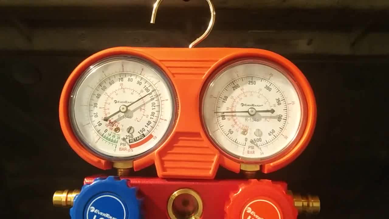

On an orifice tube air conditioning system that is not cooling and has rapid compressor cycling part of the time, what would roughly equal pressure readings of about 105–110 PSI on both the low and high sides indicate? These PSI pressures are when the compressor is not cycling and the clutch not engaged.
Attached is a short video showing the pressures on a manifold gauge set of just before and then when the compressor begins cycling.
Jul 25, 2020 at 9:07 AM
Great video. That really helps. There are a number of reasons that a compressor will short cycle. The top two are it is low on Freon due to a leak or the evaporator is frozen.
However, equal pressures are showing you that the compressor is not operating. This may be due to the compressor if the prior two reasons are not the issue. If the compressor were no short cycling then we could just assume that it is not running due to no power however, we know that is not the issue so we can rule that side of the system out completely.
That leaves low on Freon due to a leak so we need to pull it down into a vacuum and make sure it holds a vacuum for about an hour. If it does, charge it properly and retest the system.
If that does not fix the issue, check the evaporator for freezing after you have it properly charged because low Freon could cause it to freeze as well. So that means we need to properly charge it to ensure low Freon is not the issue.

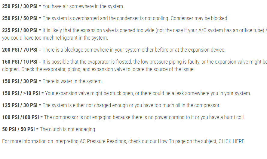

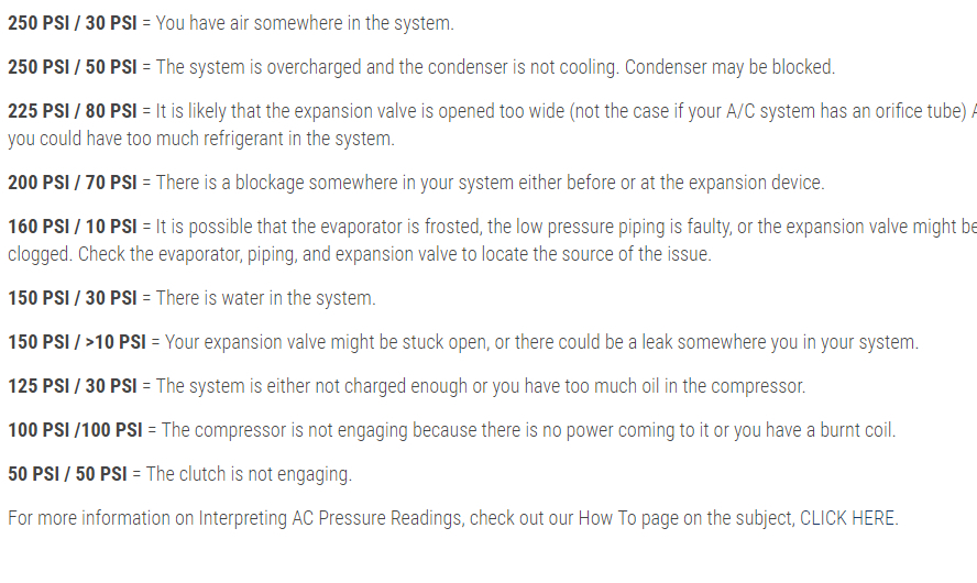

Here is a chart that will help figure out possible pressure issues. Let me know what you find with this and we can go from there. Thanks

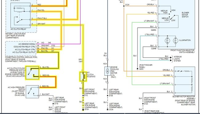

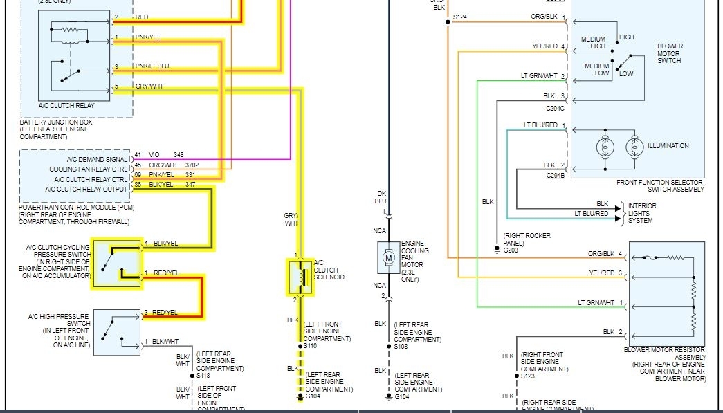

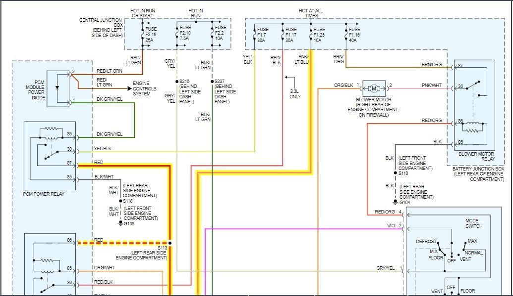

Good evening,
Is the compressor clutch engaged with those readings?
If they are, you need to replace the compressor, dryer and the orifice tube.
https://www.2carpros.com/articles/replace-air-conditioner-compressor
If it is not then we need to find out why.
I attached a wiring diagram for you to view. Do you have a test light for some testing.

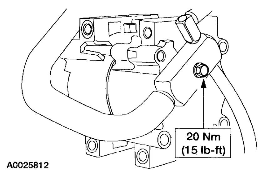

REMOVAL
CAUTION: When installing a new A/C compressor due to an internal failure of the old unit, you must carry out the following procedures to remove contamination from the air conditioning system:
If A/C flushing equipment is available, carry out flushing of the air conditioning system.
If A/C flushing equipment is not available, carry out filtering of the air conditioning system.
Install a new evaporator core orifice.
Install a new suction accumulator.
NOTE: Replacement of the suction accumulator is not required when repairing the air conditioning system except when there is physical evidence of system contamination from a failed A/C compressor or damage to the suction accumulator.
1. Perform the Refrigerant Discharging and Recovery Procedure.
2. Position the air cleaner outlet tube aside.
1 Loosen the clamp.
2 Disconnect the crankcase ventilation tube.
3 Position the air cleaner outlet tube aside.
3. Remove the accessory drive belt from the A/C compressor pulley.

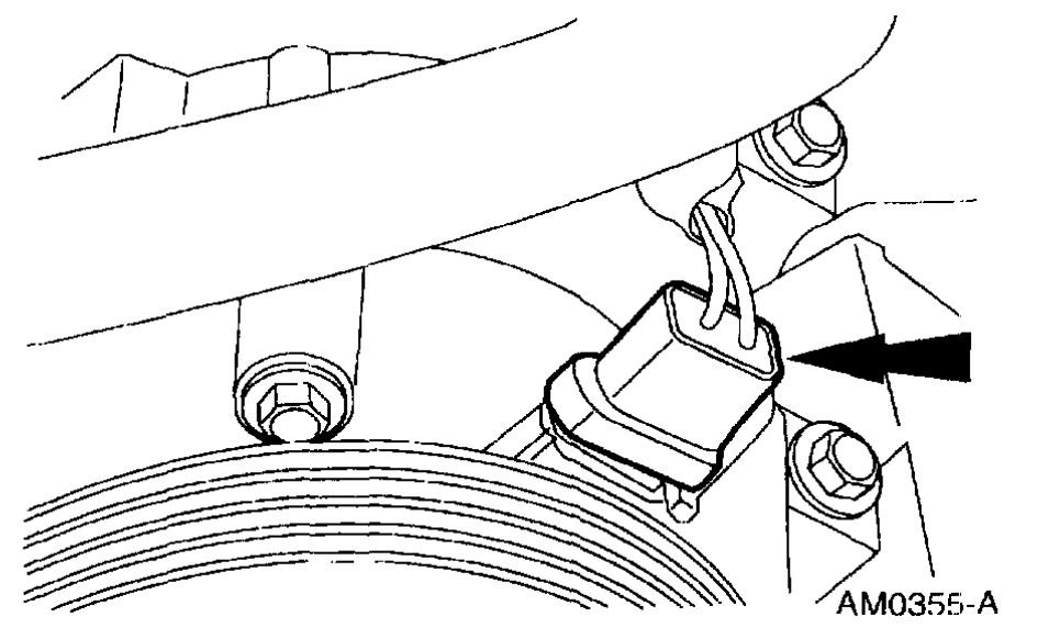

4. Disconnect the electrical connector.

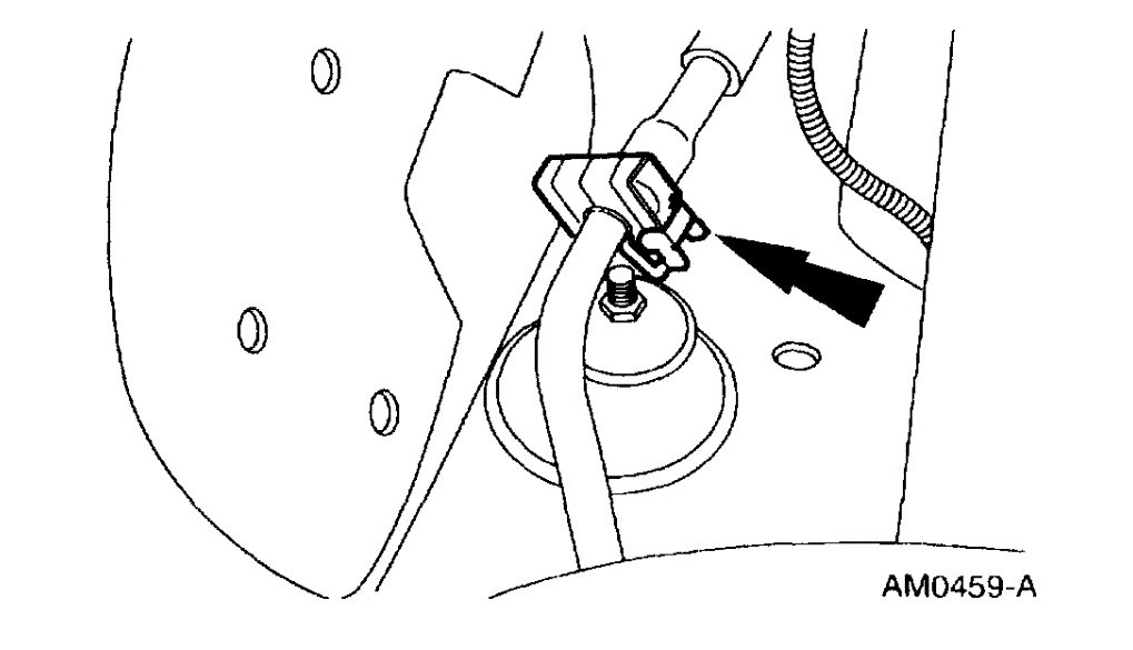

5. Remove the clamp nut on the compressor manifold and tube assembly.

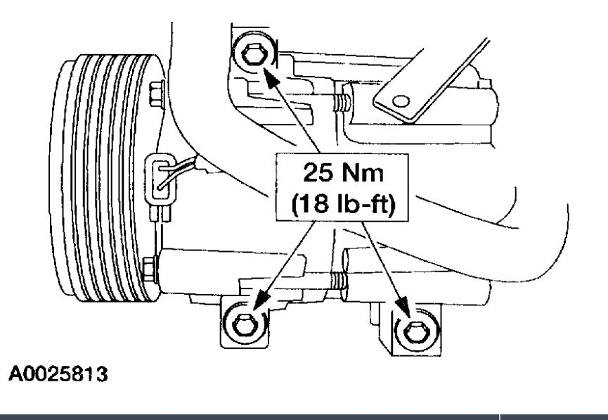

6. Loosen the bolt and disconnect the compressor manifold and tube assembly from the A/C compressor.
7. Remove the bolts and the A/C compressor.
Discard the O-ring seals.
INSTALLATION
1. To install, reverse the removal procedure.
If a new A/C compressor is to be installed, the A/C compressor clutch field coil and the A/C clutch plate must be transferred from the old unit.
Lubricate the refrigerant system with the correct amount of clean PAG oil or equivalent. See: Refrigerant Oil Addition.
Install new O-ring seals lubricated in clean PAG oil or equivalent.
2. Evacuate, leak test, and charge the refrigerant system.

Those equal, steady pressure readings of 105-110 PSI on both the high and low sides are with the compressor clutch not engaged. The clutch only engages during compressor cycling and while cycling the low side pressure drops and the high side increases.
As for electrical testing tools, I do own a test light and can either borrow or purchase a multi-meter.

Okay, I need the readings for when the compressor engages. I need to see how low the low side is and how high the high side is.
They are supposed to change when the compressor comes on line.
Jul 27, 2020 at 7:54 PM
RDANNENFELSER
  • 43 POSTS
The low side pressure drops and fluctuates consistently between 20 and 40 psi during compressor cycling.
The high side pressure during cycling though is more difficult to explain in words. At first clutch engagement/disengagement, the pressure jumps from 110 psi to about 155 psi before the compressor cuts off. Cycling continues for about 8 minutes and as it does the overall pressure on the high side increases gradually until reaching about 215 psi. Pressure then begins to gradually decrease until dropping back to a steady 100 psi when cycling stops.
Like I said, the high side pressure is difficult to explain. The attached video shows the pressures over the entire cycling duration and even just skipping through it should provide better information than what I can give in words.
Aug 1, 2020 at 6:37 PM

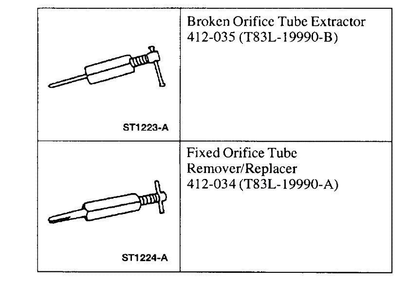

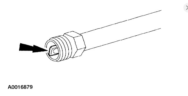

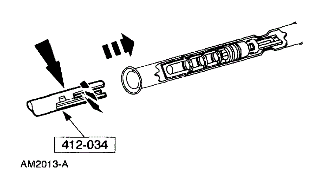

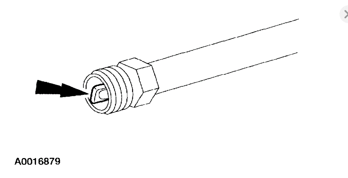

Based on that video, you need an expansion valve. The compressor is cycling because the low pressure goes below 20 pounds and the low pressure switch open at 20 pounds.
You have an orfice tube. I attached a picture of the tube and the tools required to change it.
Aug 1, 2020 at 10:28 PM

Thank you. After changing out the orifice tube, should the accumulator be replaced and is there a need to flush the system before evacuating/charging?
Aug 2, 2020 at 3:06 AM
Yes, anytime you open the system, the dryer should be replaced.
No, to the flush. Just make sure you evacuate it for about 1 hour.
Aug 2, 2020 at 3:14 AM

As for the orifice tube replacement, RockAuto and O'Reilly list both fixed and auto adjusting. I assume I will need just a fixed, correct?
Aug 3, 2020 at 6:25 AM
That is correct.
The rock auto is the correct one.
