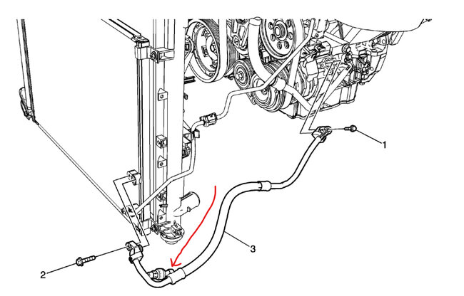

A/C works intermittently
JOE WRIGHT2
  • 81 POSTS
The problem was high pressure control was defective, I no longer have this car.
+1
Thursday, August 3rd, 2023 AT 12:35 PM
AUTODOCTOR24
Thank you, sir. Do you happen to recall where this high-pressure control switch was? I don't seem to find it in plain view - looked in the back of radiator, on the a/c lines from compressor, from cabin, nowhere to find. I don't know if it is in the front of the condenser, which is between the power steering cooler and main radiator. Thanks for your reply in advance.
Tuesday, August 8th, 2023 AT 4:03 PM
KEN L
  • MASTER CERTIFIED MECHANIC
  • 55,281 POSTS

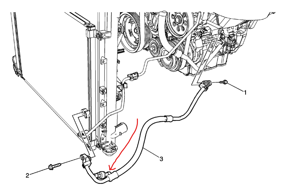

Yes, the high-pressure sensor is in the high-pressure line from the compressor to the condenser. Check out the images (below). Please let us know if you need anything else to get the problem fixed.
