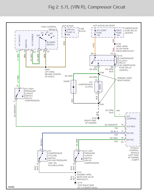

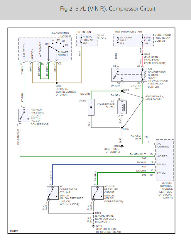

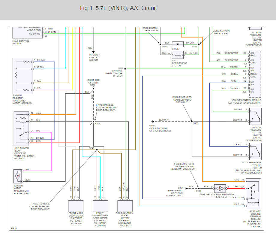

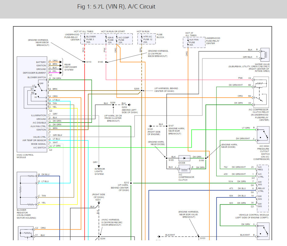

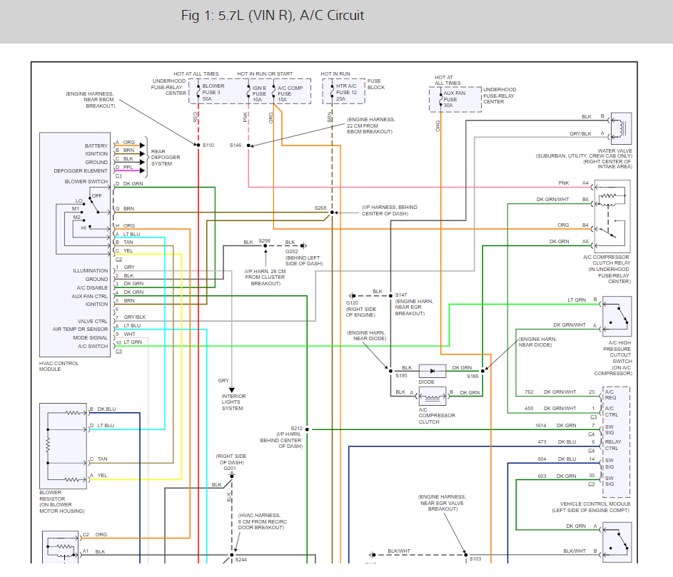

So can I ask what is working and what it not? here are the AC and compressor wiring diagrams so you can see how the system works. Did the problem happen right after the compressor installation? Something is making the system overheat like a bad ground. this guide will show you how to test the connections to ground:
