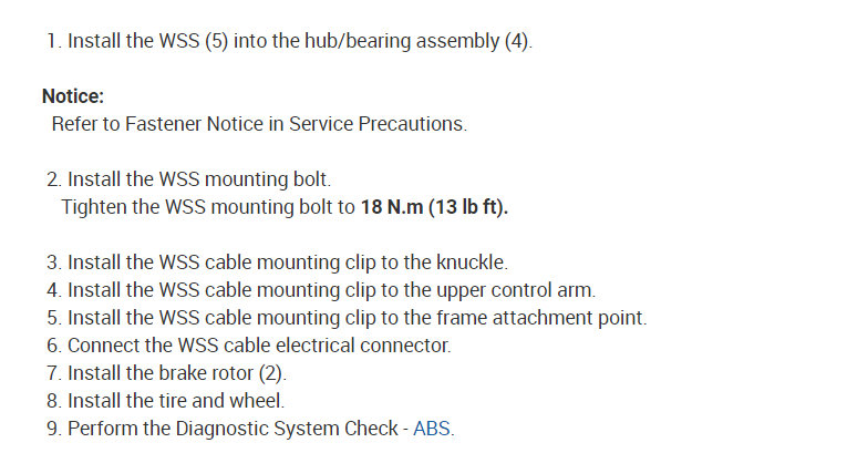

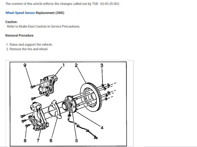

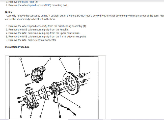

My ABS and brake light intermittently come on. I have noticed it comes on a lot when pressing my brake. What should I check first?
Thursday, May 6th, 2021 AT 10:30 PM
MECHANIC
52,796 POSTS
Good morning,
I would have the codes checked first as it will help narrow down the area of failure.
https://www.2carpros.com/articles/abs-warning-light-on-easy-repair-guide
It may be a sensor that is the most common failure.
https://www.2carpros.com/articles/abs-wheel-speed-sensor-test
https://www.2carpros.com/articles/how-to-replace-an-abs-wheel-speed-sensor
