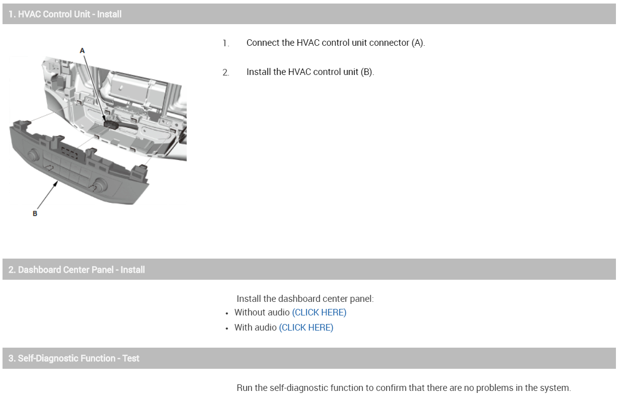

CHU4CK

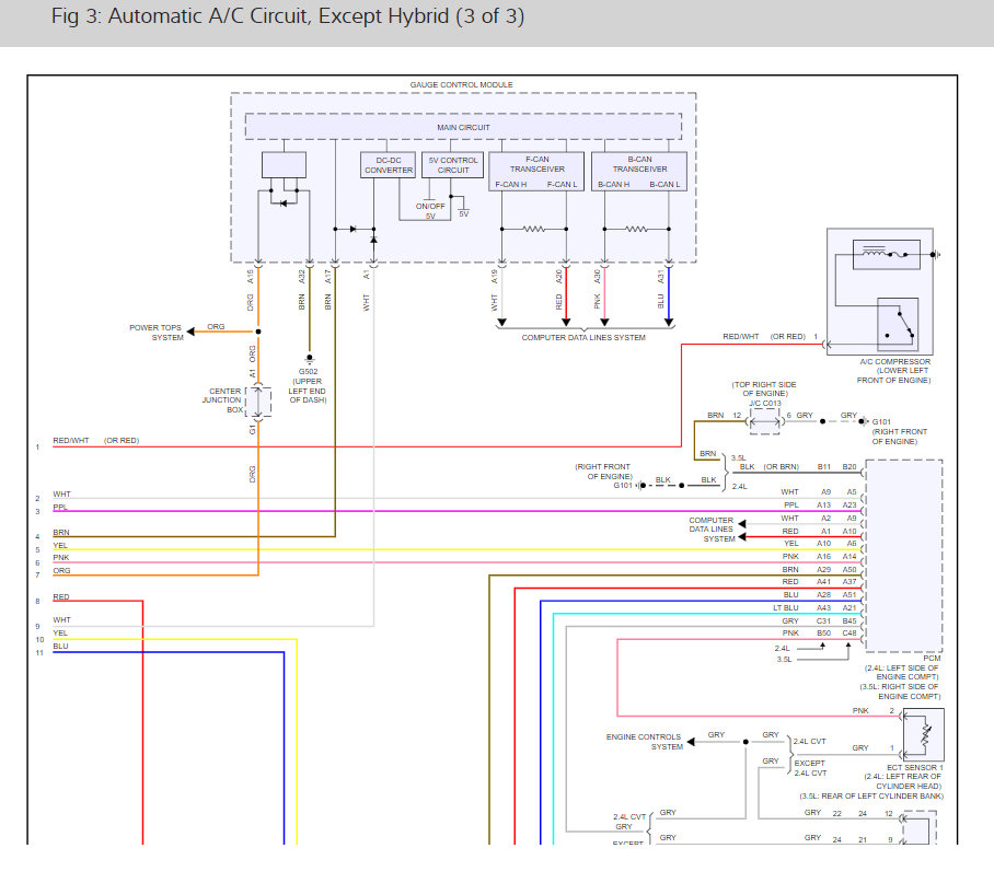

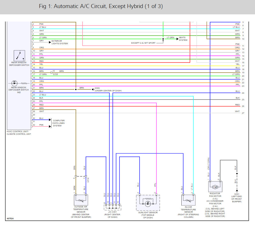

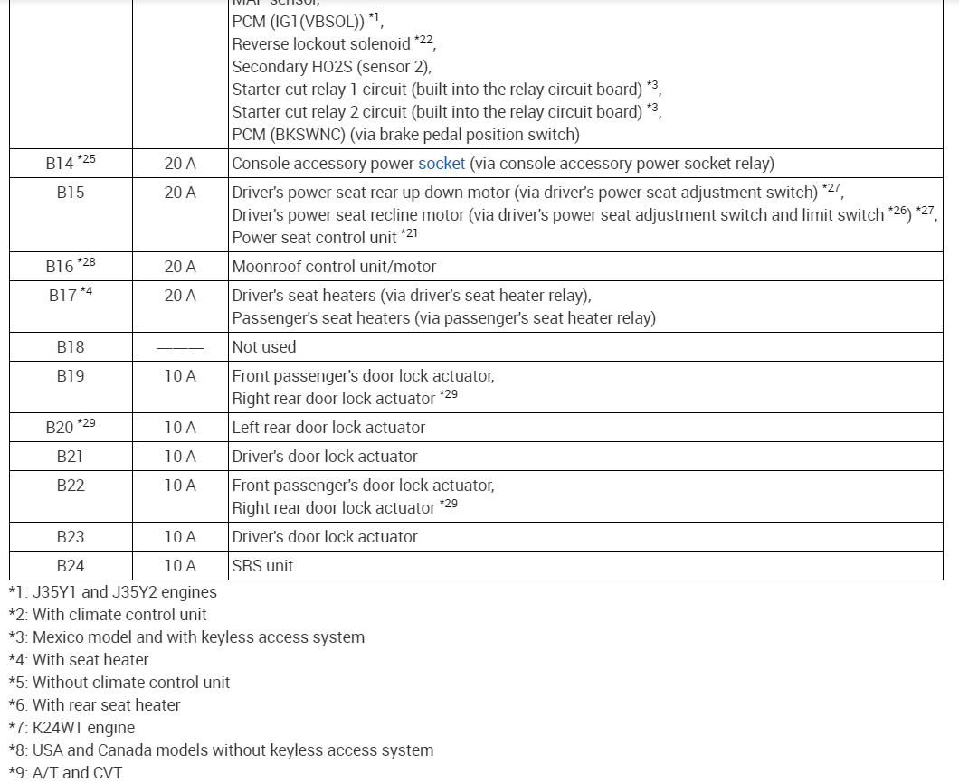

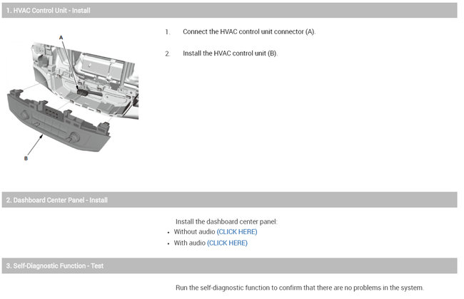

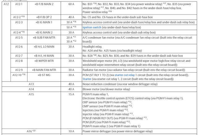

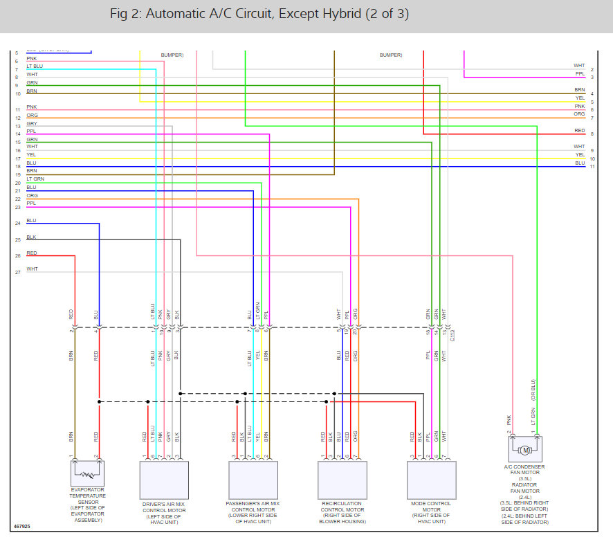

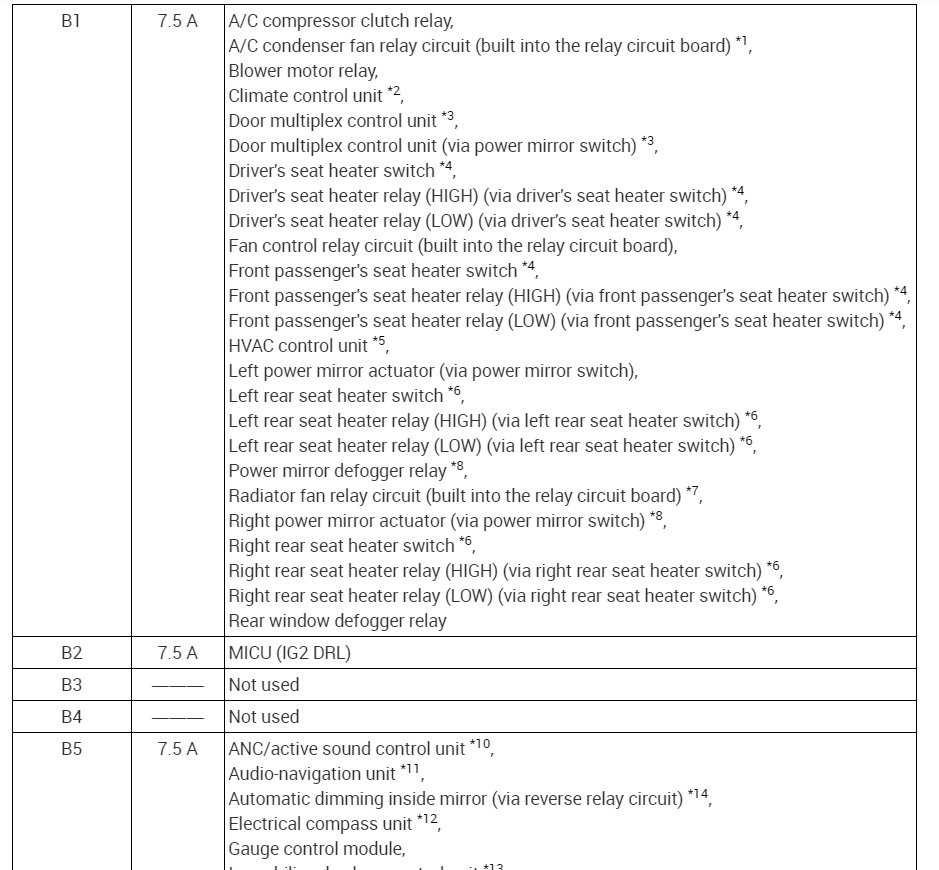

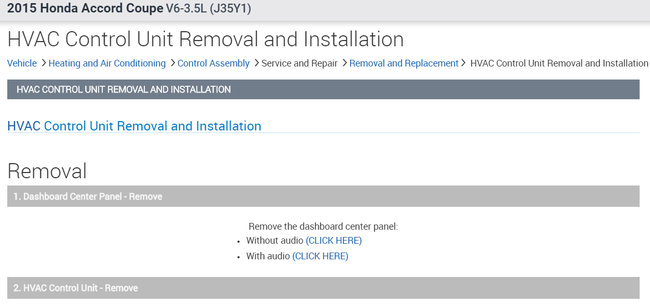

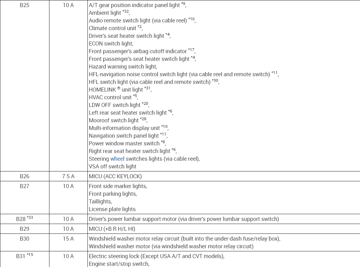

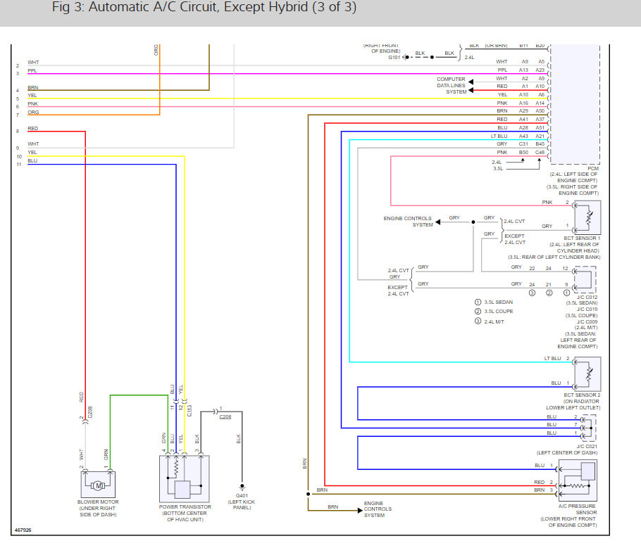

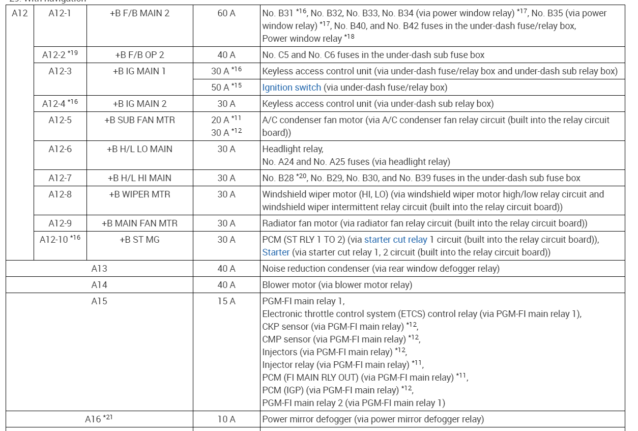

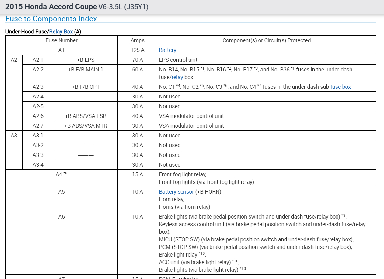

The works intermittently. It will be cooling normally and then the compressor will cycle off and wont come back on for 20 or 30 minutes. I checked the pressure with compressor not running and it was 190 PSI on both high and low side. I also replaced the relay but this did not solve the problem. I thought maybe the thermistor was bad but if I change set point to call for heat the air gets hot. Checked to see if voltage to clutch and there was not any. Not sure what to check next.
Sep 11, 2019 at 7:31 AM
  • 54,185 POSTS

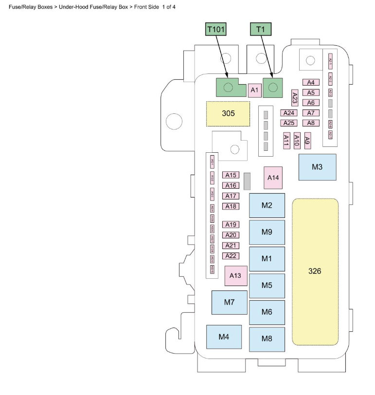

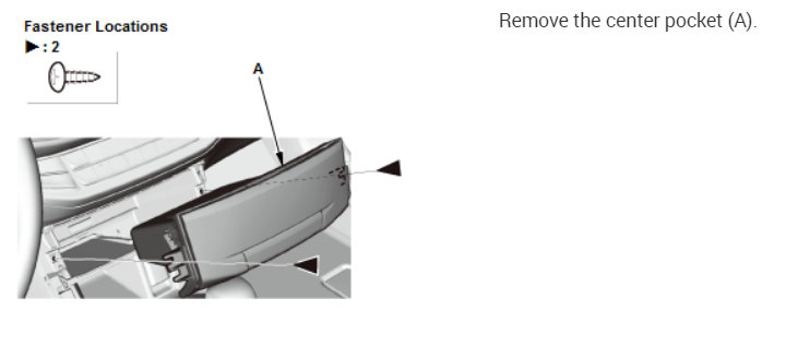

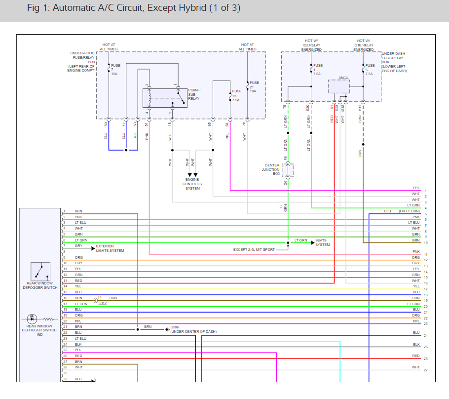

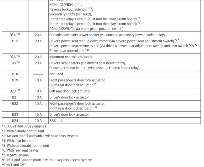

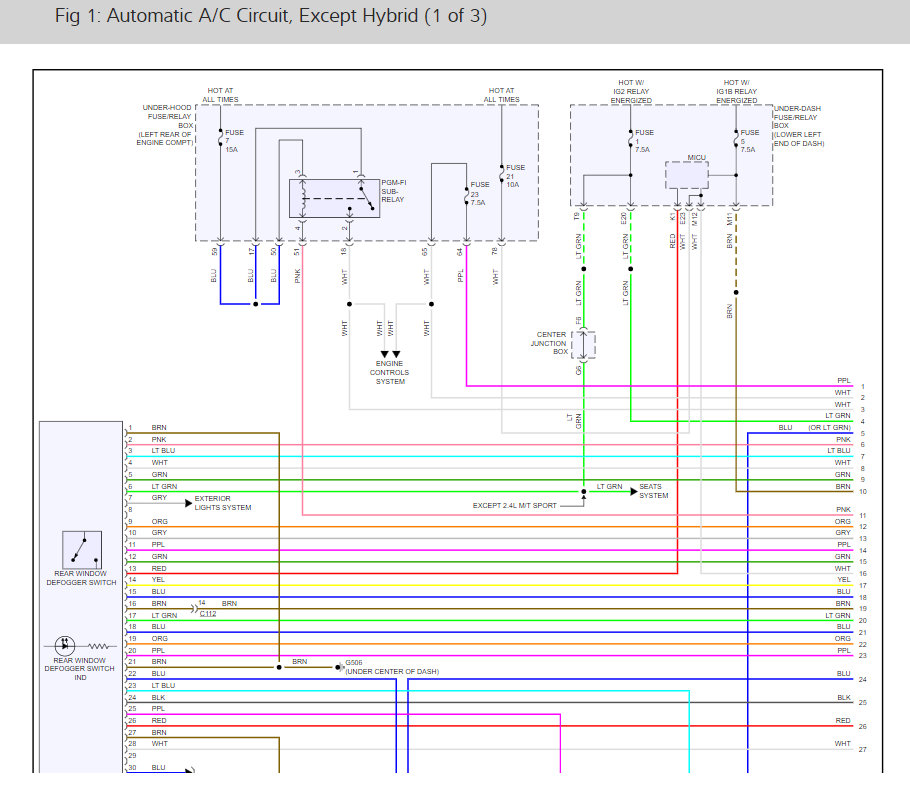

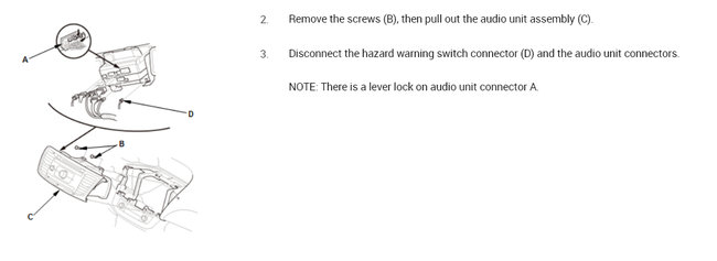

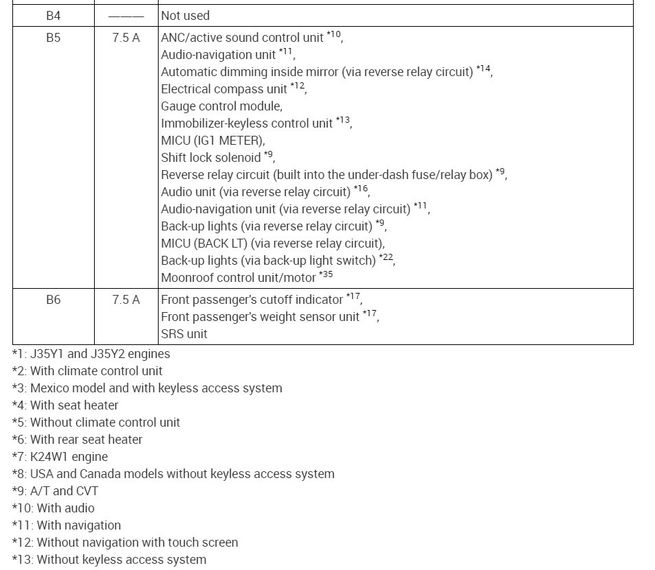

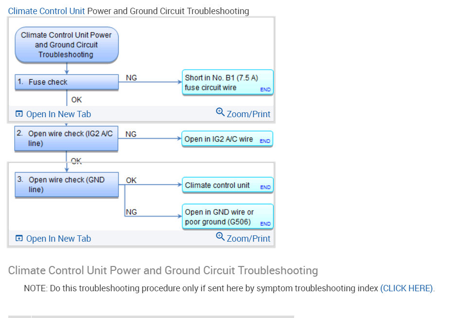

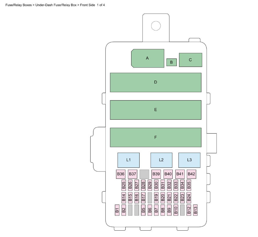

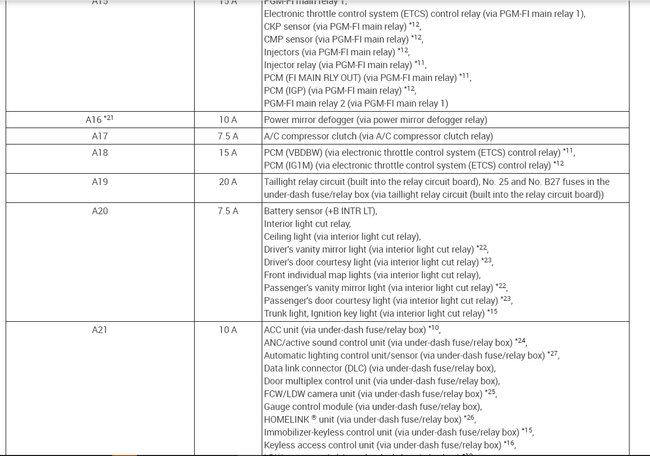

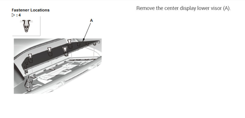

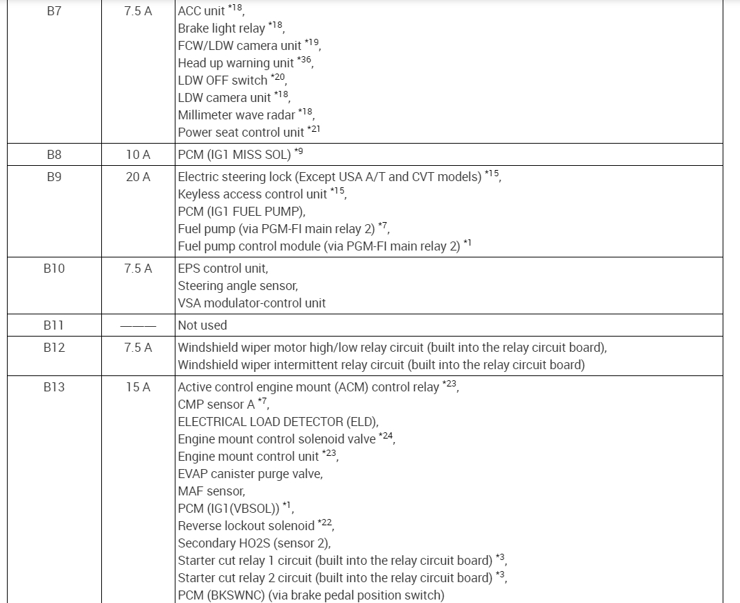

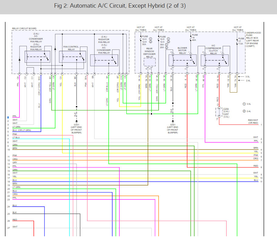

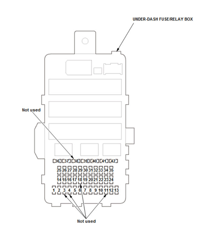

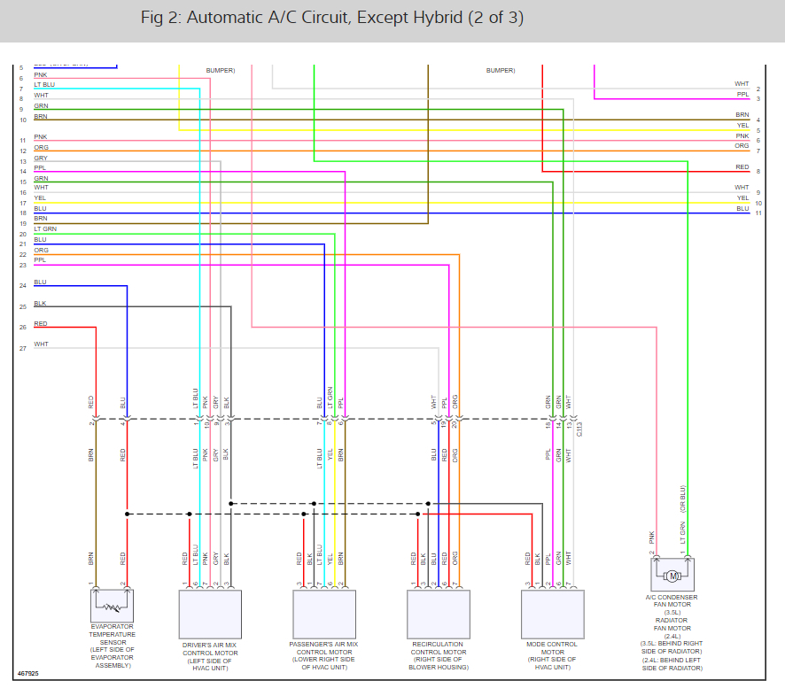

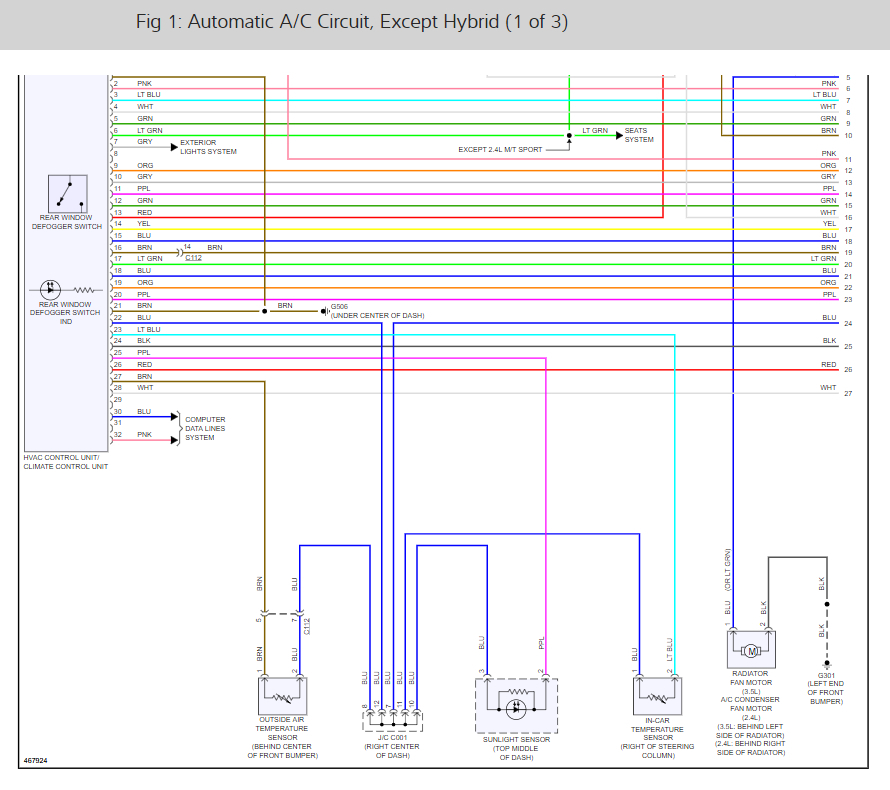

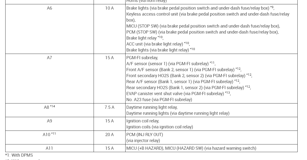

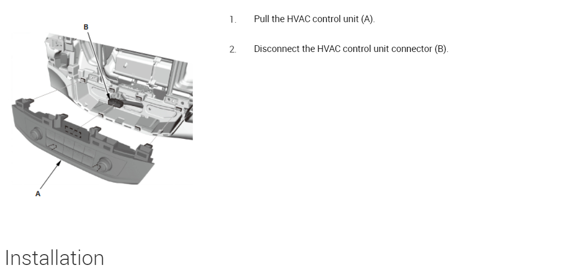

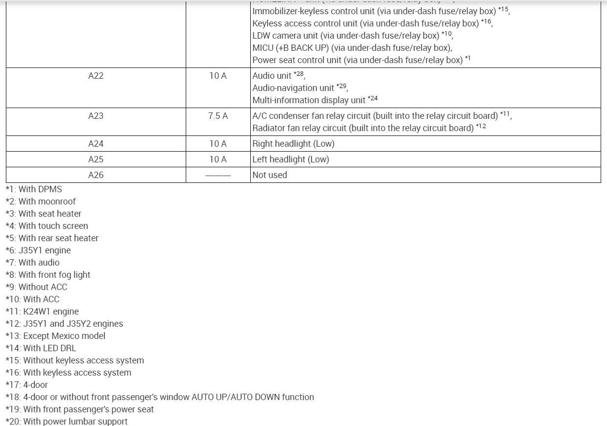

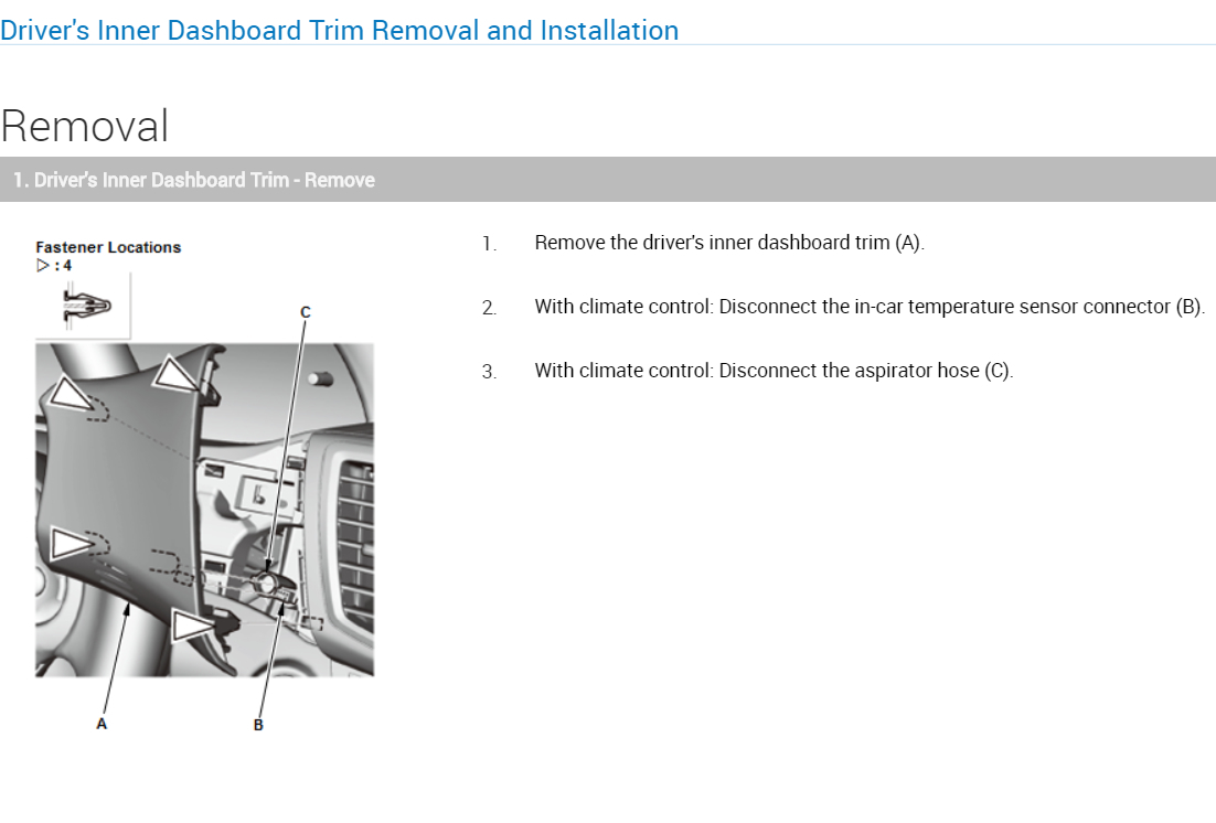

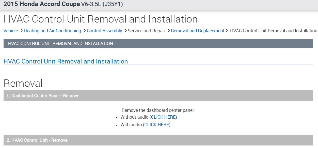

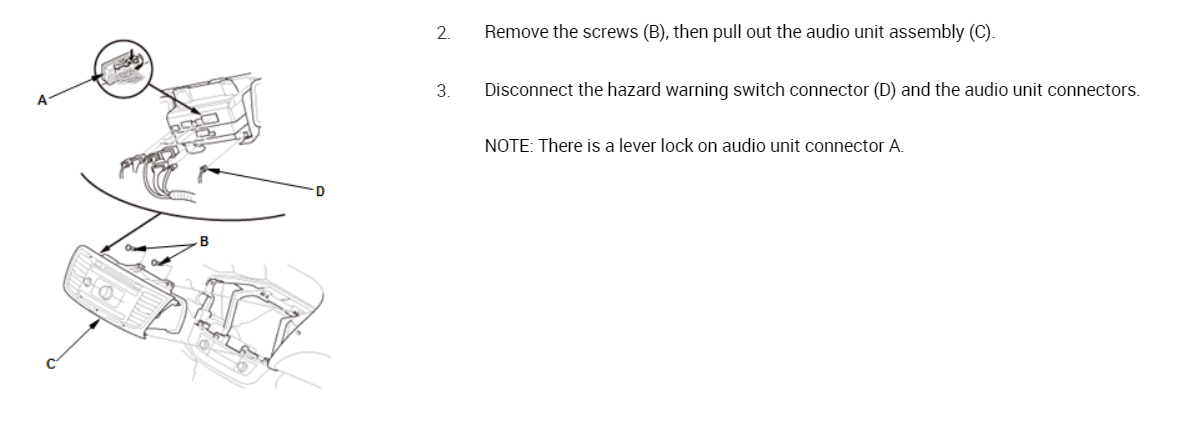

It sounds like the HVAC controller is going out and needs to cool before it will work again. To be sure here is a guide to check for power and signal to the fuses and relays with the air conditioner wiring diagrams so you can see how the system works:
Here is the fuse panel and relay locations and how to change out the HVAC controller. Check out the diagrams (below). Please let us know what you find. We are interested to see what it is.
Sep 12, 2019 at 10:56 AM

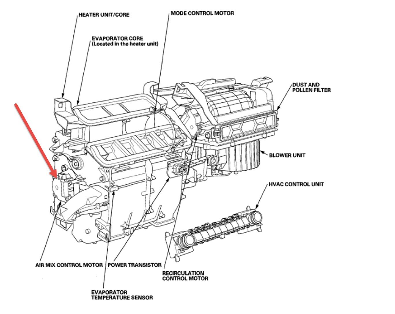

Hey guys i have a 08 honda accord v6 and the car had a bad clutch on the compressor. i had 12 volt going to it but it wouldnt turn on. I replaced the compressor with a aftermarket compressor, Compressor works is the brand, the put the new compressor in put the system into vacuum and leak tested good no problems, a friend has a robinair ac machine, charged the system to 15.9 oz which is what it calls for and the air only comes out at 60 degrees going down the road according to a thermometer we have in the vent. i added 4 oz of oil to the compressor before i put it in and my gauges readings are where they should be, when running low side is about 28 psi and high was around 200 i think it was. it was a hot day about 90 with humidity. any ideas why my ac is warm. when i gran the low side line under the hood, its cool but not cold with condensation on it like it should be. Could the aftermarket compressor not be working right? i am out of ideas. Thanks for the help

HMAC300
  • 48,601 POSTS
should be a pound low side shold be a little higher but check your temp actuator it may not be blocking heater all the way especially if suctionline is cold. see pic make sure it gets power and try pulling hvac fuse for 60 seconds with key on sometimes they reset otherwise it wil need to be scanned.
