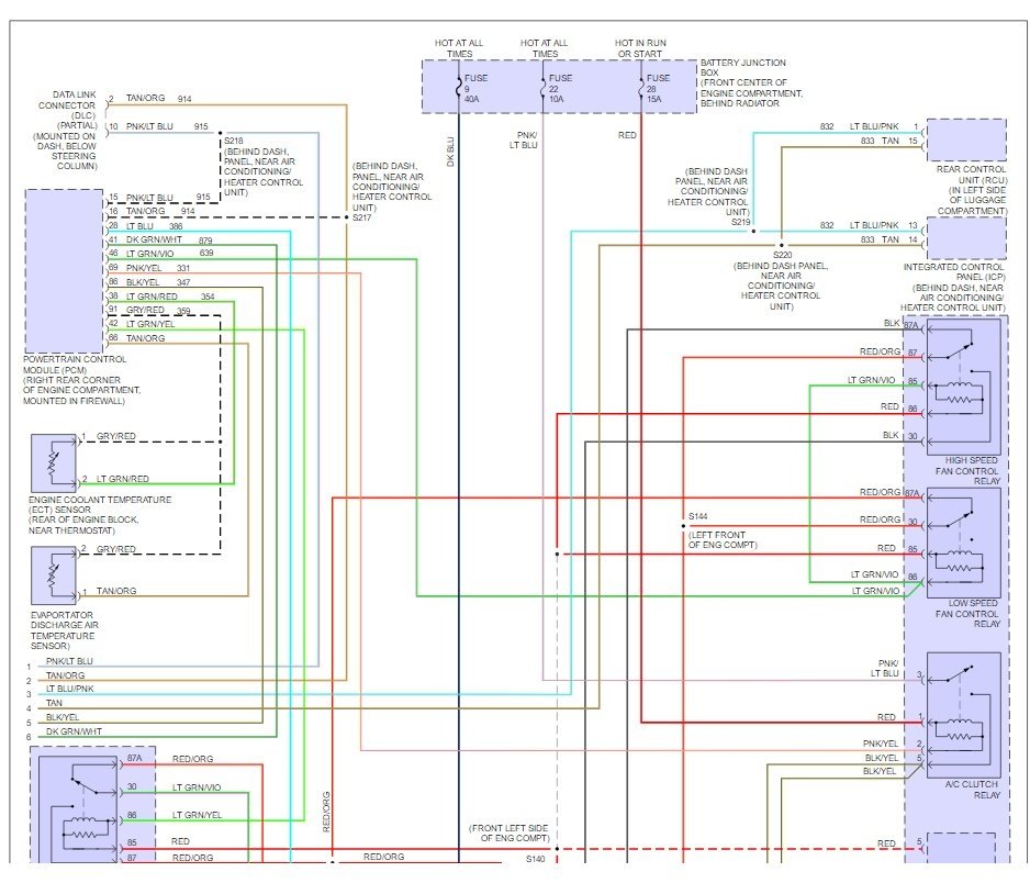

My A/C compressor is not coming on. I tried to charge the system, but the Freon will not go in. The system is reading full. Can the blend actuator prevent the compressor from working?

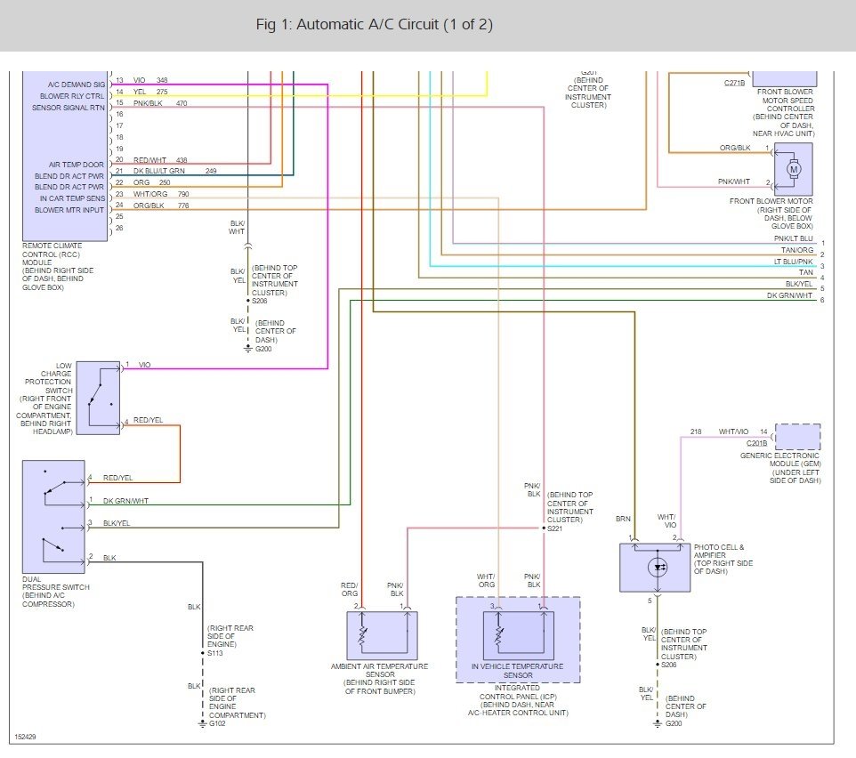

Not normally check fuse and relay in underhood fuse box then check pressure switch by evaporator those are most likely causes.

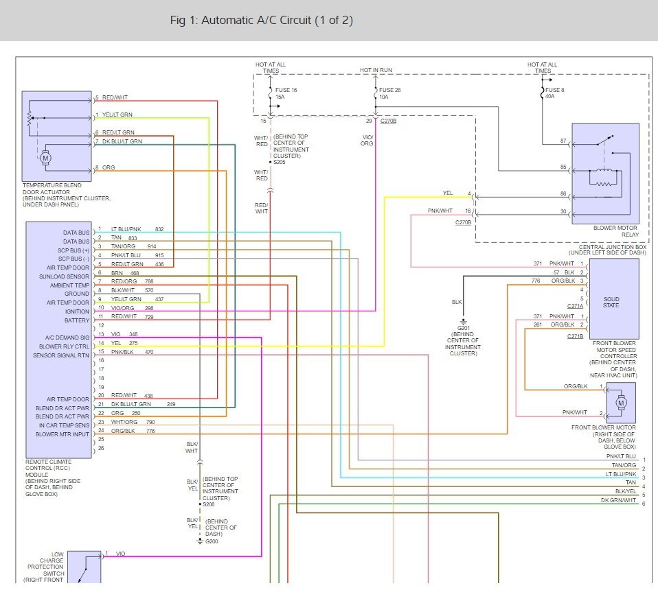

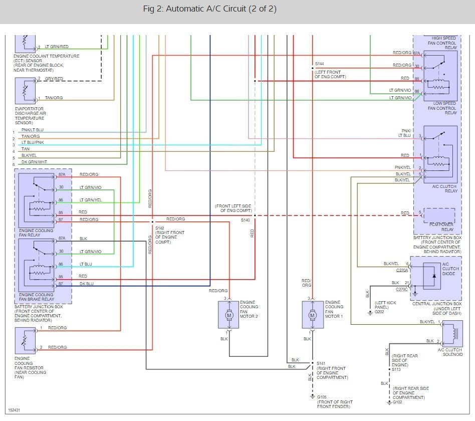

I have found the air conditioner wiring diagrams for you (below) Please follow this guide to check for power and to check the fuses.
and
and
Please run some tests and get back to us so we can continue helping you.
