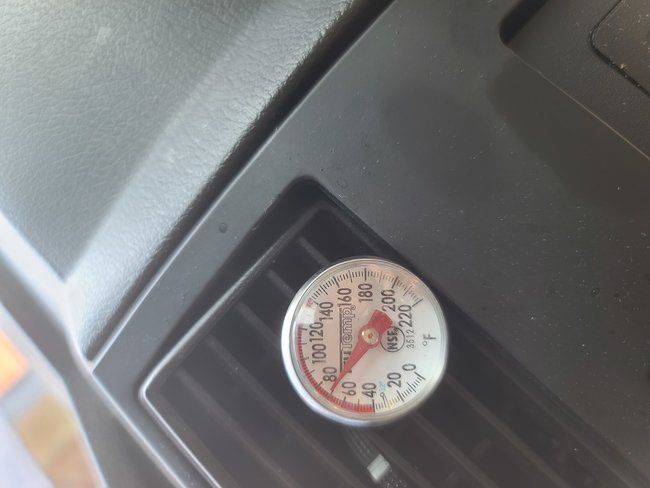

This is after fan on it and running about 8 to 10 minutes.
Thursday, July 9th, 2020 AT 2:17 PM

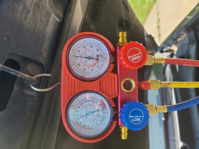

I vacuumed it down to -30 for 1 hour and made sure there was 6.5 oz of oil within the system.
Thursday, July 9th, 2020 AT 2:22 PM
XAVIER_COX
  • 34 POSTS
Is it normal for the gauge to fall that low when I rev my engine? I should note I put on a heavy duty condenser. But everything said it was compatible.
Thursday, July 9th, 2020 AT 2:25 PM
How much oil did you recover when you did the repairs?
The low side should be 25-30 pounds.

I see a connector on the A/C pipes looks like it might be a A/C pressure switch. Is this something to consider changing. Only 27 bucks. I'm not sure if I would need to discharge and recharge my A/C system to change that.
Thursday, July 9th, 2020 AT 2:59 PM
No, if it was bad the system would not work.
The low side is too high. That is the issue.
I am concerned there is too much oil in the freon system. You said you added 6 1/2 ounces and that is too much. That could be the issue.
You should have only added 3 ounces at the most.

No, I'm pretty sure the compressor was 4.2 oz already in it. And I added 3.3 oz Most of it went into the condenser and the rest into the yellow line when I recharged it.
Thursday, July 9th, 2020 AT 4:02 PM
Okay. Sounds about right.
If you take it on a nice drive, does the temperature go down?
Vent temperature should be 60% of the ambient temperature.
Thursday, July 9th, 2020 AT 4:11 PM
XAVIER_COX
  • 34 POSTS
Yes interstate driving can get it down to 45-50 degrees.
Thursday, July 9th, 2020 AT 4:17 PM
Okay, that is good.
Check the radiator and make sure there is no dirt or debris in the fins. It may be restricting air flow at idle and low RPM causing the temperature to rise.
