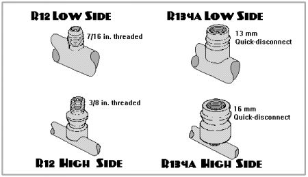

I have never charged the system after changing the engine in 1992. The components are all there, I replaced the seals, the o rings and cleaned out the drier and had the condensor coils dippped and rebuilt professionlly. How do I get by the low pressure switch and how do I know which port is the low pressure port?

Find the fittings/ports within the plumbing
https://images.2carpros.com/forum/automotive_pictures/12900_ac_service_fittings_20.jpg
