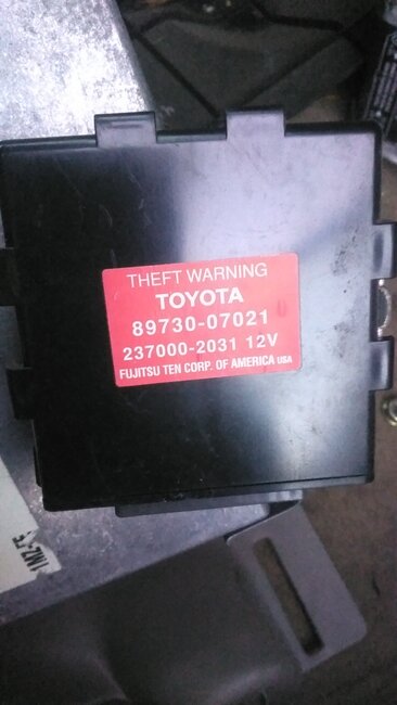

Anything with these two(2) units I should be concerned about?
Thursday, December 29th, 2022 AT 2:35 PM
CA7922303
  • 165 POSTS
Theft deterent module?

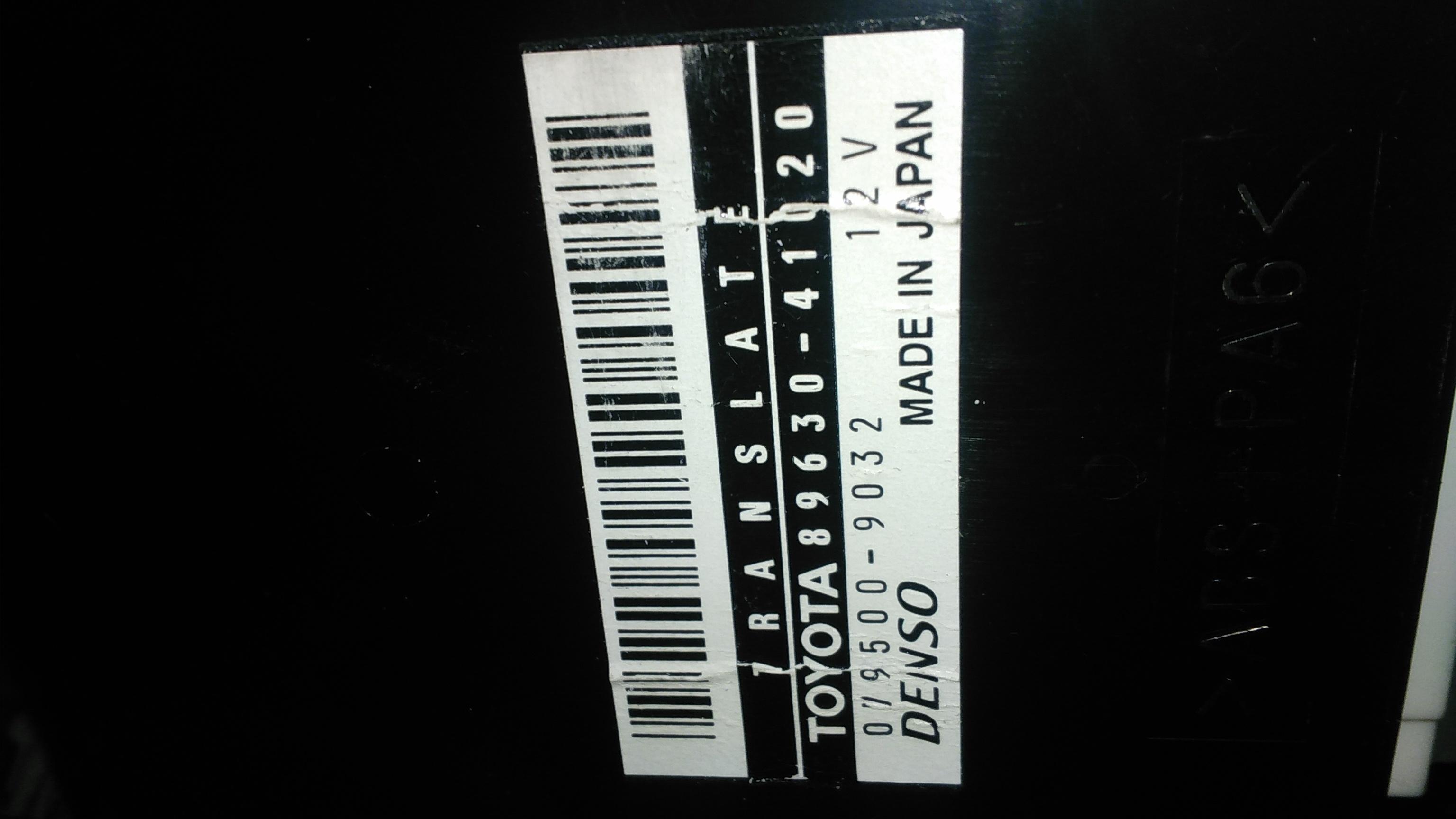

Got an ECU from pull a part and an ignition lock cylinder with key. Am I likely to have more luck with programming if I install the ignition lock cylinder w/key from junkyard? It's out of an 01 Avalon with same number as ECU from my 02?
Friday, December 30th, 2022 AT 11:35 AM
CA7922303
  • 165 POSTS

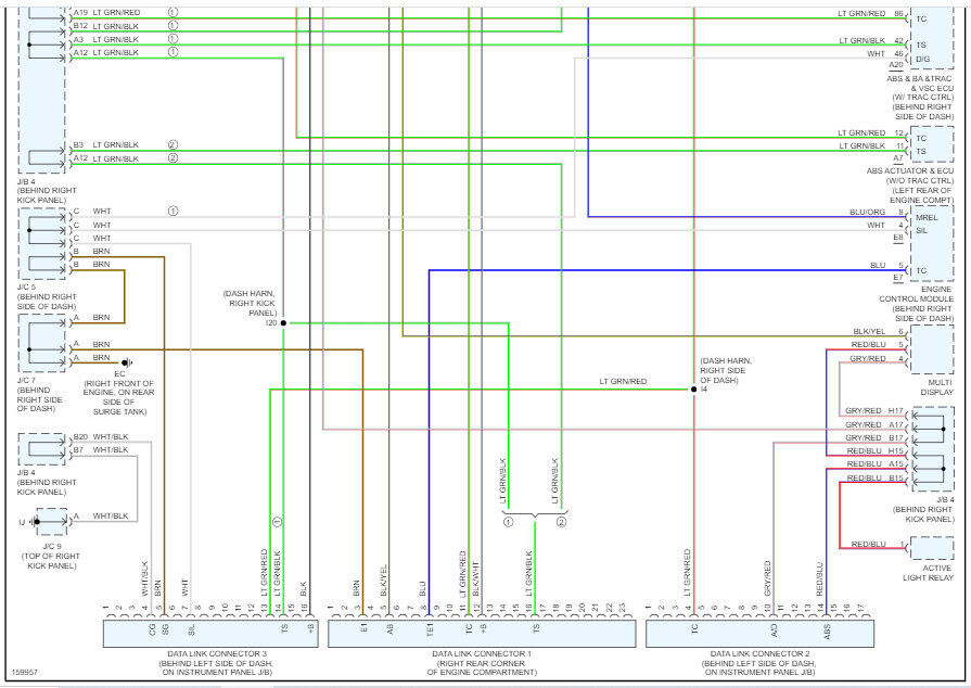

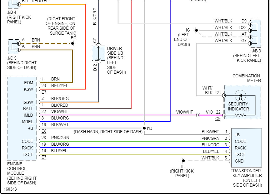

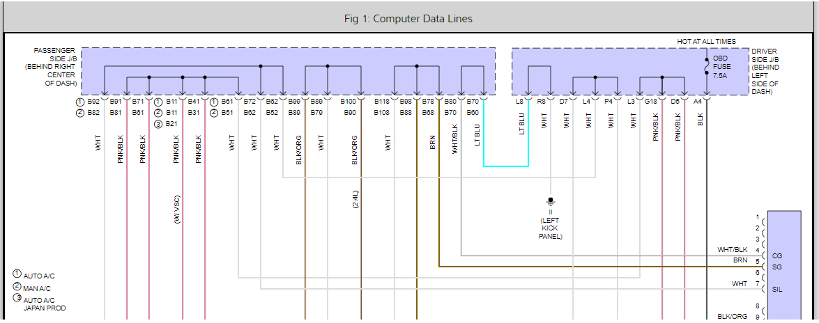

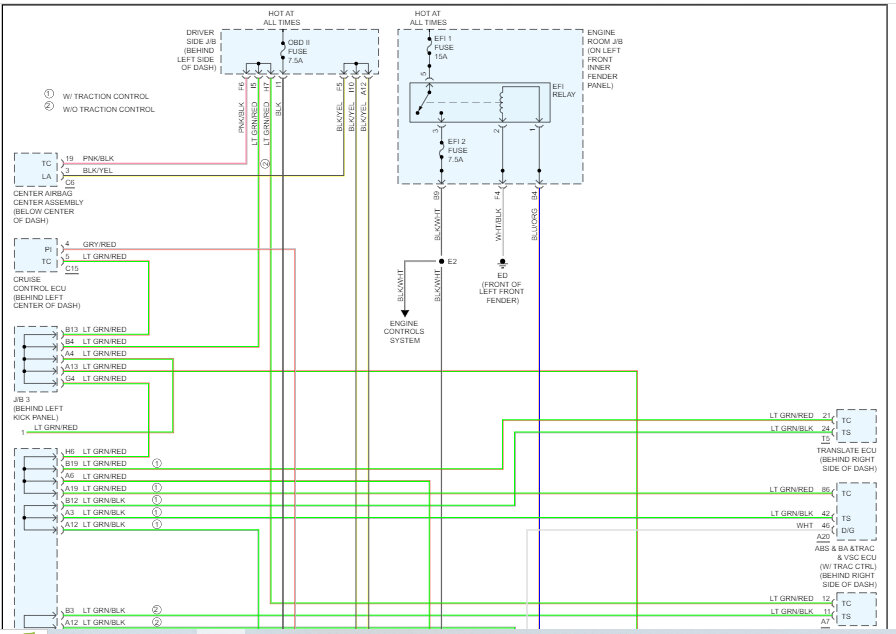

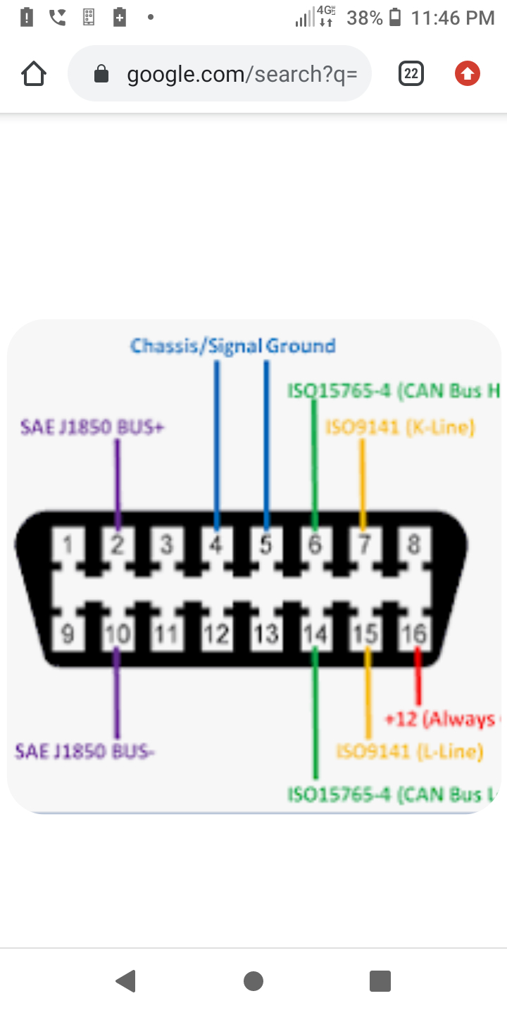

Disregard the questions about ECU and junkyard parts. Installed and no change. Have since found that obd ii connector pins 4-6(12v) and 6-14(12v). Are incorrect. 4-16(12v) is correct. Can you tell me how to find shorted can-bus? Thanks.
Saturday, December 31st, 2022 AT 6:00 PM
  • 110,192 POSTS
You shouldn't have power at pins 4 and 6. Pin 4 is a chassis ground and pin 6 on the schematic is blank Pin 14 is related to the traction control network and 16 is battery voltage. See the schematic below.
To locate the issues, you need a scanner that can communicate with the ECU. From there, you need to check for codes specific to the controller area network. That should point you in the right direction regarding the problem.
Note that the schematic below is the computer data lines.
Sunday, January 1st, 2023 AT 7:18 PM

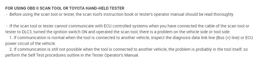

Am I looking for an ISO 9141 CAN-bus scan tool? Is that the correct information I need to find the right scan tool for 02 Avalon? Thanks.
Monday, January 2nd, 2023 AT 6:43 AM
  • 110,192 POSTS
Yes, to the scan tool. And, I am sorry, I mixed up the pin connectors on the DLC. You have the correct one. I was one-off when I looked at the schematic.

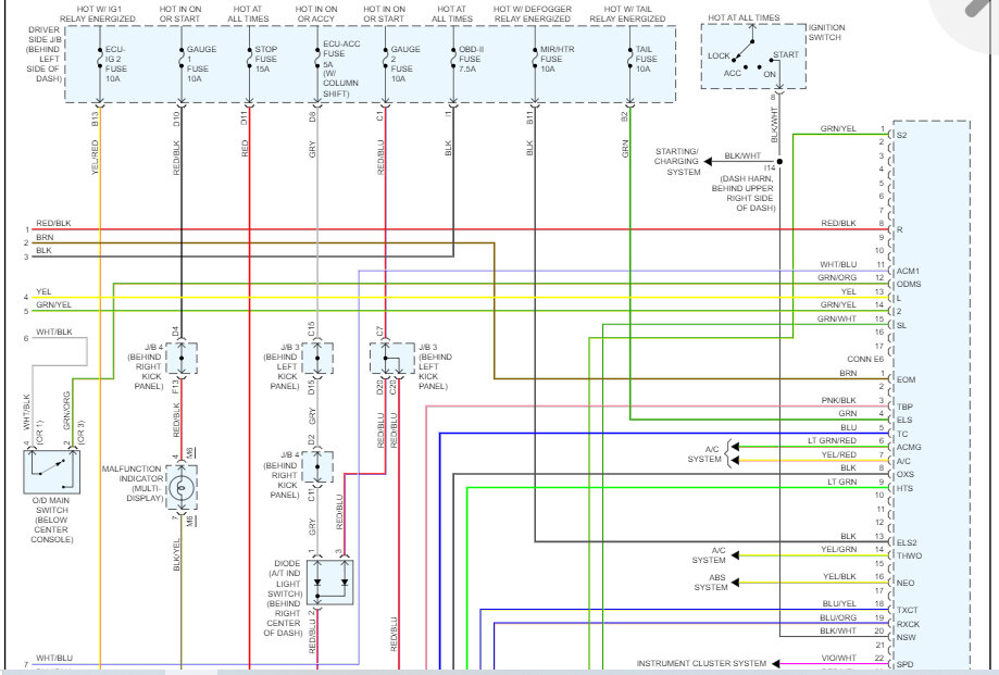

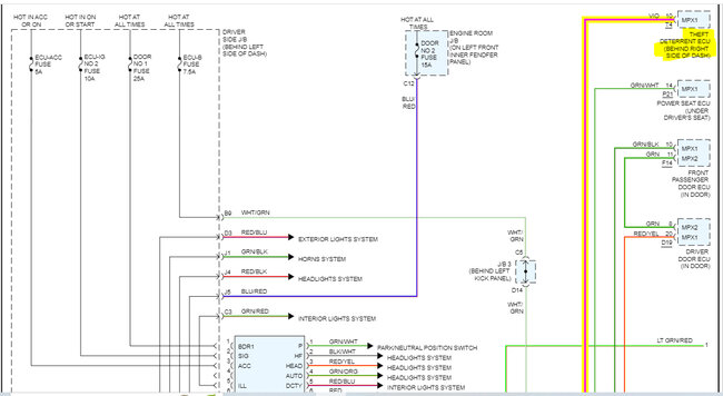

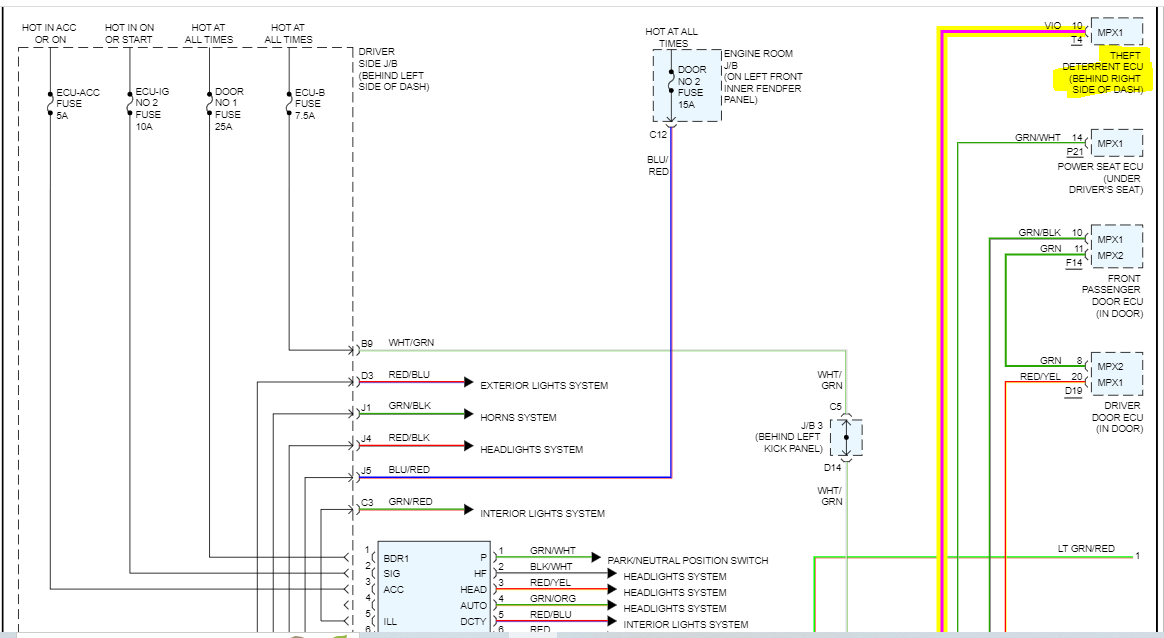

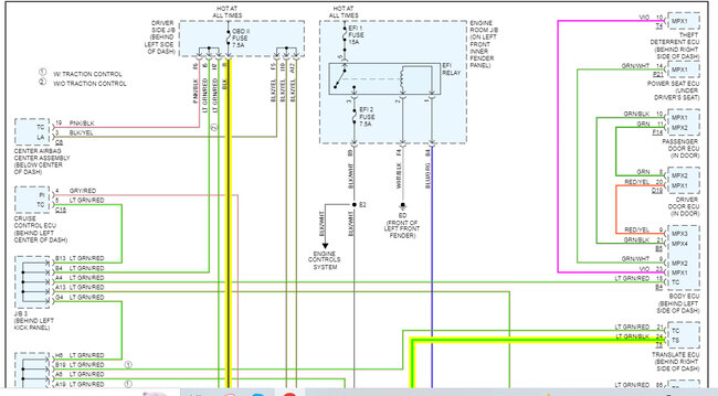

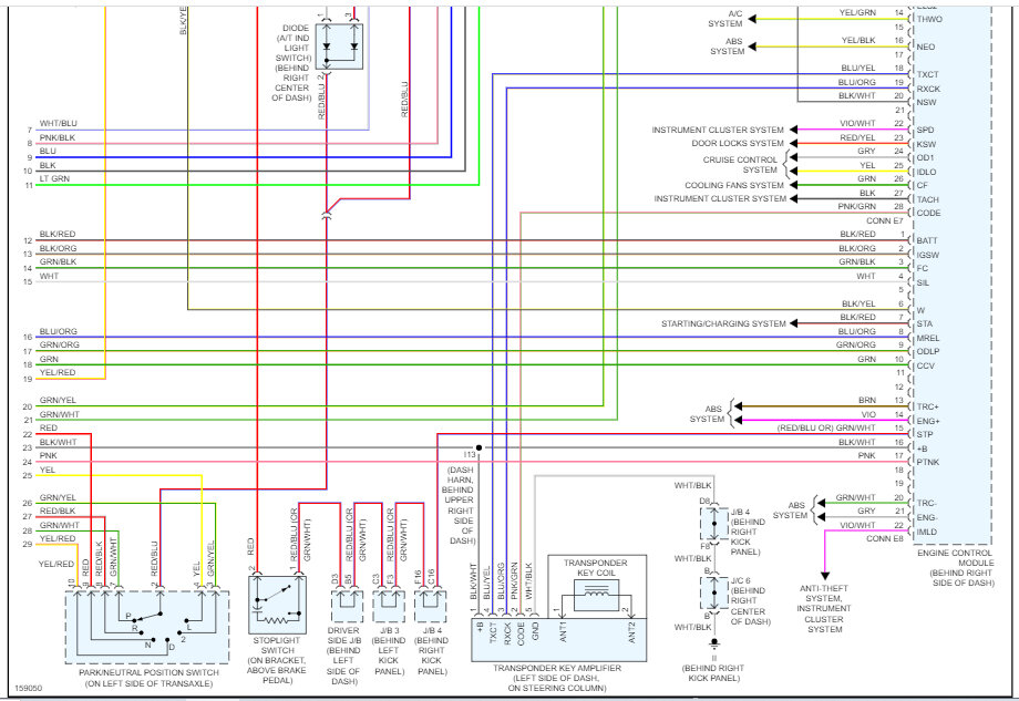

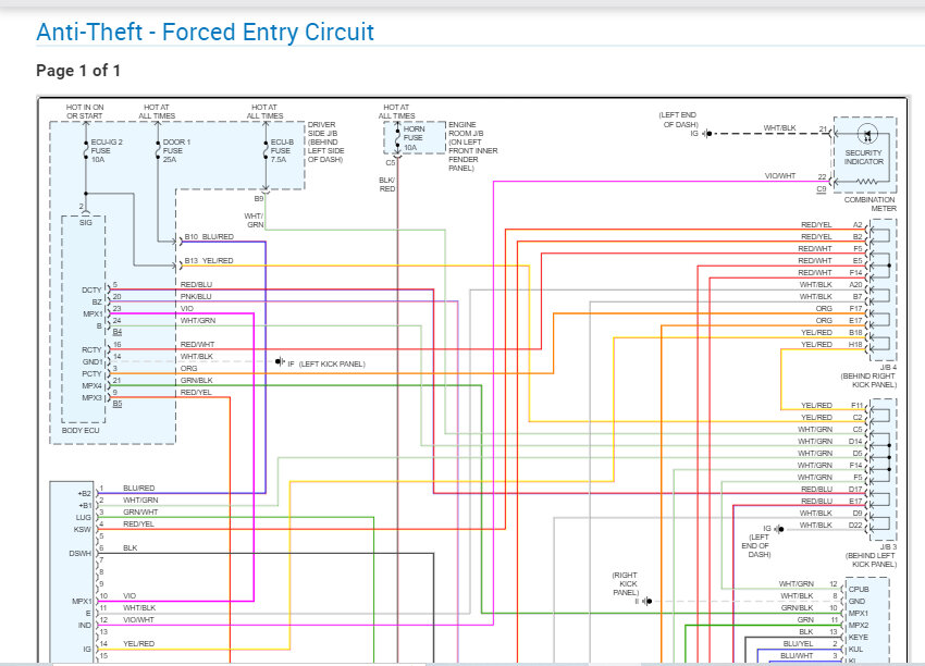

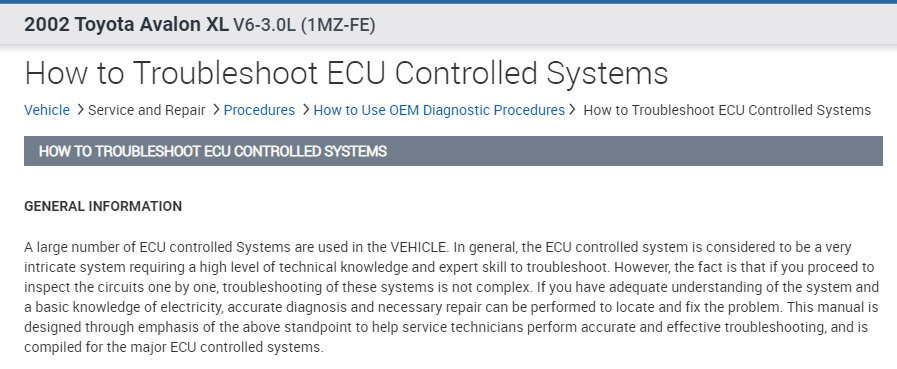

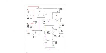

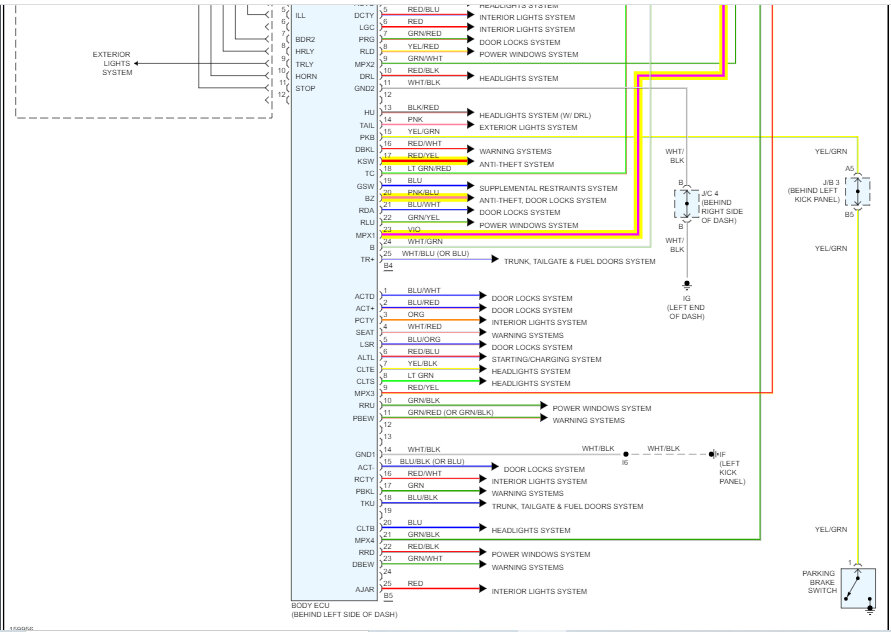

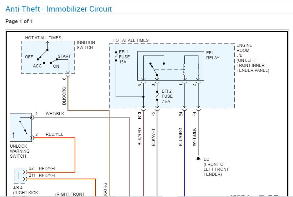

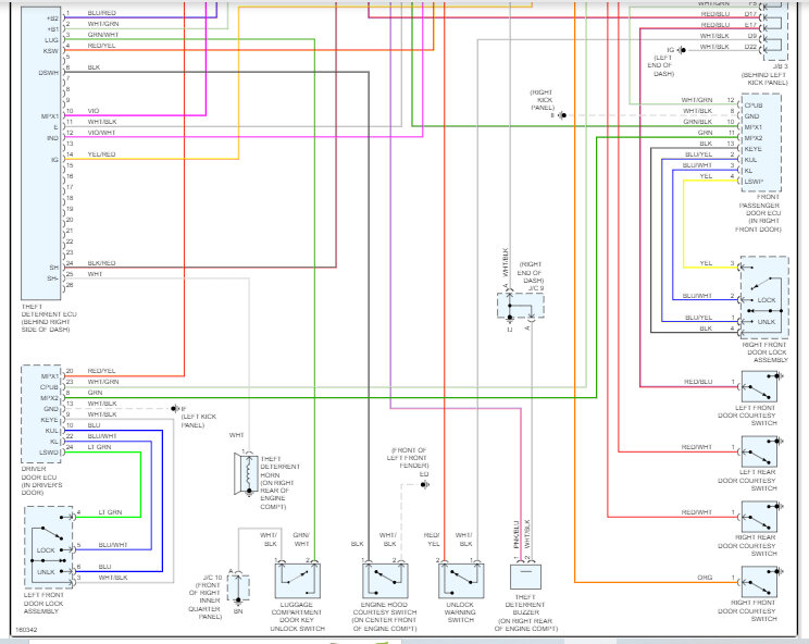

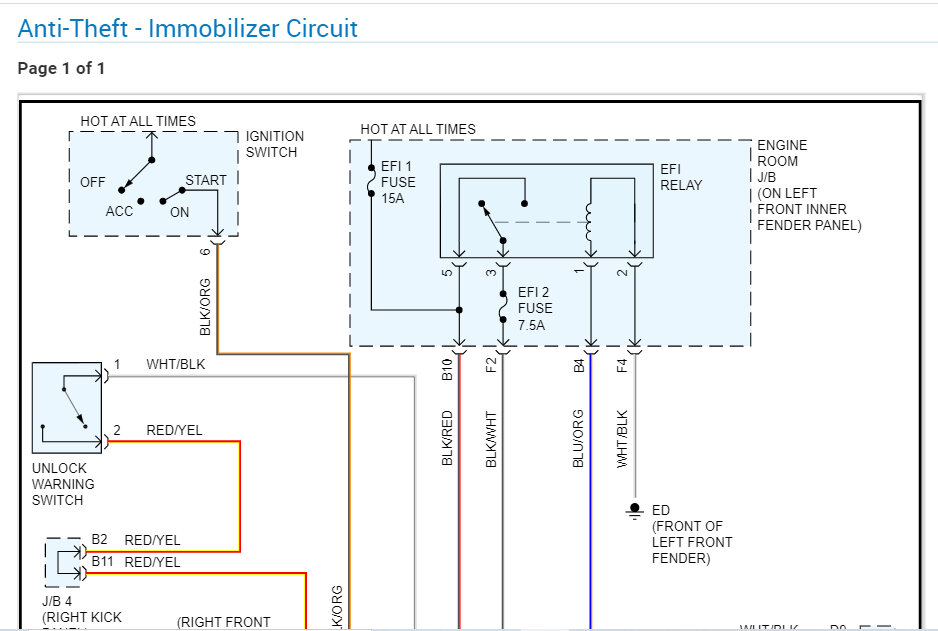

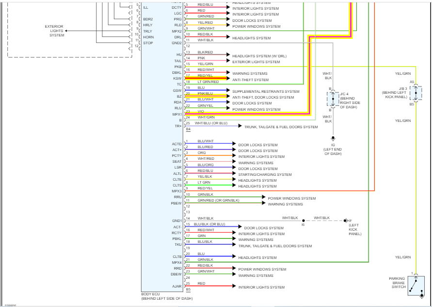

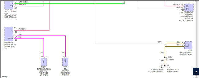

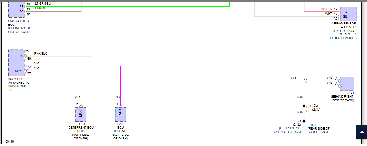

Do you have wiring diagrams with pin#s on connectors between BCM and Theft deterrent module? Everything else in this vehicle is working except for theft deterrent system. Don't have scan tool yet. Thanks.
Thursday, January 5th, 2023 AT 9:33 AM
  • 110,192 POSTS
I attached what I have for the BCM and theft deterrent. Take a look through them and let me know if that is what you need.
See pics below. Note: I had to cut each pic in half to make it readable for you. I did overlap them.
+1
Thursday, January 5th, 2023 AT 2:17 PM

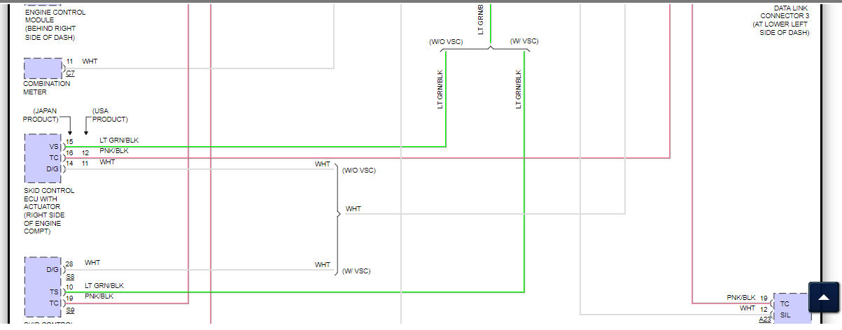

On the obd ii connector issue, this 02 Avalon XLS pin #6 is blank. It uses 4, 5, 7, 13, 14, 16 only. Does that change anything we are looking at? Which pins would be the CAN HI and CAN LO. Which pins would I be looking to get (60 ohms) resistance out of. Would CAN HI be about (2.7v) and CAN LO be about(2.3v)? Thanks.

Of the junkyard parts I tried on this car (ECU, BCM, transponder coil ring, ignition cylinder lock w/key, and Theft deterrent module), I swapped everything back to the original exception for the BCM. Is the BCM not being original with all the other parts going to know also stop it from recognizing the transponder key?
Friday, January 6th, 2023 AT 2:04 PM
CA7922303
  • 165 POSTS
In your opinion, can a battery going dead in an 02 Toyota Avalon XLS cause ECU to need to be reprogrammed to the transponder key? Thanks.
Friday, January 6th, 2023 AT 2:12 PM

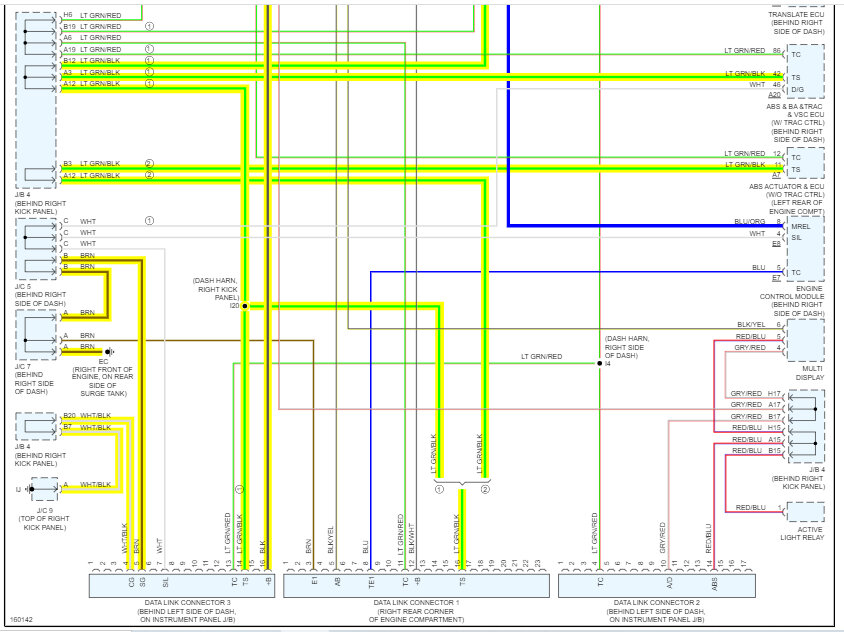

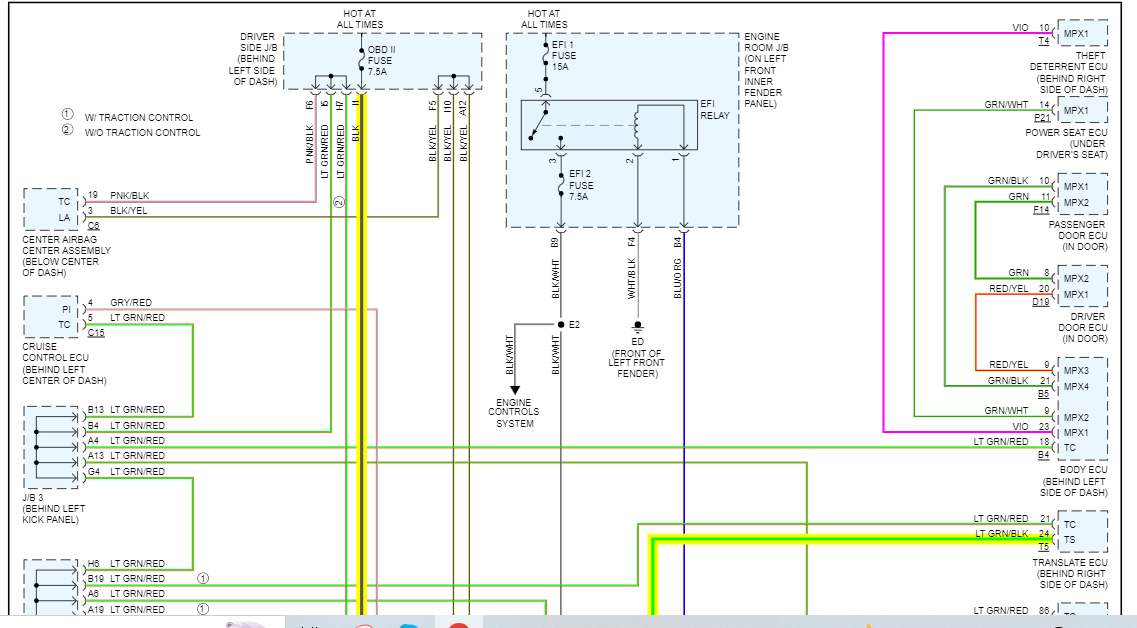

  • 110,192 POSTS
If you are using a different BCM, it needs to be programmed to recognize the key. I attached a schematic below from Prodemand for the DLC and computer data line configuration.
Let me know if this helps.
See pics below. Also, I had to cut the pic into four parts to make it readable.
Friday, January 6th, 2023 AT 10:14 PM

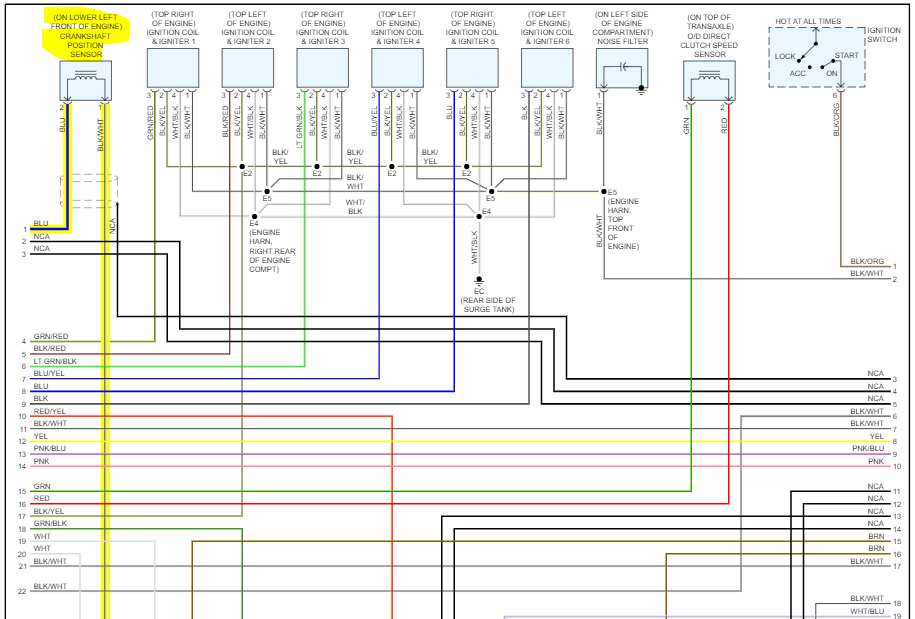

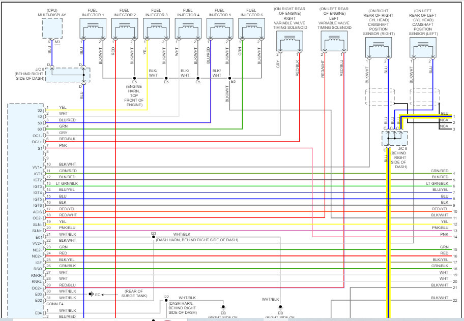

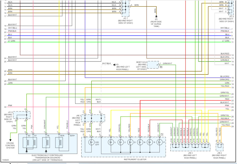

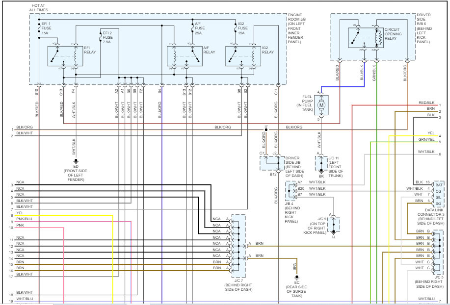

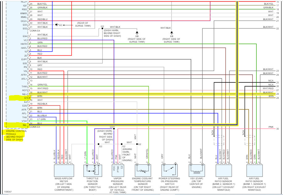

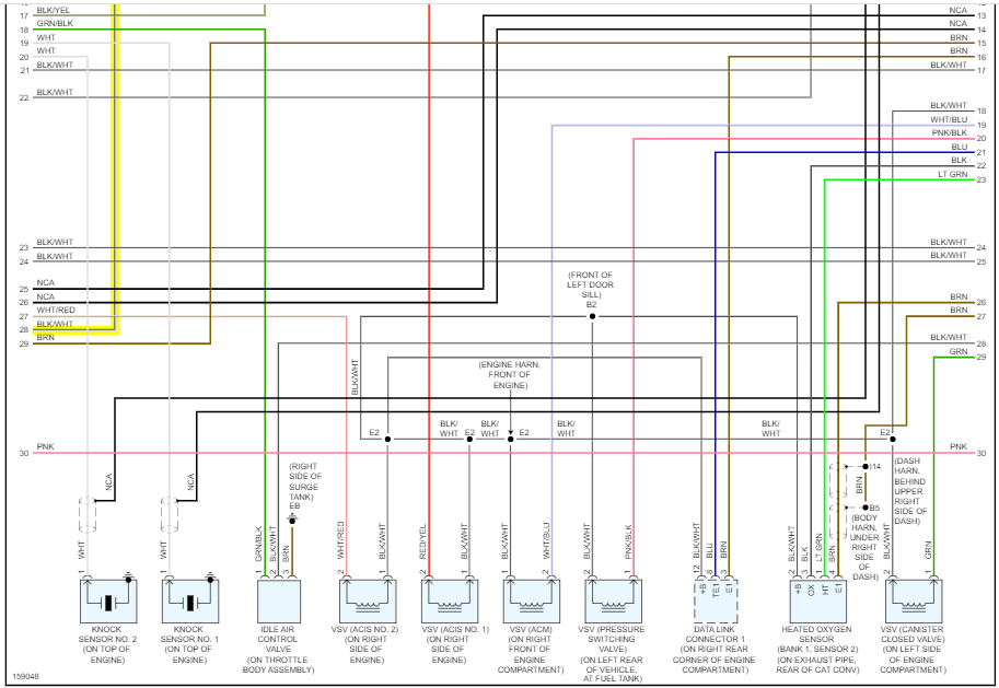

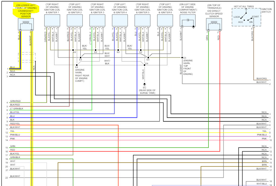

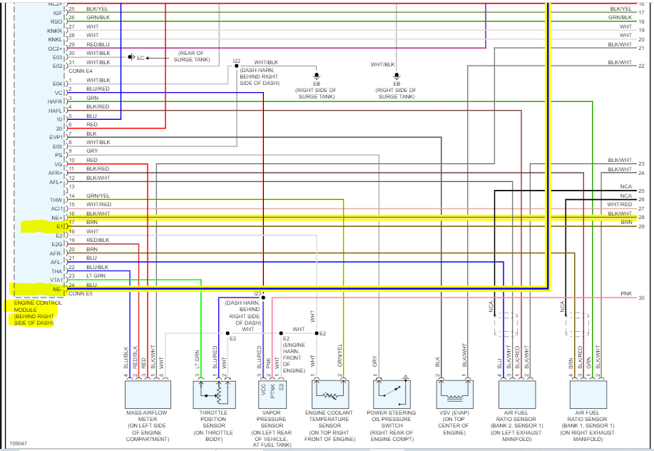

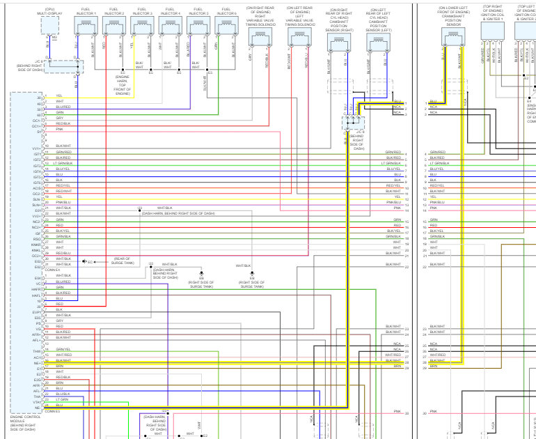

Strangely, I reinstalled the junkyard 01 Avalon ECU, BCM, ignition lock cylinder with key and left the transponder amplifier and theft deterrent module connectors unplugged because the 01 Avalon I got them off of did not have a Theft deterrent module or a transponder coil ring wired to an amplifier (no amplifier). Jumped obd ii pins 4 & 13 for 30 minutes and engine ran for 3 seconds then cut off and not restarting. Curious what your thoughts would be about that and do you have a diagram that would show the ckp sensor wiring going to what pins on the ECU so I can check that wiring for continuity? Thanks.
Tuesday, January 10th, 2023 AT 1:04 PM
CA7922303
  • 165 POSTS

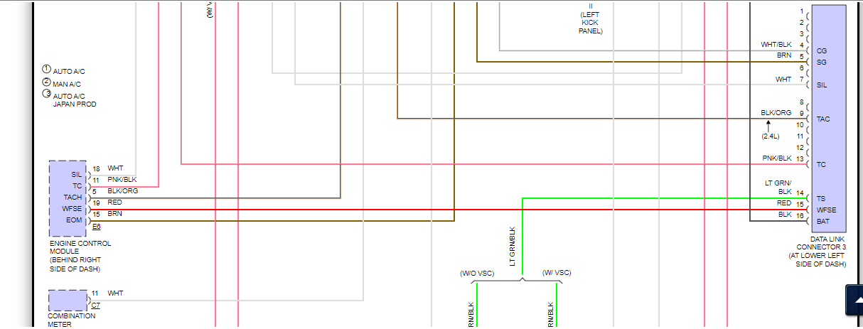

Also, tachometer has no movement with either ECU or BCM installed, that's why I'm asking about the ckp sensor wiring? Thanks.
Tuesday, January 10th, 2023 AT 1:40 PM

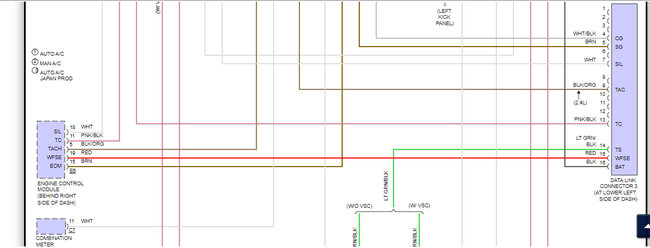

  • 110,192 POSTS
If you look below, I attached the entire powertrain management schematic. I highlighted the wiring between the CKP and ECM. I had to cut each pic in half to make them readable, but if you look at the last pic, I combined two pages so you can easily see the wiring path. I just hope it is readable for you.
joe
