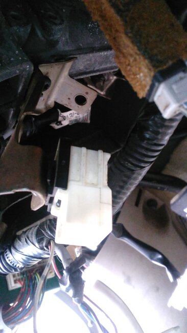

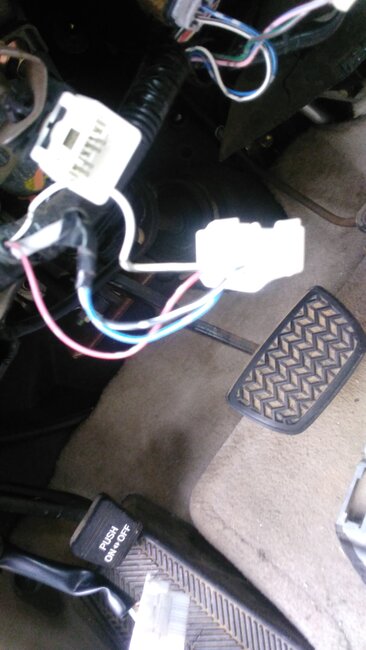

I believe this vehicle had an interlock device in it at one time. Anything I could do here to bypass immobilizer. Connector(photo) plugs into female plug that ends(no wires)?

It can't be bypassed. You can reset the immobilizer to recognize the key. That will require dealer-level computers/scan tools.

Installed a junkyard immobilizer amplifier from a 02 Avalon. Security light now stays off with key installed and also when cranking, but still no start. Previous 01 Avalon that I got parts from did not have an immobilizer or amplifier from the factory. Must have started that in 02 because the 01 was also an XLS like the 02 I have. Picked up another ECU and theft deterrent module when I returned the 01 Avalon parts and will install and attempt to start. Will post results shortly.

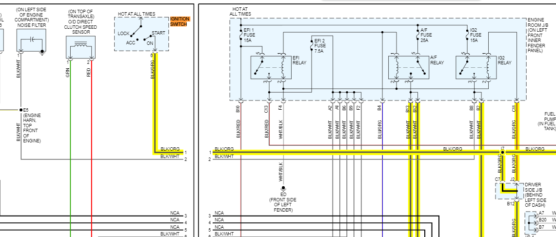

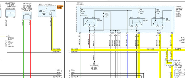

Looking at the schematic, at the ignition switch, there is a black wire with an orange tracer. That supplies power to the ignition 2 relay and the circuit open relay. I wonder if you lose power when the key returns to the run position.
Are you able to check that?
See pic below. Ignore all the highlighting. I was following things all over the place. LOL

Will have to check the tachometer tomorrow (Saturday) in the daylight. Am I looking for battery voltage at the black/orange wire?

Yes, that wire should send power with the key in the start position and the run position.

The tachometer does move when the engine starts for a split second. Black /orange wire at ignition switch getting 12.5v with key on, 10.5v when cranking. Engine does not turn off when key is released, it turns off when key is in cranking position, but immediately starts each time the key is cycled, for a split second (with tachometer movement), then turns off.
