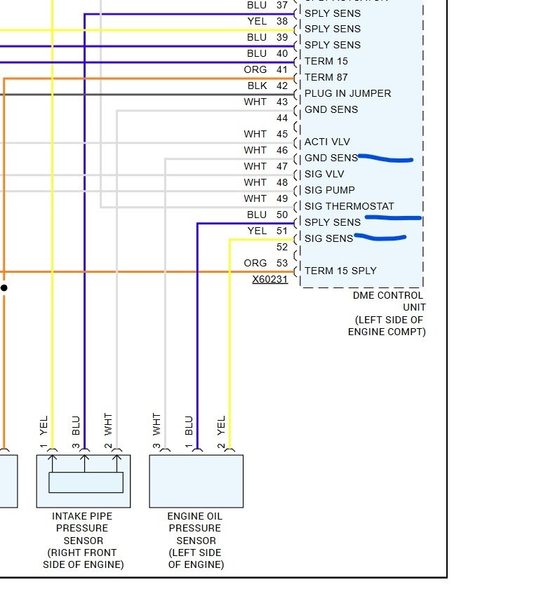

Car is strange. I changed the PCV diaphragm. Anytime I start it either ton of white smoke from exhaust for a while, or bluish when left idling for an hour. No antifreeze smell. Sometimes I start it and there is zero smoke. Oil is clean. Oil pressure light doesn't always come on. I will check the connector again. How does the light work? Does it have 2 pins and jumping it can confirm all is working from ECU is light does not come on? I want to make sure if it is a pressure issue or a ppm issue.

It has 3 wires. Power Ground and Signal to the ECM. White is Ground, blue is power, and yellow is the sensor signal to the ECM.

So help me understand. When the pressure is normal the sensor wires are grounded? And when it senses low or high oil pressure signal is sent out and the ground gets cancelled?

I tested the wires with ignition on and all show power (+).

The sensor is a variable resistance that changes the output voltage on the sense feed. One should be a ground; one should be power and the last should change as the oil pressure changes. It isn't a simple On Off style switch.
Wednesday, December 18th, 2024 AT 2:35 PM
BHAMDOC1973
  • 2,018 POSTS
All of them have power, none have ground. Ugh
Wednesday, December 18th, 2024 AT 3:06 PM
STEVE W.
  • 15,671 POSTS
White should be a ground, blue wire should be power. The yellow should vary with oil pressure.
Wednesday, December 18th, 2024 AT 3:09 PM
BHAMDOC1973
  • 2,018 POSTS
Yes I know. But I tested it with the probe and that is not the case. Every one of them has battery power, none are ground.
Wednesday, December 18th, 2024 AT 3:12 PM
STEVE W.
  • 15,671 POSTS
Then the ECU has a problem. I would look at the grounds to it to see if a bad ground is causing the problem.
