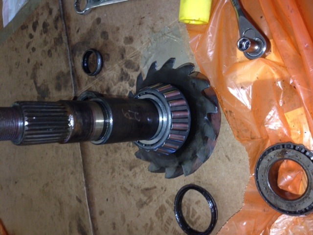

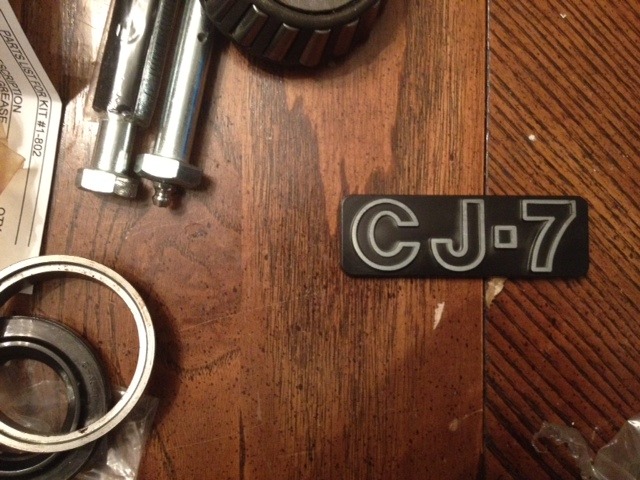

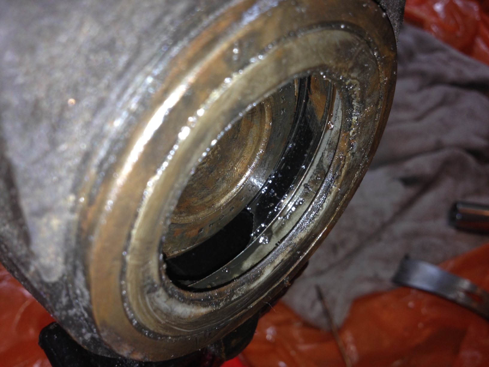

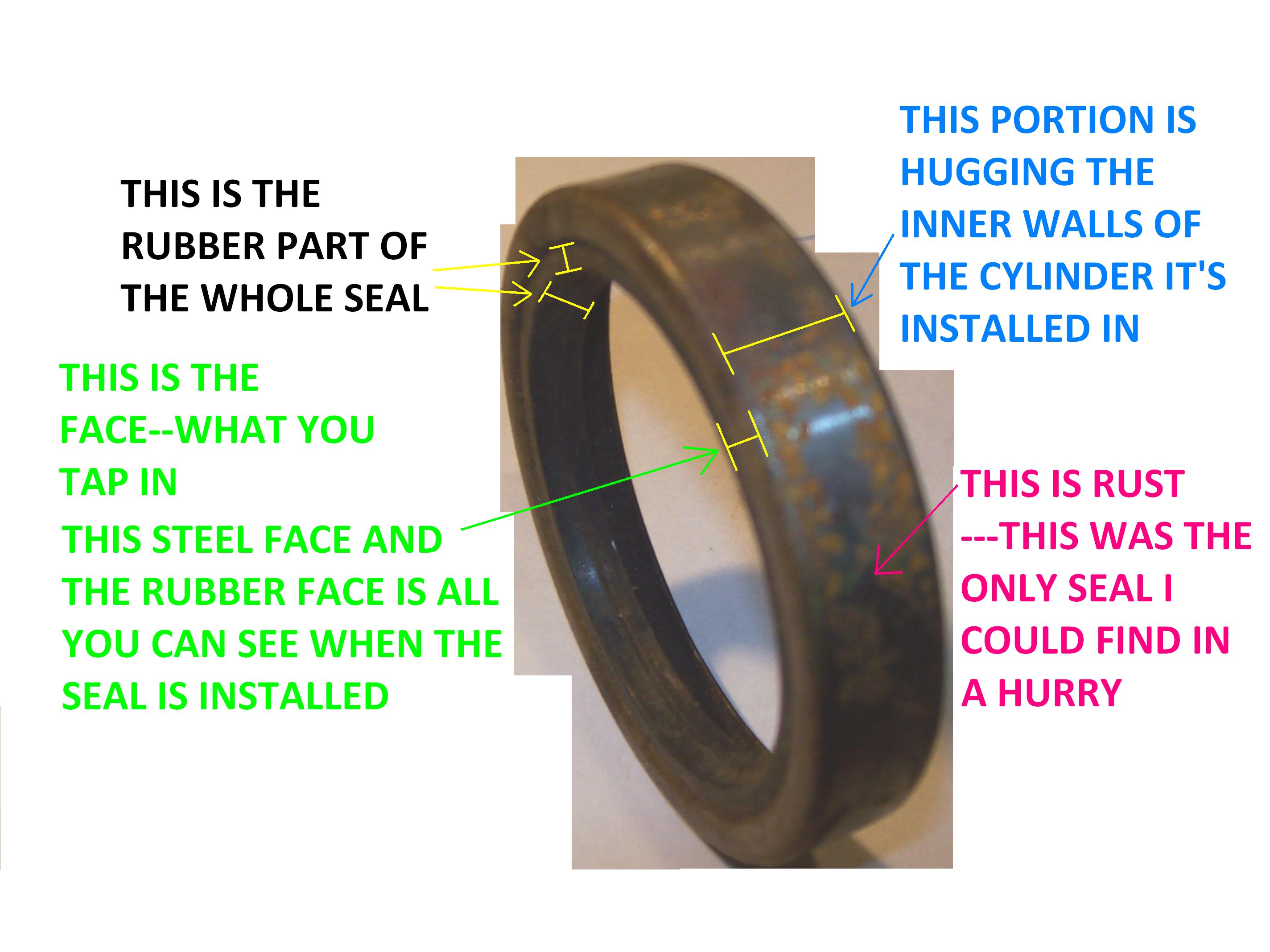

That outer ring just turned out to be the pinion oil seal. I thought I had already removed it but turns out I just pried the rubber inside of the seal out. Axle disassembly is finished. I'm waiting on my shims, bearings, crush sleeve, pinion nut, and marking compound to come in the mail. In the mean time I'll clean up the axle housing and repaint it. My plan is to only replace the bearings on the pinion. The carrier bearings look fine and that's one less thing I have to buy or press. I'll shave off the inside of the old bearings so they slip on and off real easy. That should make it a lot easier as I move the shims around while setting up the gears.
Got any ideas how to get the bearing off of the pinion? Or how to get the races out of the housing? See pic below. I can probably find access to a press if I need one.
Here's a great site I found on how to set up gears. They have lots of other stuff on there too. Very detailed and informative.
Jul 18, 2012 at 3:03 PM
HANG EM HI
  • 71 POSTS
Found the bearings for my one piece axles: http://www.quadratec.com/products/52401_100.htm
The tech online said that both bearing race openings should face towards the differential. That means that not only did Joe-shmoe forget to preload the pinion, but he also installed one of the wheel bearings backwards. Also, it's stupid of me not to replace the carrier bearings so I went ahead and ordered all new bearings for everything back there.

YOUR FORWARD BEARING SHOULD SLIP OFF AND ON
YOUR REAR ONE WILL PRESS ON AND REMAIN THERE
THERE ARE SHIMS UNDER THE REAR RACE---THESE ARE FOR THE DEPTH ADJUSTMENT
YOU SAID "SHAVE THE OLD BEARING"---I DON'T SEE THE NEED, THE OLD BEARING IS WORN....YOU NEED TO DO ALL OF YOUR "SETTING UP" WITH THE NEW BEARINGS, THEY WILL BE WHAT STAYS INSIDE WHEN YOU ARE DONE

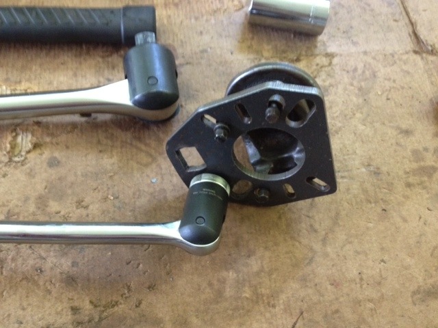

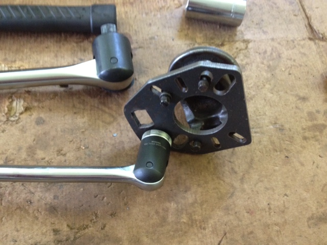

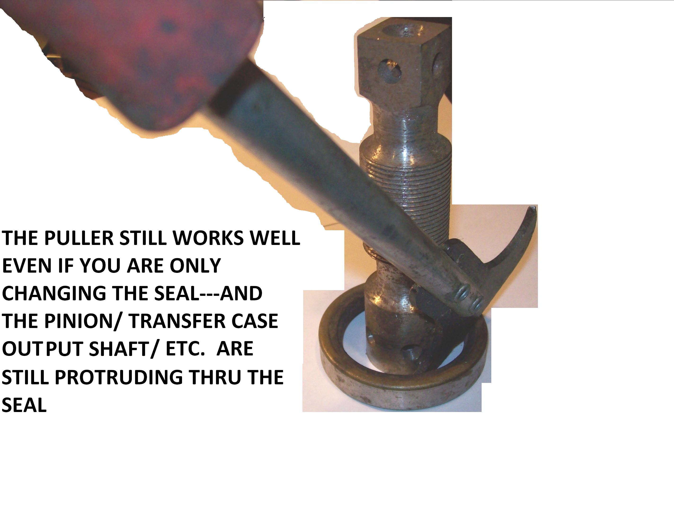

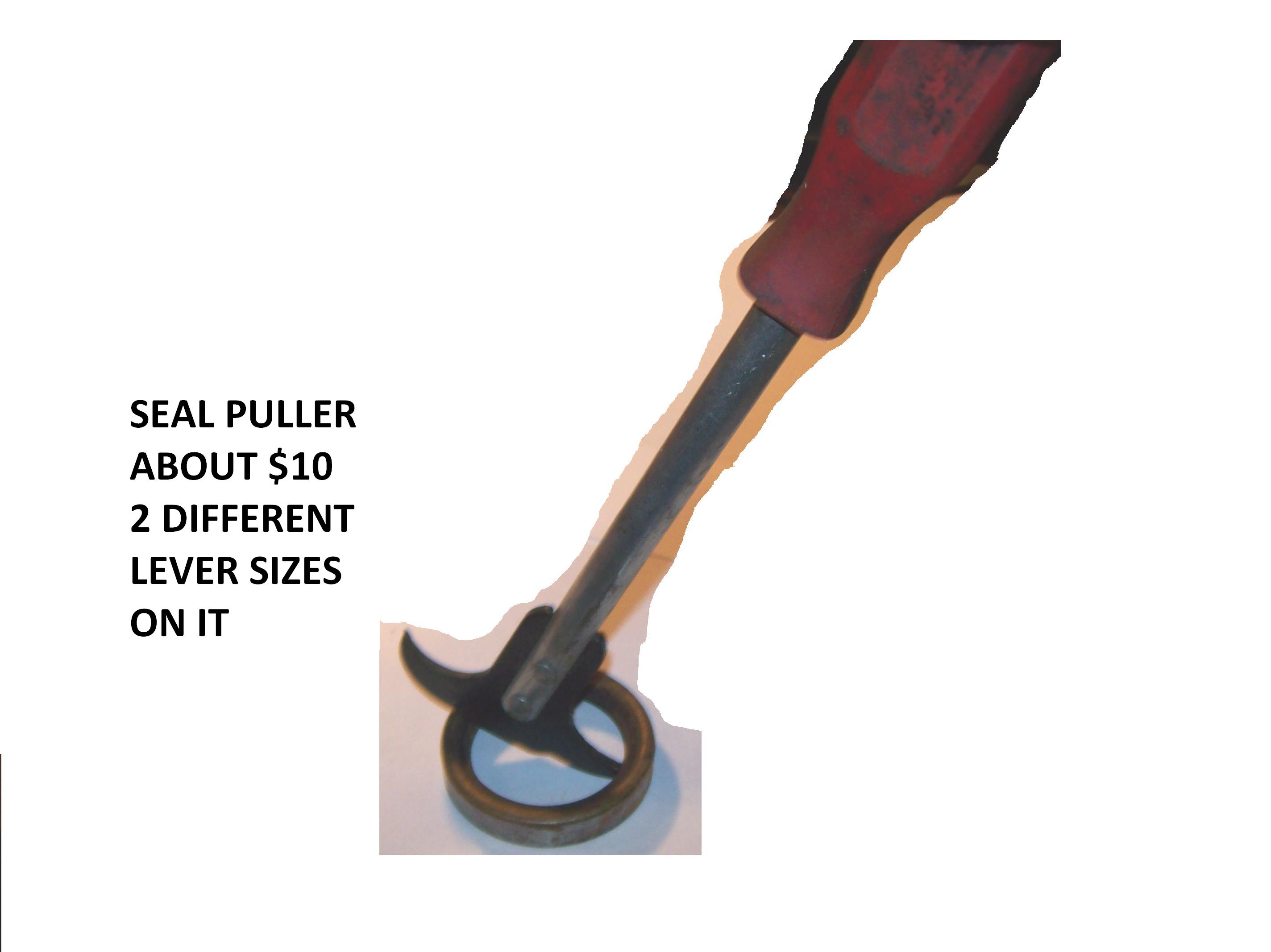

HERE'S THE COLLAR----THE CHICKEN FOOT PIECE CAN BE A STEERING WHEEL PULLER OR A HARMONIC BALANCER PULLER
"HARBOR FREIGHT" WILL HAVE A CHEAP CHINESE VERSION OF BOTH TOOLS

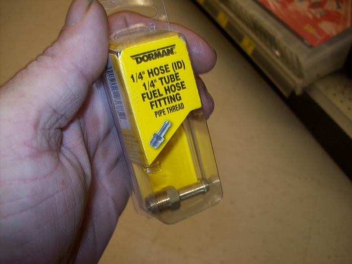

THIS IS SORTA WHAT I WAS TALKING ABOUT....AT ADVANCE AUTO
THIS ONE JUST HAS ONE "RIB" ON THE END (WHICH IS FINE!)
THE BARBED ONE HAS MULTIPLE RIBS IN THE N.IPPLE
THIS IS A TAPERED (PLUMBING THREAD)

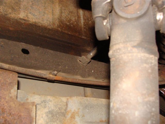

I BELIEVE YOU SAID THE N.IPPLE ON THE "LIQUID CHECK VALVE WAS BROKE OFF
IF YOU WILL CUT IT OFF FLUSH (A HACKSAW BLADE WILL WORK)
THEN SELECT A DRILL BIT ABOUT THE SAME SIZE AS THE "TIP" OF THIS FUEL FITTING (REMEMBER IT'S TAPERED, THE TIP OF THE THREADS IS THE SMALLEST PART)
JUST BARELY DRILL INTO THE PLASTIC AS NOT TO DRILL INTO THE GUTS OF THE CHECK
IF YOU WILL HEAT THE BRASS FITTING (JUST ENOUGH TO BEGIN MELTING THE PLASTIC---TEST WITH THE PIECE YOU CHOPPED OFF), YOU SHOULD BE ABLE TO MAKE YOUR OWN THREADS ON THE PLASTIC, SCREWING THE FITTING IN. YOU NEED ONLY JUST "THREAD" JUST INTO THE BODY
LET IT COOL IN THE PLASTIC---SPRAYING IT WITH WATER WILL COOL IT IT FASTER
GO TO THE KNOWLEDGE BASE...I THINK THERE IS A CT AWAY VIEW SO YOU WILL KNOW WHAT THE INNARDS LOOK LIKE
THIS DOES NOT REALLY HAVE PRESSURE ON IT---YOU JUST DON'T WANT SLOSHING FUEL TO GET OUT

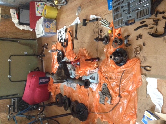

Sorry I've been MIA for a while. It's because I've been working on this sucker, and am making some decent headway. I had no idea how hard it was to pull/push bearings and races. The amount of force I've had to put on this axle...well...let's just say I might owe someone a new floor.
I'm finally starting the gear setup. This is going to take a lot of time since it's the most involved part of the rebuild and also the most fine tuned. Tried twice today, and both times the markings on the gears (see photo) weren't centered on the gear tooth. I'm getting there though. First time the marks were too high, coast side towards the toe and drive side towards the heal. Second time, exactly oposite but not so bad. Third time's the charm I think. I'll keep you posted.

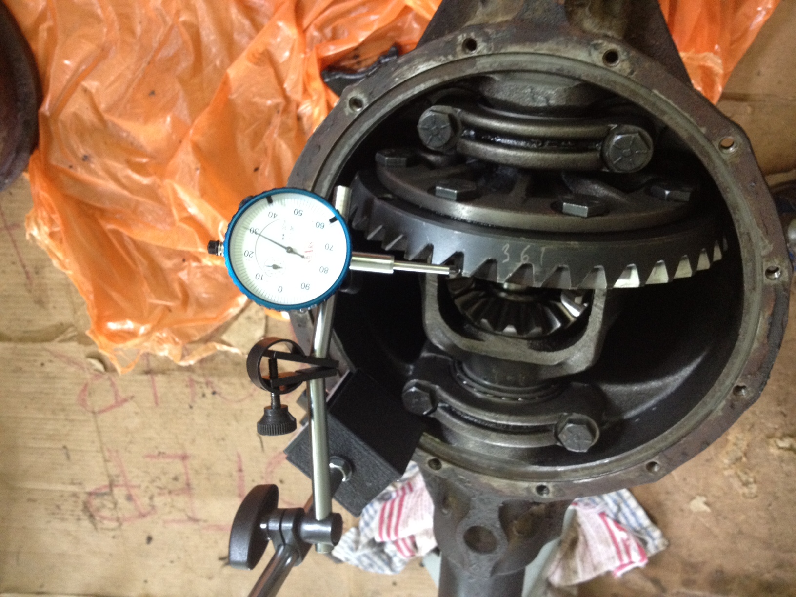

It wasn't too hard to figure out which shims to use on the carrier. I just split them 50-50 at first. Measuring backlash isn't that hard to do. I did end up having to reduce the number of overall shims from the carrier stack. Everytime I would put the carrier in place, it would warp at least two or three of the shims because it was such a tight fit. Removed maybe 0.008'' of shims and it fit in there great. No warps but still plenty of preload. The new bearings I installed might be a little bit larger than the old ones I guess.

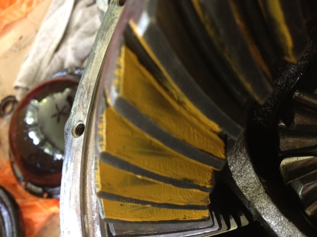

One thing to note, everytime you change your pinion depth, the backlash changes too. I forgot about this the second time I set the gear up, and there was so little backlash that the gears wouldn't even turn. If someone is ever doing this setup, I also recommend having plenty of crush sleeves. I've already burned through half of the sleeves I bought and am hoping I don't have to buy more.
Also a super import factors is that, when you're checking the gear marking compound like in the previous photo, you HAVE to load the gears. I installed one of the axle shafts and locked up the case gears with a towel and got my roommate to hold onto the hub while I turned the pinion. Should take around 40-50 ftlbs to turn the pinion to get an accurate reading. The first time I checked the gear markings I forgot to load the gears. The second time I did load the gears and it really did make a huge difference.

Yeah I'll give an overall update. The problem was that my rear axle would whine whenever I would decelerate. I figured it was an issue with the pinion positioning, but I wasn't sure. After trying to cheat, I decided to just yank the whole axle out and do a full rebuild. When I pulled the axle shafts, I was pleasantly surprised to find that someone had replaced them already with one piece axle shafts. That saved me $300. However, one of the wheel bearings was installed backwards.
The whining was because there was ZERO load on the pinion. Once the ring and carrier were removed, the pinion and yoke flopped around with no resistance at all. Now that could have been because Joe-Shmoe didn't do his research and never crushed the sleeve that sits in between the bearings in the pinion. Also, the pinion nut could have simply rattled loose after 80,000 miles.
Either way, I am now replacing ALL of the bearings, repainting the axle housing, cover, and break backing plates, cleaning everything, and reassembling it correctly. I've already done two setups with the differential and am very close to getting the right number of shims. Before I do the last two setups (I only have 4 crush sleeves), I am going to replace all of the bearings. I was using set up bearings so it was real easy to slide them on and off. I plan on having it rebuilt and lubed up by Friday! We'll see if that actually happens.

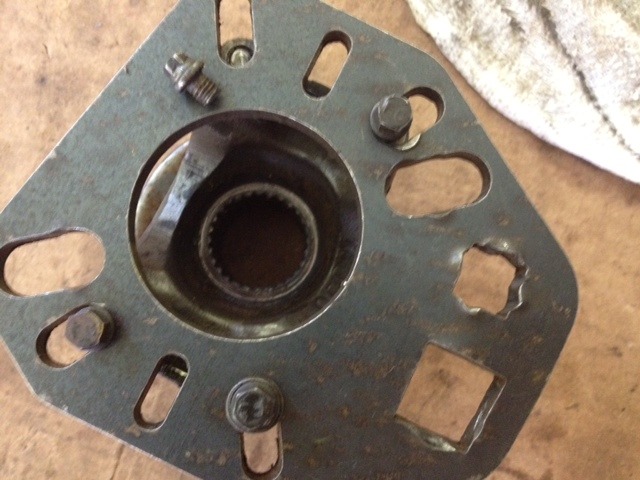

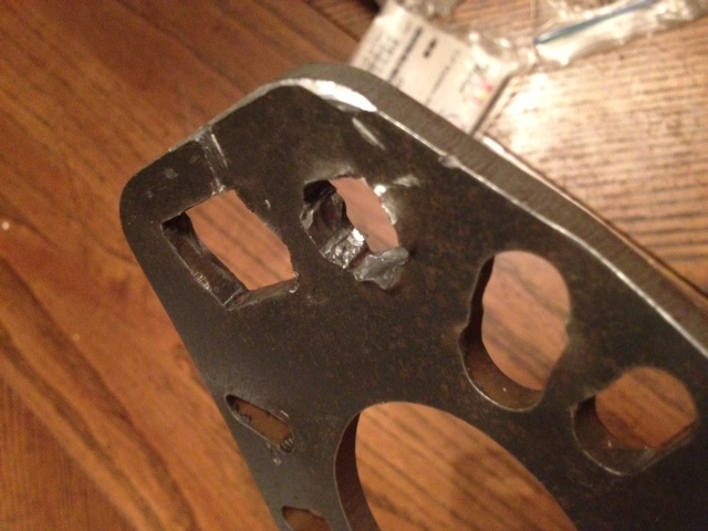

Well crap! As I was smashing down crush sleeve number three (I'm getting good, got the torque at exactly 20 in-lbs), I sheered off one of the bolts that goes into the yoke. Looks like it's time to upgrade from my strap and bolt yoke to a u-bolt style yoke.
http://www.jeeptech.com/axle/aub.html
The ting about working on these older cars is you always end up breaking more stuff than you fix. At least at first...

EXACTLY WHY YOU SHOULD HAVE 'EM MAKE YOU A HOLDING TOOL AT THE HIGH SCHOOL MACHINE SHOP OR TECH SCHOOL MACHINE SHOP
DOWN AT THE WELDING SHOP--A PLASMA WIZARD MIGHT WHIP YOU ONE OUT WITH THE PLASMA CUTTER IN A FEW SECONDS---I DO SUGGEST YOU MAKE THE HANDLE AT LEAST 4 FEET LONG.... MINE IS TOO SHORT AND I HAVE BEEN CONTEMPLATING A "2 BOLT-ON" EXTENSION

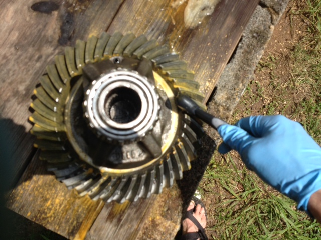

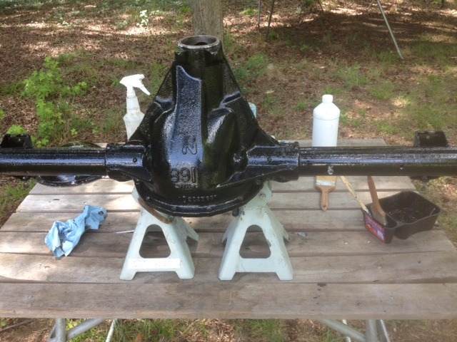

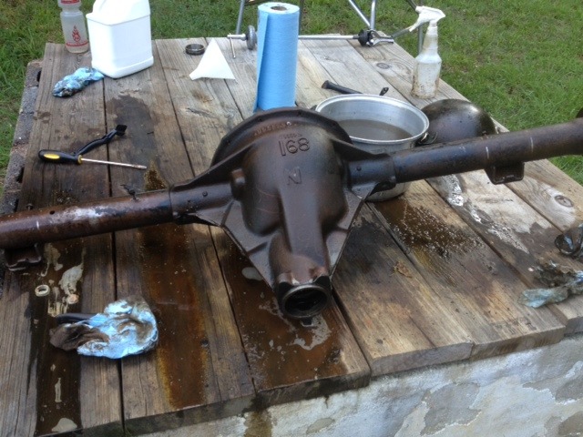

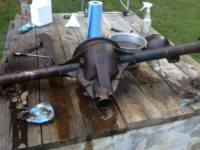

Here's a little photo update. Show's the cleaning and painting of the axle housing. The Por-15 rust preventative system works great. The cleaner is water soluble which means you can dilute it. That stuff burns though, so gloves are a must. The prep and ready will etch the rust, so you don't need a sand blaster. Takes a few days for the paint to harden, but once it does, it's rock solid. Looks pretty sleek too. Finally got around to buying a new CJ-7 emblem plate. Can finally show off her name.

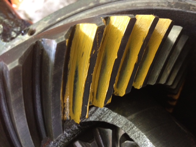

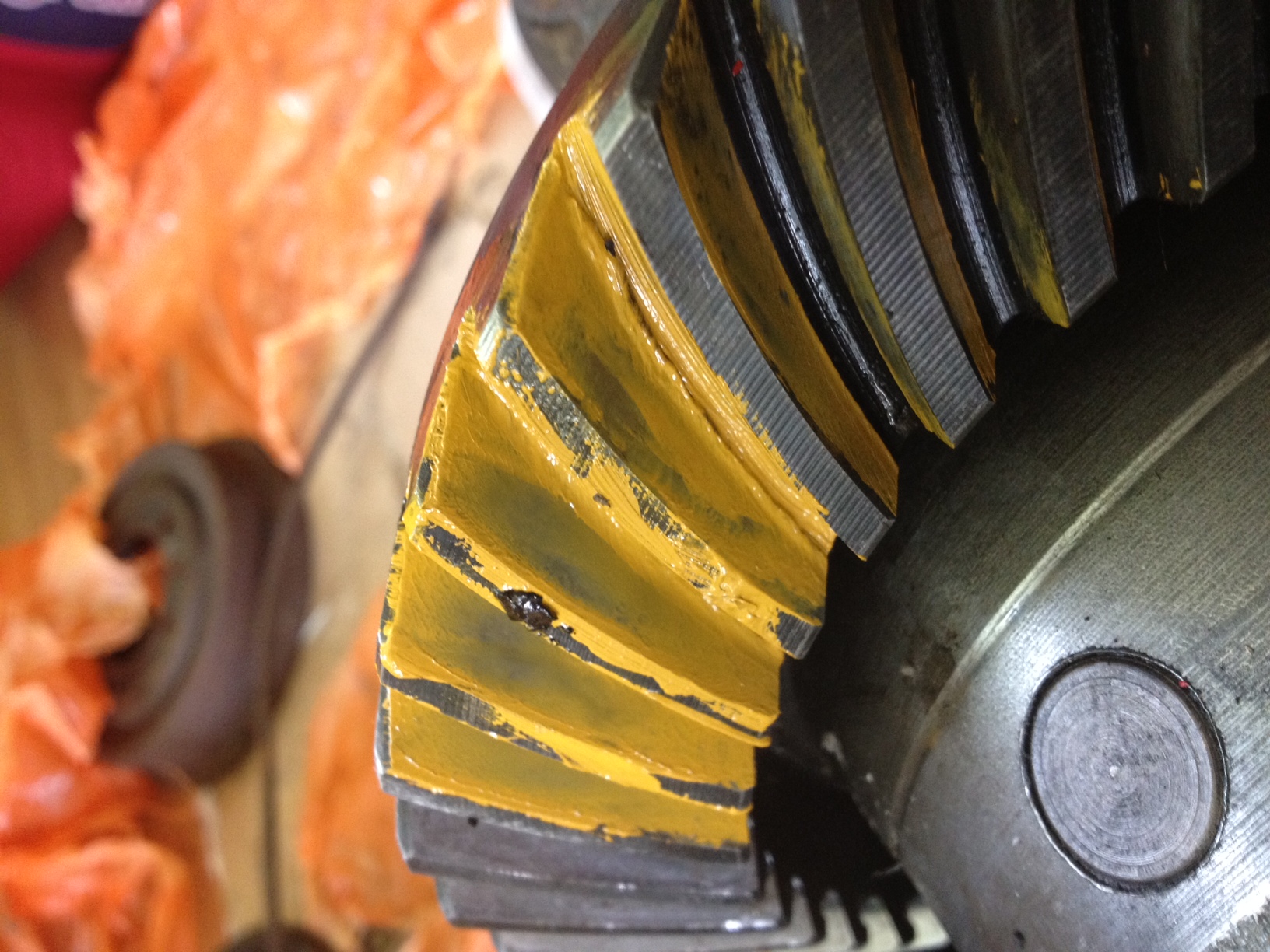

The latest round of gear set up shows the drive side close to the root and close to the toe. Coast side is close to root and close to heel, which means I need less pinion shims and a couple more crush sleeves. At least two more, one for the final set up and one more to check the pattern. I'll probably buy four.
Pics showing where the bolt sheered off too. The bolt that sheered was a replacement Johnny-preowner installed. It's smaller than the other three so no wonder it broke off. That yoke holder works real well though. It's got slots for a 3/4'' and 1/2'' drives, so either my 2 ft or 4 ft breaker bar will fit. That 4 ft bar is a must for crushing sleeves. Takes all of my body weight on it to get it to turn a couple of degrees.

YOUR BROKEN BOLT MAY NOT HAVE ANY THREAD PRESSURE ON IT----A DREMEL TOOL AND A CUTOFF DISC MAY POSSIBLY CUT YOU A SCREWDRIVER SLOT IN IT SO YOU CAN SCREW IT OUT-----IN REALLY TIGHT SPOTS, I HAVE CHEWED THE CUTOFF DISC DOWN REALLY SMALL, BY GRINDING ON SOMETHING ELSE 1ST---THEN CUT THE SLOT

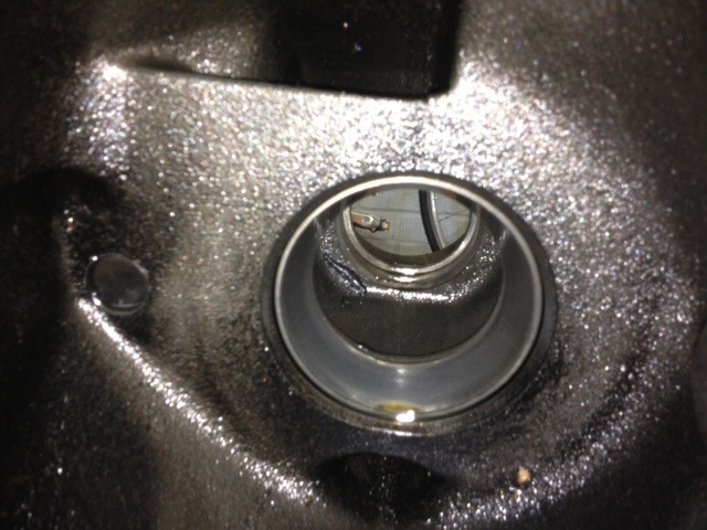

Good news! I've got the correct shims (to the best of my knowledge). Pictures bellow show the final gear marks, dead center. Or...close enough. And a pic of the pile of used crush sleeves it took to get me there. As soon as my new yoke and crush sleeve comes in I'll be ready to tighten things down for the last time. Thank goodness. I can see the light at the end of the tunnel.
Last pic is of the liquid check valve's brand new barbed hose fitting. Your method worked like a charm.

WEAR PATTERN IS PERFECT!

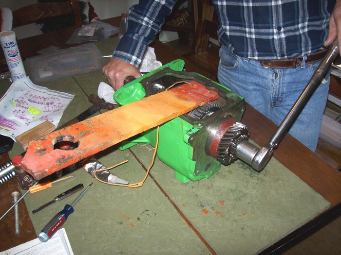

Question. I was going to fill up the transfer case with fresh oil, but as I was tightening the drain plug, it just kept going and going. There was a very small pop at one point (maybe 15 ft-lbs of torque on the plug at the time), and some old RTV gasket sealer came out of the threads, but that was it. Eventually when it started to become easier to tighten, I didn't just keep turning and push it through. I pulled it out and there wasn't any damage to the threads. A little extra oil came leaking out when I pulled out the plug.
I tried putting it in gain, and it gets a little hard to tighten, but definitely doesn't make it up to 20 ft-lbs (which is the torque spec for the drain plug). Is this normal? Do I just put some RTV on the threads, and tighten her up? Or is there a piece of metal potentially clinking around inside of my t-case? And yes, I was using a torque wrench.

RVT IS FINE
WHAT ABOUT TRYING ANOTHER PLUG?
I'M NOT SURE WHAT STYLE YOU HAVE--YOU MIGHT HAVE A "FEMALE SQUARE" THAT YOUR RATCHET FITS IN, YOU MIGHT HAVE A FEMALE TORX, YOU MIGHT HAVE A "MALE SQUARE HEAD" THAT A WRENCH OR 8 POINT SOCKET FITS ON------AND THERE MAY BE A MAGNET INCORPORATED INTO IT
I HAVE A MODEL 20 TRANSFER CASE AND A T-150 3 SPD TRANNY
MY TRANSFER CASE HAD THE "RATCHET SQUARE PLUGS" AND NO MAGNET---I REPLACED THE DRAIN AND THE FILL WITH 1/2" NPT (PIPE TAPERED THREAD)....TECHNICALLY "NATIONAL PIPE THREAD"----WITH HEX HEADED BRASS TAPERED PLUGS. THEY SEEM EZer TO REMOVE
THE TRANSMISSION DRAIN HAS A MAGNET MADE INTO THE PLUG, IT IS THE "MALE SQUARE HEAD", THE FILL IS THE SAME WITHOUT A MAGNET...I LEFT THEM BOTH ALONE...SEE 1ST PIC
YOU DON'T THINK YOU (LAST FELLER) HAS CRACKED YOUR CASE ACROSS THE HOLE FROM OVER TIGHTENING? CLEAN THE IMMEDIATE AREA WELL WITH A WIRE BRUSH, THEN RUB YOUR CRUDDY FINGER ALL AROUND THE HOLE AND SEE IF YOU EXPOSE A CRACK WITH THE CRUD
YOU CAN ALSO "TAP" THE HOLE AGAIN TO CLEAN IT UP----THIS IS USING A TAPERED TAP (NPT)---YOU MUST STOP WHEN IT GETS A LITTLE TOUGH TO TURN--IF YOU START CUTTING INTO THE THREADS, YOU BETTER STOP!......FAILURE TO STOP WILL RESULT IN A STRAIGHT THREADED HOLE IN WHICH A BOLT WILL GO THRU, A PLUG WOULD BE USELESS!!!

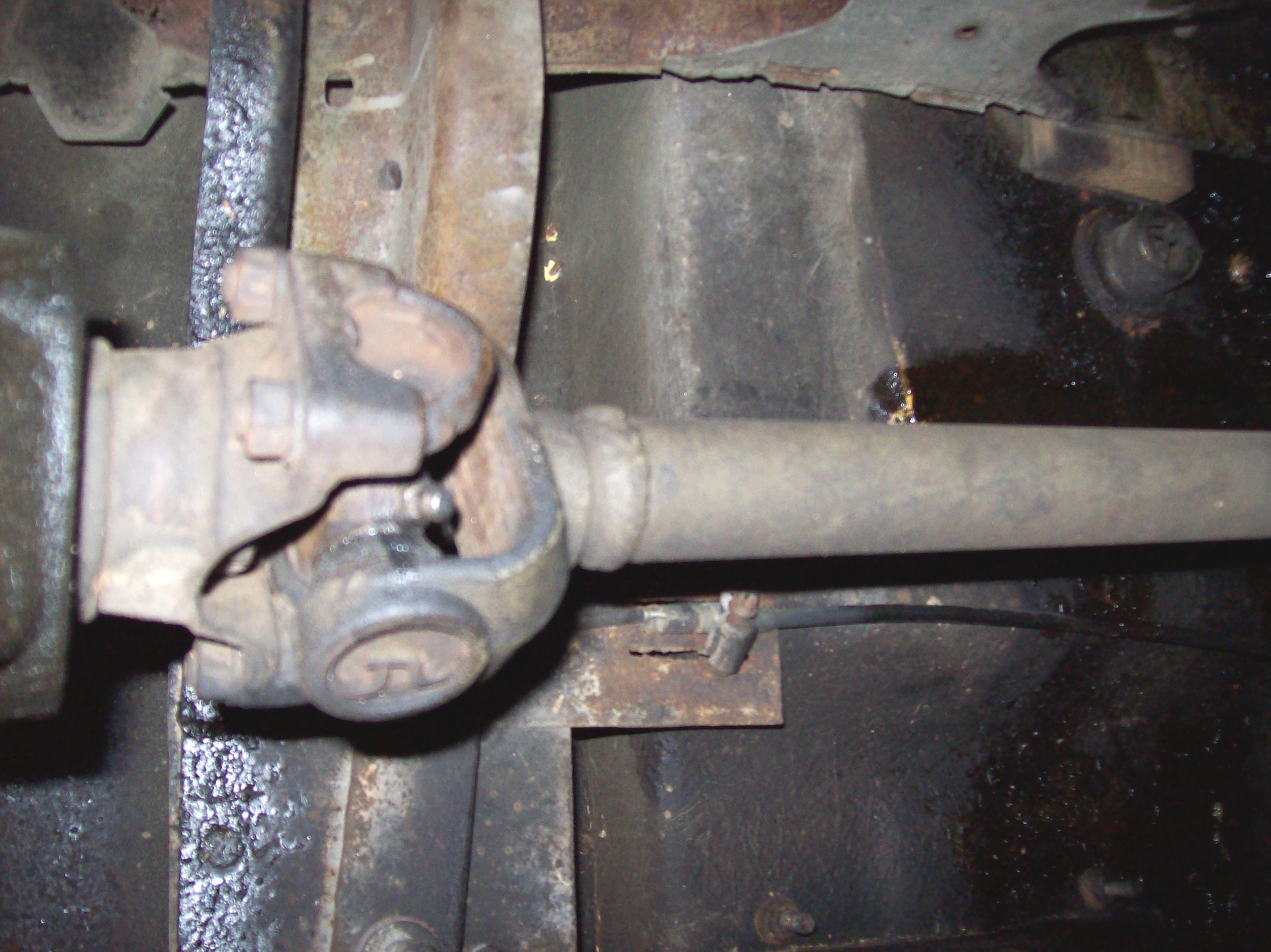

Another question. How important is it to realign your drive shaft at it's original point relative to the rear differential? I may have mucked up my markings when I was pushing out the u-joint yesterday....
Aug 5, 2012 at 1:39 PM
CJ MEDEVAC
  • 11,004 POSTS
I DO DO TRY TO REALIGN MY STUFF LIKE IT WAS
BUT WHO KNOWS WHAT HAPPENED BEFORE ME?
I'VE BEEN AROUND MANY THAT DID NOT TRY THIS PRACTICE....I'VE NOT SEEN ANY VIBRATION ISSUES ON THEIRS.
MAYBE IT JUST REALLY MATTERS A LOT WITH A LONG DRIVE SHAFT ON OTHER RIGS
WHAT DO DO YOU DO WHEN YOU INSTALL A BRAND NEW ONE??????
REMEMBER I DON'T DRIVE TRAINS (NOT AN ENGINEER)!!!
