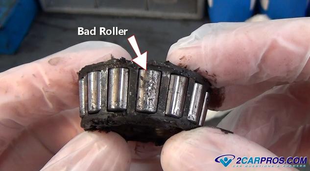

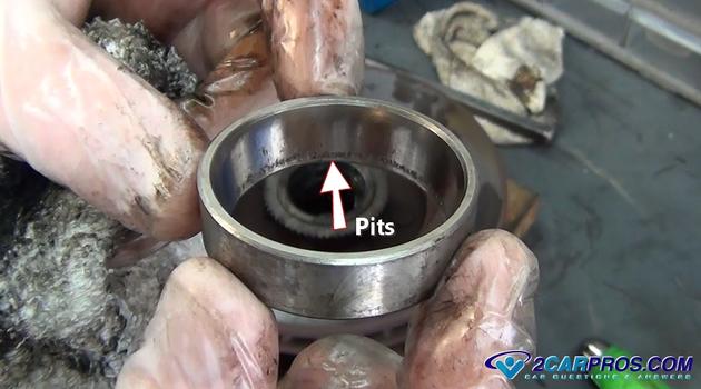

Why Does a Front Axle Bearing Fail?
A bearing is made of high grade steel which has a super hard coating over the rollers, inner and outer races. A bearing goes bad when this coating is worn away due to mileage or extreme load which just leaves the normal steel which then degrades and destroys the bearing components. Also, failures can occur when moisture combined with salt from roads penetrate the seal and contaminate the bearing, or over time the grease used to lubricate the bearing can liquefy leaving it dry causing a failure. This is what a failed axle bearing looks like. You can see the roller cage is broken and there are pits on parts of the rollers themselves. Parts of metal get caught up in-between the rollers and the upper and lower bearing race while under high pressure. This creates a grinding action which can be felt while driving the vehicle. These bearings are used in the front hubs and rear axles of all vehicles. Some CV axle bearings are actually two sets of ball bearings put together but fail the same way. Here is a close up of the bad bearing roller.
bad bearing roller

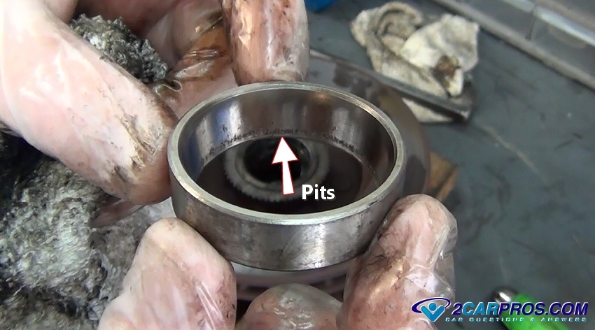

This is what happens to the bearing race once the bearing goes bad. Here is an example of what happens when the metal particles from the bad roller is pressed against the race under high pressure.
bad bearing race

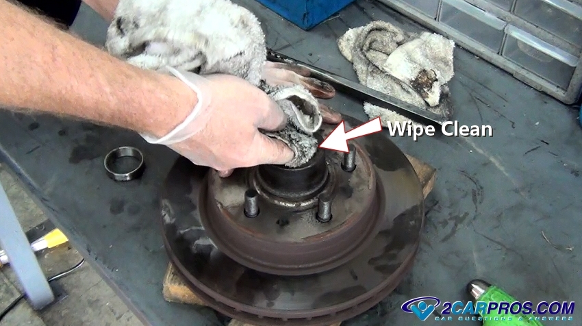

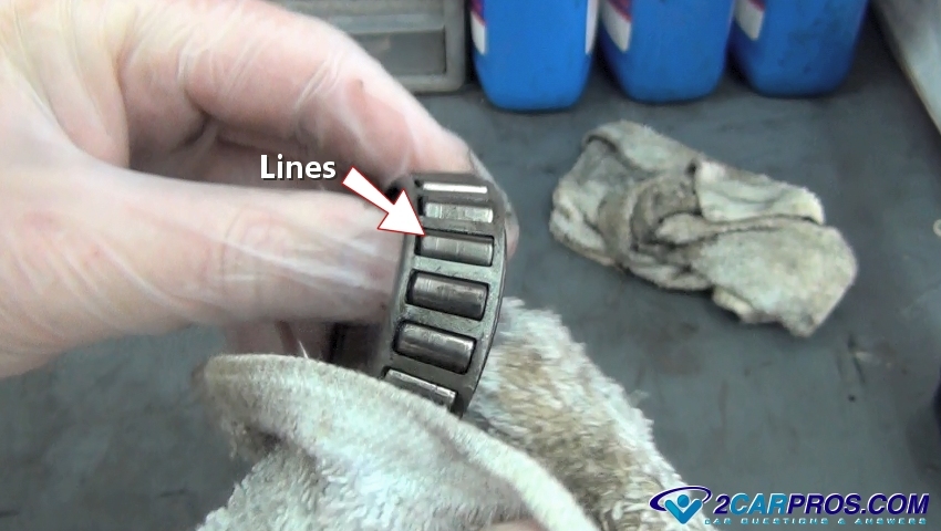

Use a shop towel to wipe the bearings and races clean. Look for a metallic pieces in the towel after cleaning which is an indication for a bad bearing even if you cant see it on any of the rollers. Also lines can be present on the rollers as well. This is a sign of normal wear and may not be an indication of failure.
cleaned axle bearing

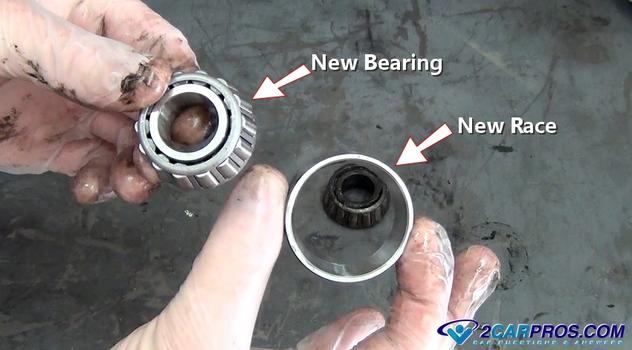

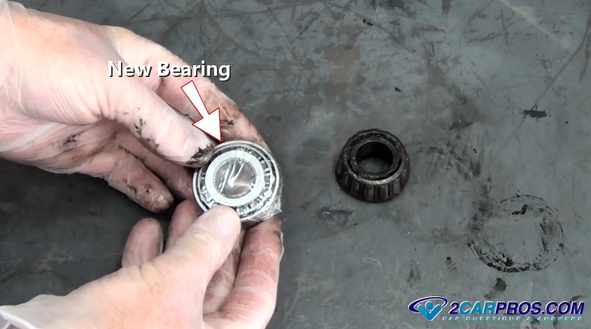

Remove the new bearing from the box. Smaller bearings have their races supplies with the replacement unit while larger bearings must have the races purchased separately. The bearing below has the race included.
new outer axle bearing
These bearings are matched to the race they are supplied with. Use extra care to not mix them up if you are replacing more than one bearing at a time. Match the old bearings to the new bearings to make sure the inner and outer diameters are the same.
new axle bearing and race

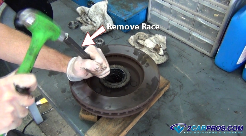

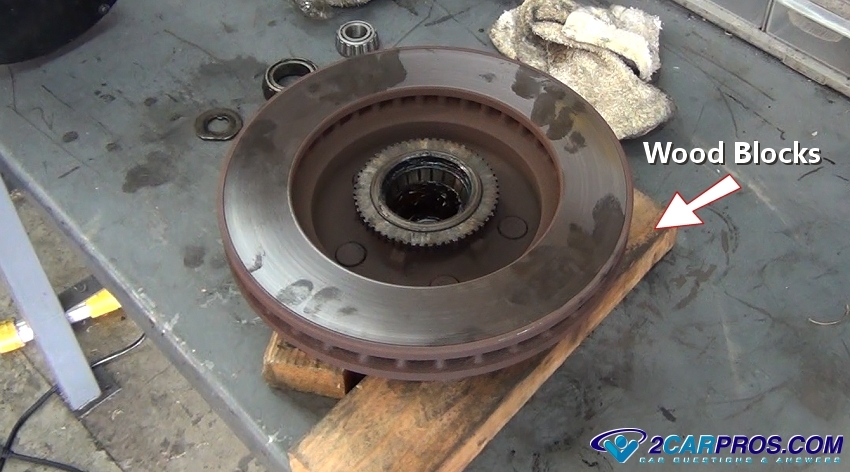

Use wood blocks to prop the rotor hub up from the table or ground to allow clearance for the bearing race to be removed.
wood blocks
Using a large punch with a freshly ground tip that is flat, locate the outer race lip which will stick out inside the rotor hub. Place the punch against the race lip to drive it outward while working around the race in a circular motion. Continue until the race falls from the bottom of the hub.
remove outer bearing race

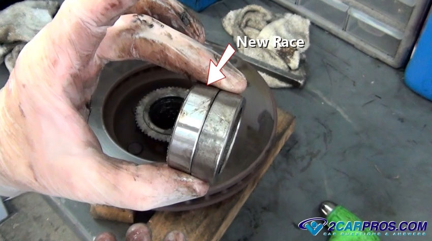

Install New Bearing Race
Match the new race to the old unit they should match identically in inner and outer diameters.
new bearing race
Turn the rotor hub over and use a shop towel to wiper the race mounting surface clean from grease. You don't want grease to be between the race and the hub surface because it will lubricate the race which is a press fit. This will cause the race to become lose and ruin the rotor.
wipe bearing hub clean
Set the new bearing race cone facing outward squarely into the rotor hub. Next, position the old bearing race on top off the new race. Use a hammer to install the new race into the hub. Once the old race gets close to the bearing hub stop the installation so the old race doesn't get stuck.
install new outer bearing race
Complete the race installation by used the large punch. A race driver can also be used for this as well. The hammer will create a distinct hardened noise once the race is completely in place as the race sits against the hub shoulder.
complete outer race installation
