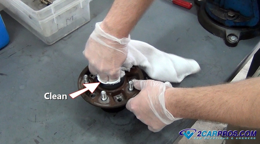

2. Use a shop towel and remove the grease from inside the bearing hub, (rotor removed).
clean bearing grease from hub

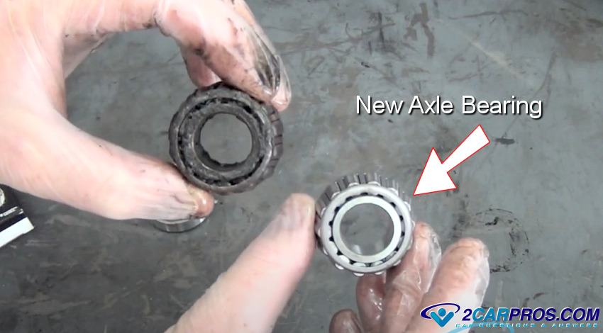

3. Next, layout the inner and outer wheel bearings, grease seals, spindle retainer and washer for cleaning.
axle bearings seal washer
4. Clean each part using a shop towel expect for new bearings. The old grease inside the inner and outer bearings will be forced out in the next step.
clean axle bearings
5. Re-align the cleaned components to be installed in the order ready for reassembly.
cleaned bearings seal
