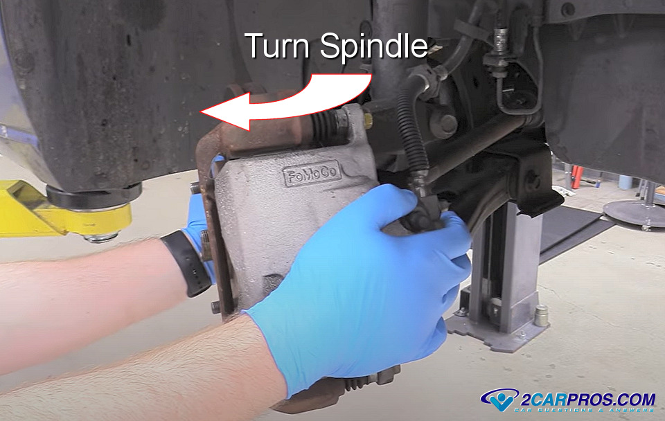

1. Once the car is safely lifted and the tires removed, unlock the steering system so you can move the steering wheel, then grasp the caliper and turn it to more easily access the caliper mounting bolts, (Or simply turn the steering wheel).

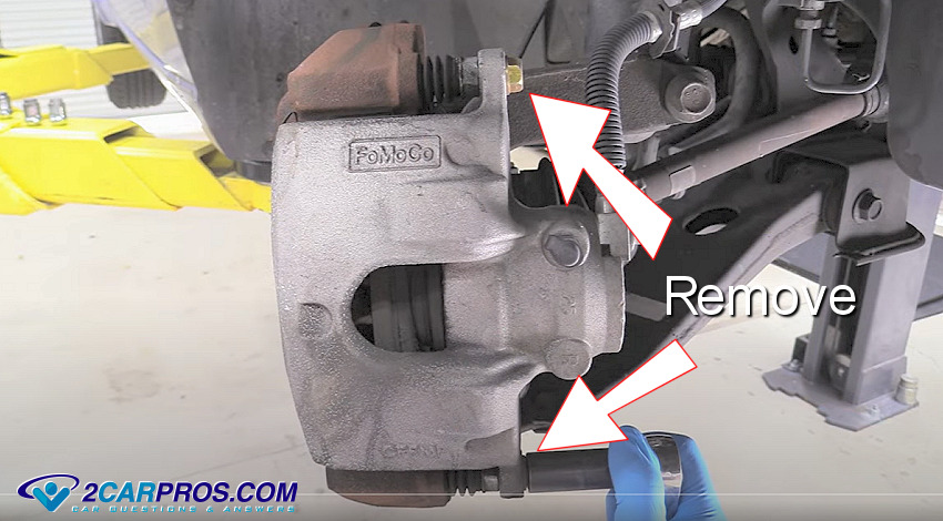

2. Locate the brake caliper mounting bolts and remove them, these can be tight so use a quality tool, the bolts in this example are 13mm, but yours can be 14mm, 15mm, 18mm, or 10mm hex drive, or a 35 torx bit in most cases, (Some bolts are held in with a thread locker like Lock-Tight). You might need an additional wrench to hold the caliper slide from turning but this is not typical. Some Volkswagen's use their own special 12mm or 14mm ten point torx, you must have this special tool to do the job.

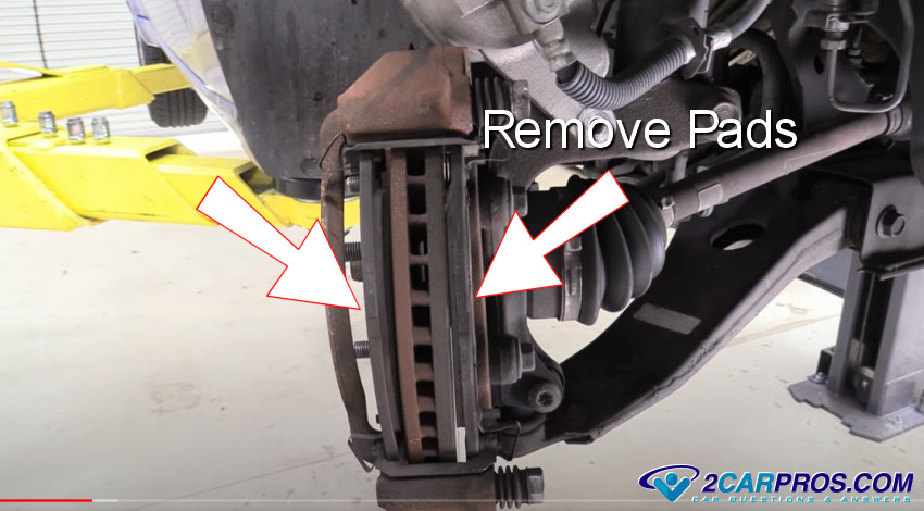

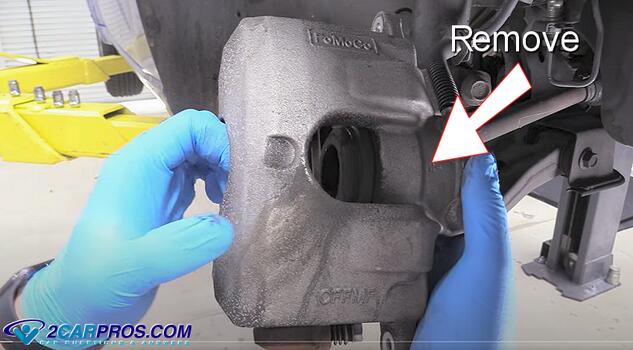

3. Gasp the brake caliper and wiggle it back and fourth, you can also insert a large standard screwdriver as a wedge to help loosen the grip the caliper has on the brake pads. Lift upwards to remove the caliper from the brake pads and caliper mounting bracket, (Do not allow the caliper to hang by the brake hose, zip ties work well for this).
remove automotive front brake caliper

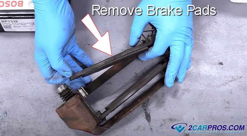

4. This will expose the front brake pads inside the bracket carriage, grasp the brake pads and remove them, you can use a standard screw driver and wedge it between the pads and the rotor to aid in the removal, at this point you can install new brake pads and put the brakes back together, but the braking power and operation will not be optimal, (It is recommended to replace the brake rotor as well.)

5. We have removed the brake caliper mount, (which will need to be done in most cases when replacing the brake rotor) to show you more precisely how to install the new brake pads. Release both brake pads from the bracket.

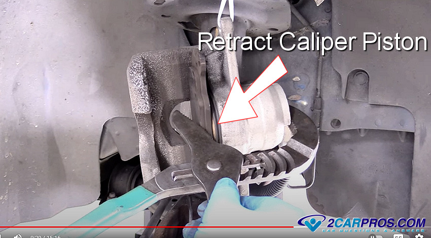

9. Before the brake caliper can be installed it must be reset (retracted), this can be done with a "C" clamp or a large pair of channel locks as shown. This is a good reason to not remove the opposite side caliper because the piston may pop out of the opposing caliper, which will take the fun out of the brake job. (Note: Brake fluid may overflow from the brake master cylinder reservoir which is normal.)
retract front automotive brake caliper piston

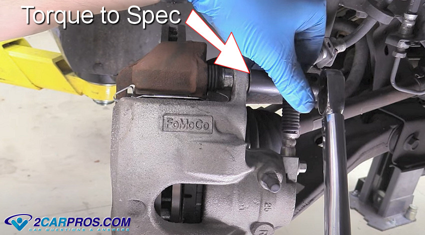

11. Reinstall the brake caliper mounting bolts and apply thread locker if required, tighten the bolts and torque them to factory specification, in this case it was 21 foot pounds. One arm tight will be good in most cases if you don't have the spec's, now you can duplicate the brake job on the opposing side and  reinstall the wheels and lower the car, DO NOT DRIVE.
