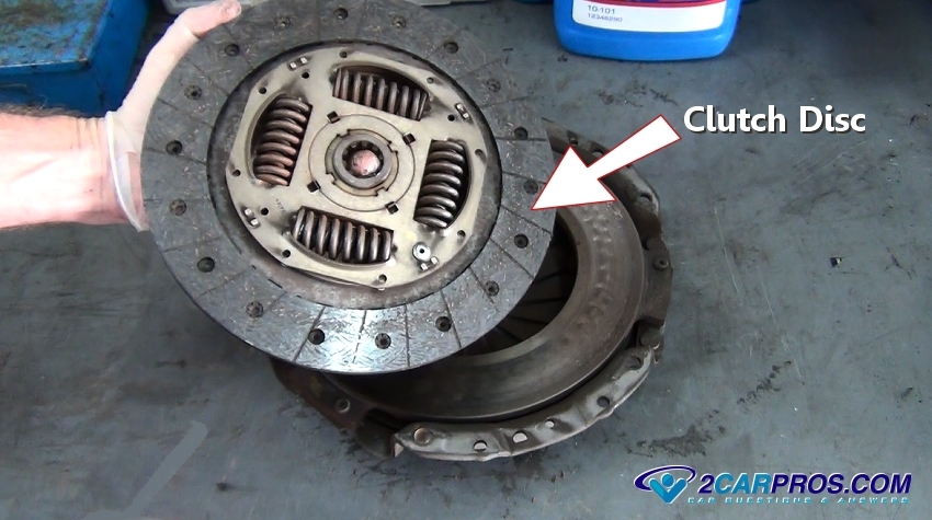

1. Clutch Disc: The clutch disc is fitted between the flywheel, and the pressure plate, which is lined with a metallic/asbestos material much like a brake pad. This lining eventually wears out and the clutch starts to slip, this is why the clutch is normal wear item. When a vehicle is in gear but stopped, the flywheel and pressure plate rotate at engine speed while the clutch disc is not spinning, allowing you to shift gears without grinding. Here is what a typical clutch disc looks like:

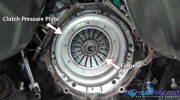

2. Clutch Pressure Plate: Is the other main part of the clutch assembly, which is bolted to the engine flywheel and holds pressure against the clutch disc (engaged) which in-turn transfers engine power to the transmission's input shaft, this is the part where the throwout or release bearing rides on.
automotive standard transmission clutch pressure plate

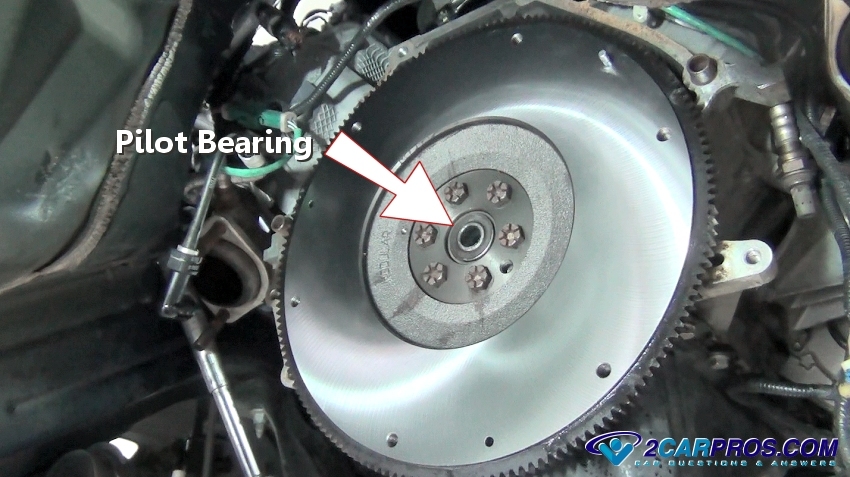

3. Pilot Bearing: This bearing is uses to support the opposite end of the standard transmission input shaft and is located in the center of the engine flywheel, which is typically used on rear wheel drive cars only.

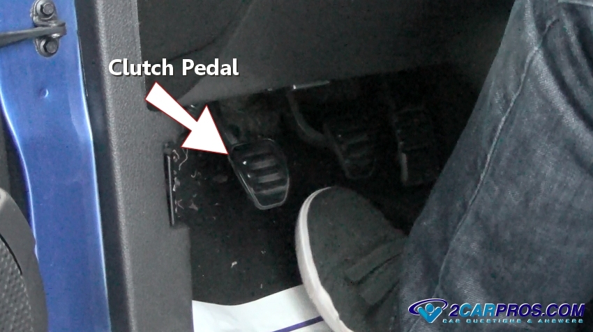

1. Clutch Master Cylinder: The clutch pedal is connected to a clutch master cylinder, which produces hydraulic pressure when the pedal is pushed downward. Much like a brake master cylinder, it uses brake fluid to operate and will have a fluid reservoir under the hood. A small hydraulic line runs from the clutch master to the secondary cylinder.

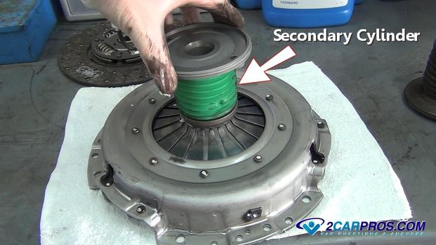

2. Clutch Secondary Cylinder The secondary cylinder can be located in two different positions near the front of the transmission, either it will bolt to the outer part of the transmission bell housing and use a clutch fork to operated the throwout bearing, or it will be integrated into throwout bearing which is mounted to the transmission input shaft bearing retainer, (more popular).

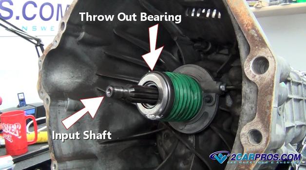

3. Throwout Bearing: This bearing is used to ride against the pressure plate fingers and actuate the clutch assembly. When the secondary cylinder is actuated, it forces the throwout bearing against the pressure plate fingers pushing them inward which releases the clutch disc.

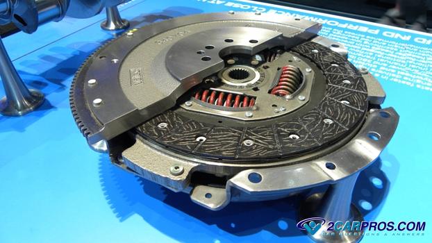

This is a picture of a cutaway so you can see what the clutch assembly looks like all together.

Here is what the throwout bearing position looks like inside the transmission bell housing.
